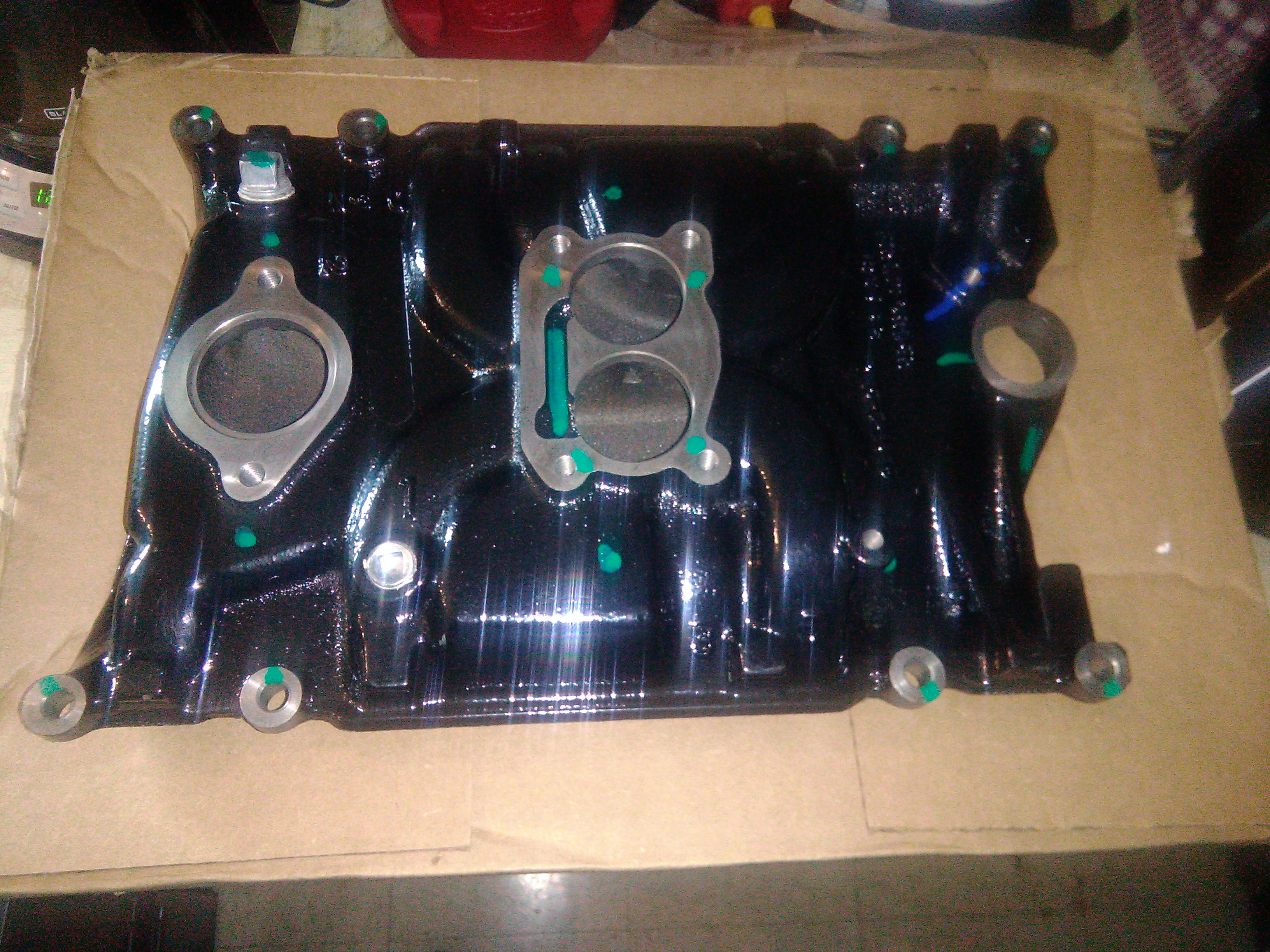

After a long break and shoveling way too much money down the Jeep hole, I am finally ready to get back to the Bonneville. I just ordered a 2 barrel marine intake and a Rochester 2GC carburetor off of ebay. I would have liked to got back to this sooner, but other projects made that garage space too valuble.
The intake manifold arrived. That thing is HEAVY.
It weighs almost as much as a cylinder head.
Cheaper mainly. This cost about $95 less than the cheapest aluminum intake that I could find. There isn't really any other advantage to going to the aluminum other than the weight, and 10-15lbs is not worth the price difference to me in this application.
Why a marine intake? Lack of emissions I'm gathering but the question stands.
Not worried about emissions either way, but it was just plain cheaper than the Edelbrock one.
