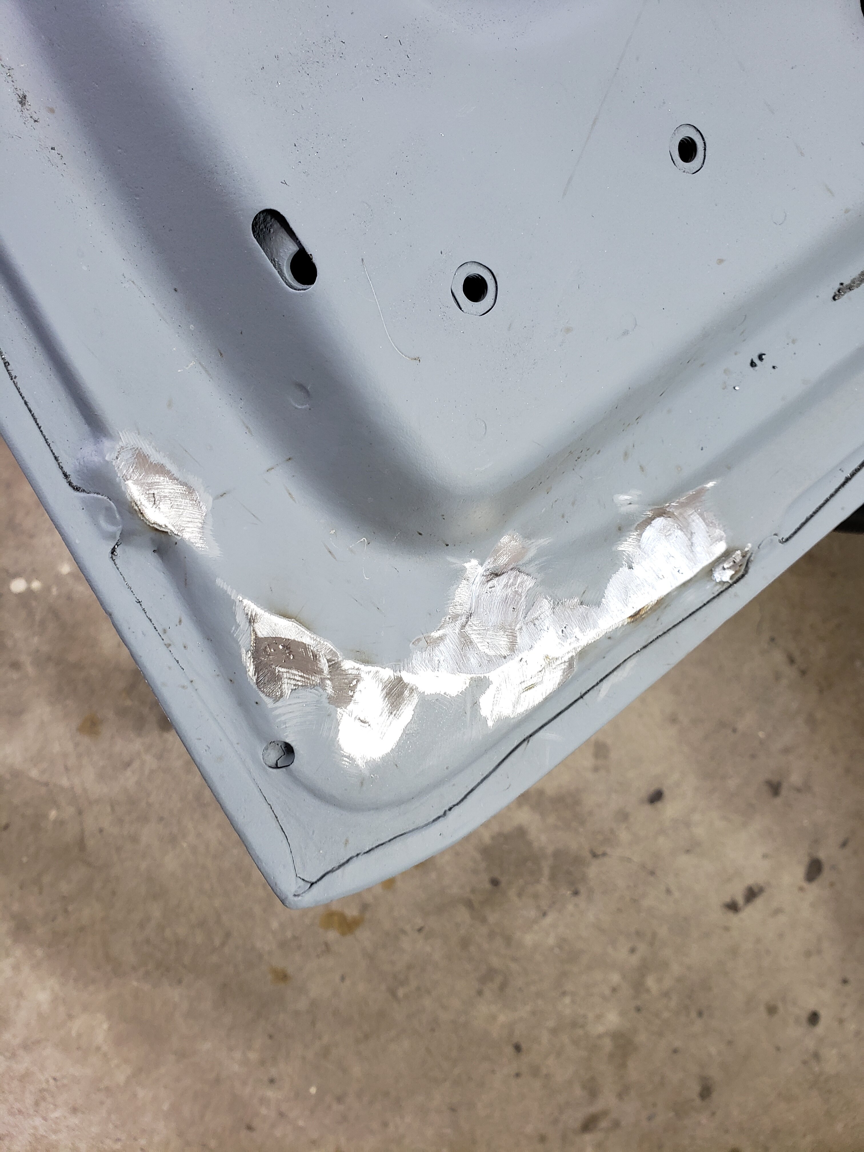

Small update but I welded up the pinholes in the decklid today. I was able to turn the heat all the way down and fine tune the wire speed. Once I got some metal built up I was able to fill them in. Still gonna need a skim coat of filler.

Nice! May not even need the filler by itself, just a couple of heavy coats of primer/filler and some sanding.
