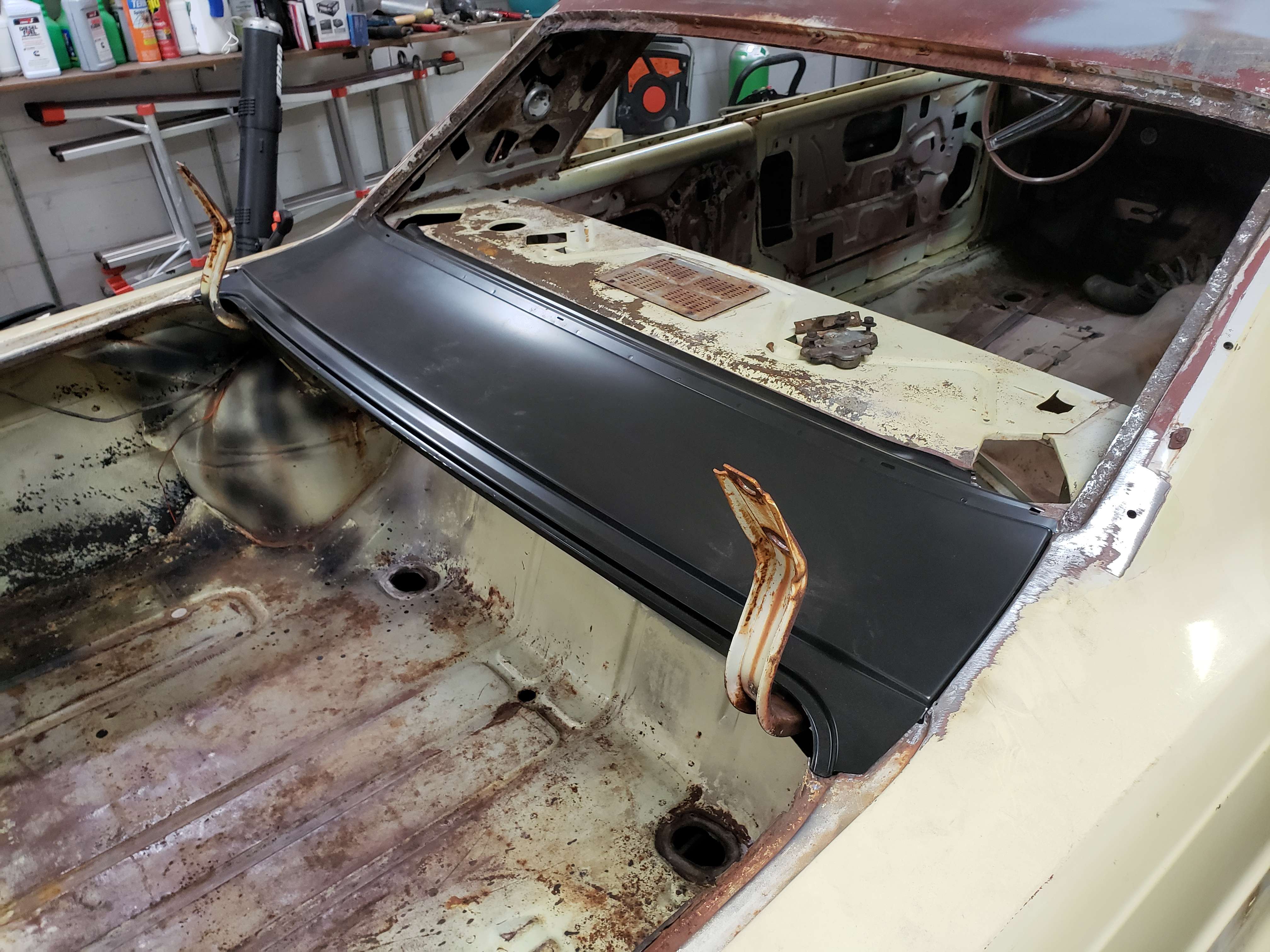

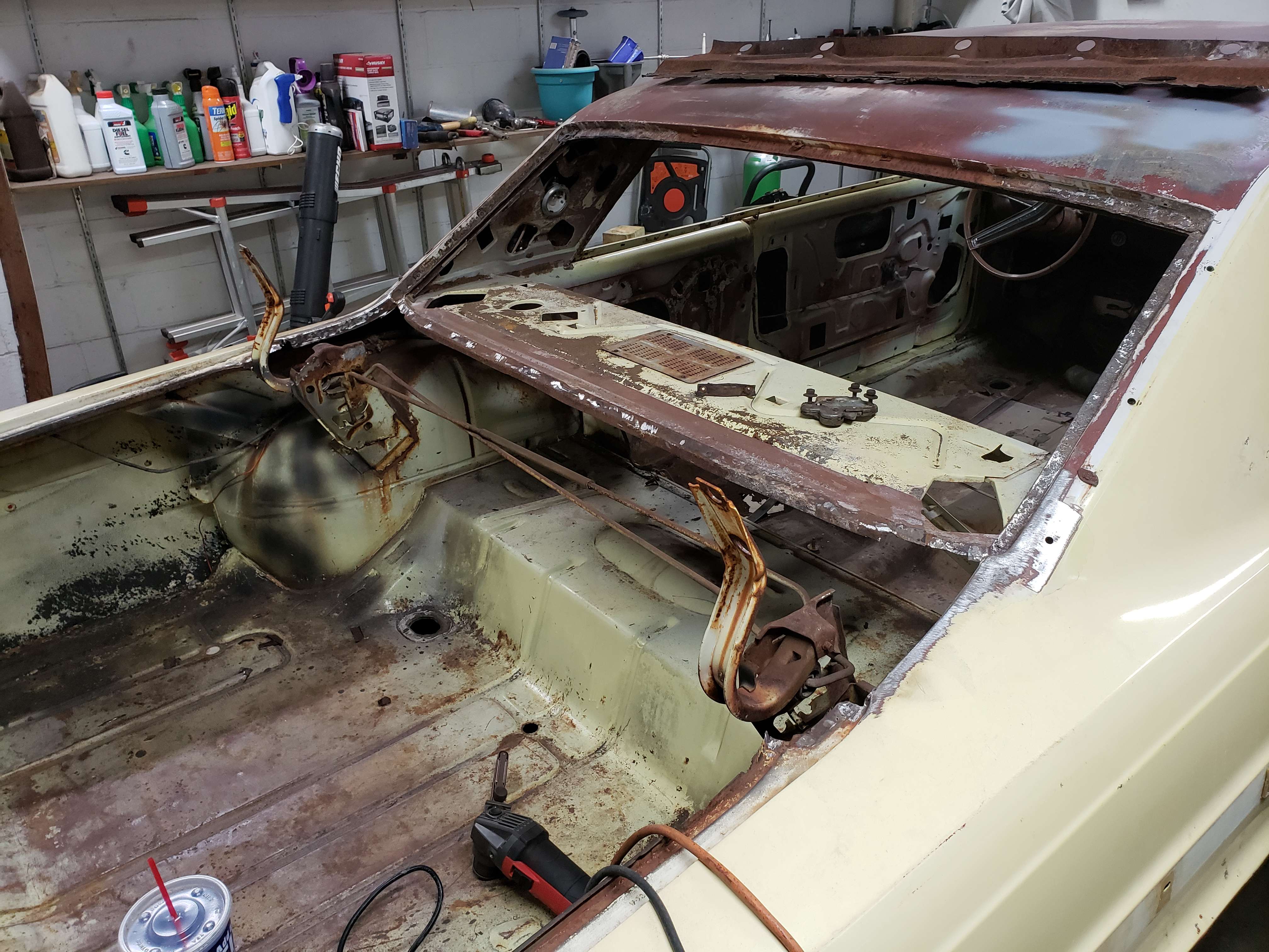

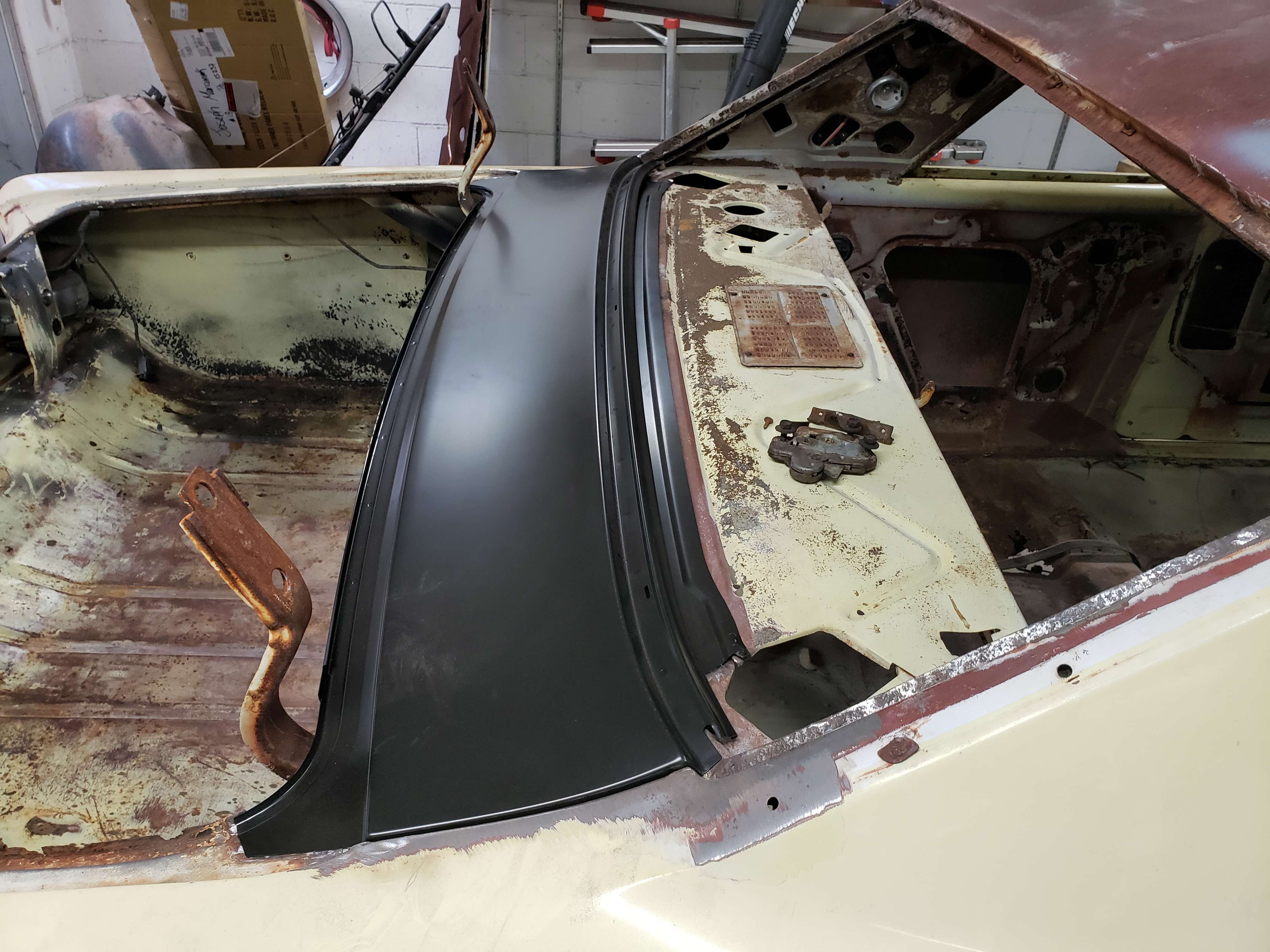

The correct rear window panel arrived yesterday. I spent some time today getting it roughly mocked into place. I still need to cut the edge inside the package tray where it will get butt welded which will allow it to drop down and sit flush with the quarters. Otherwise it's mocked into place and looks good.
Not quite sure how I'm gonna get my 6'3" 280 pound *ss inside the trunk to weld the flanges but I'm sure I'll figure something out.
View attachment 218670View attachment 218671View attachment 218672
View attachment 218673View attachment 218674

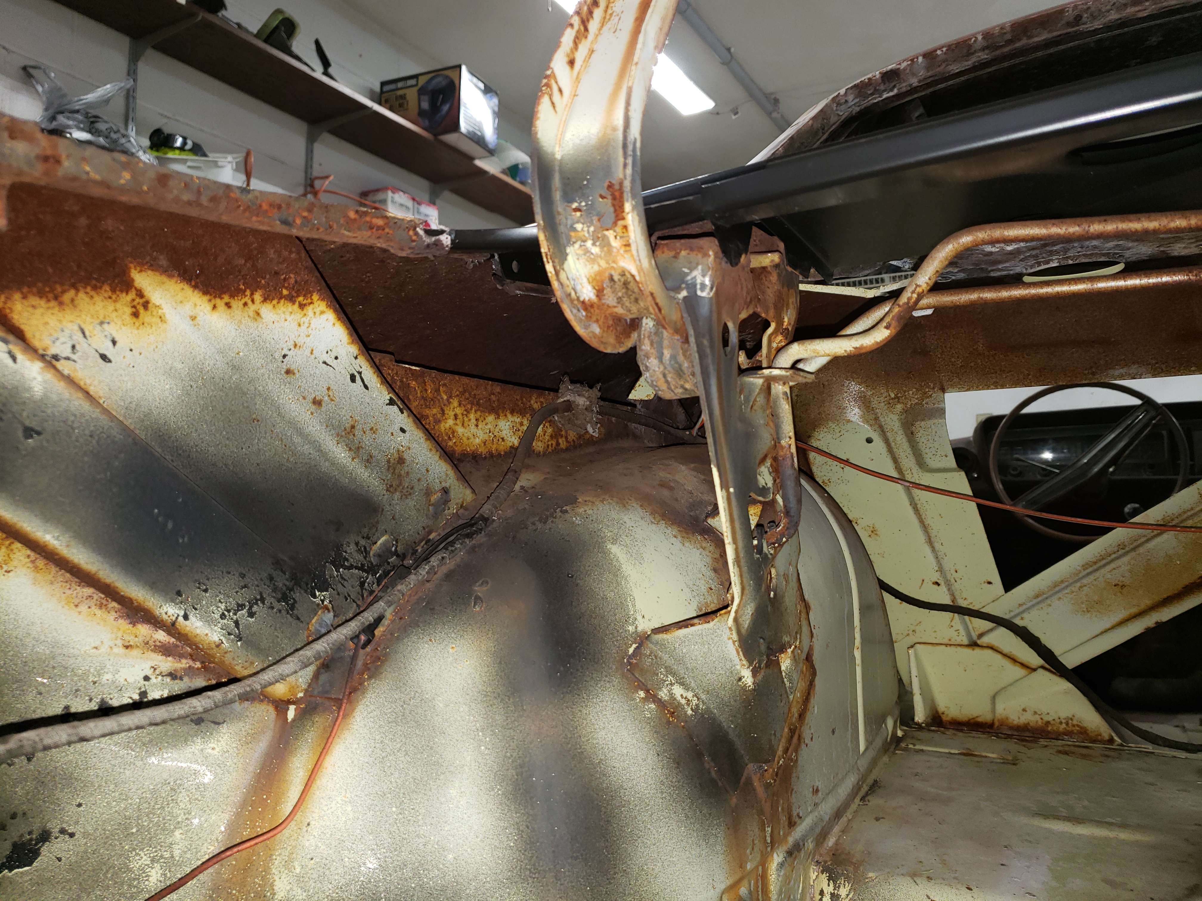

Seeing both pic 4 and pic 5, this might be the perfect time to go after the surface rust on those brackets and those upper wheel well curves. For values of the term, they are about as much out in the open as they will ever be so slathering a coat or two of Ospho or RustMort or Concrete Etch on them, neutralizing it as specified, and then throwing some epoxy primer or ??? at the surfaces afterwards would go a long way towards future peace of mind once you get that panel fitted in and secured.
