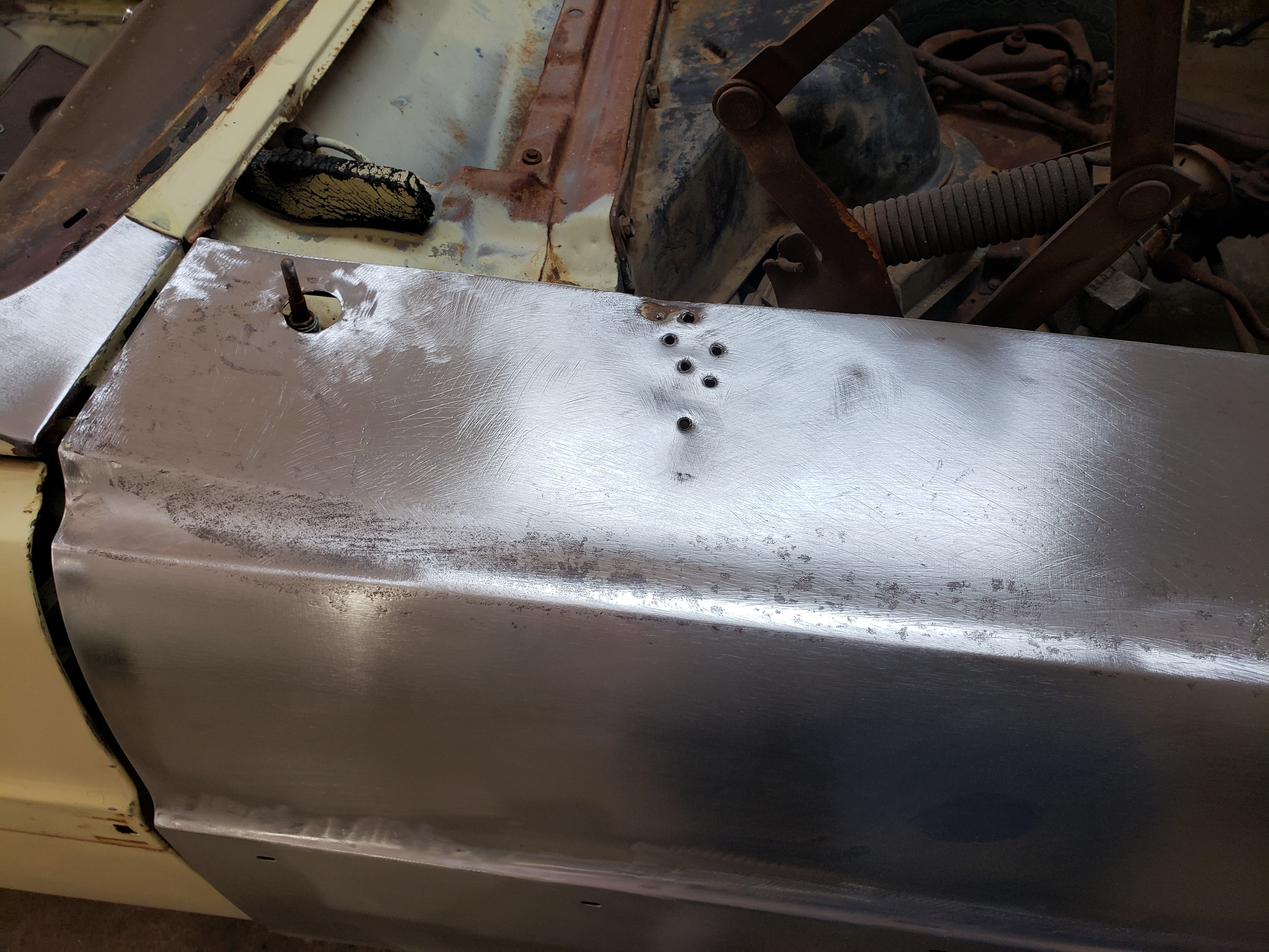

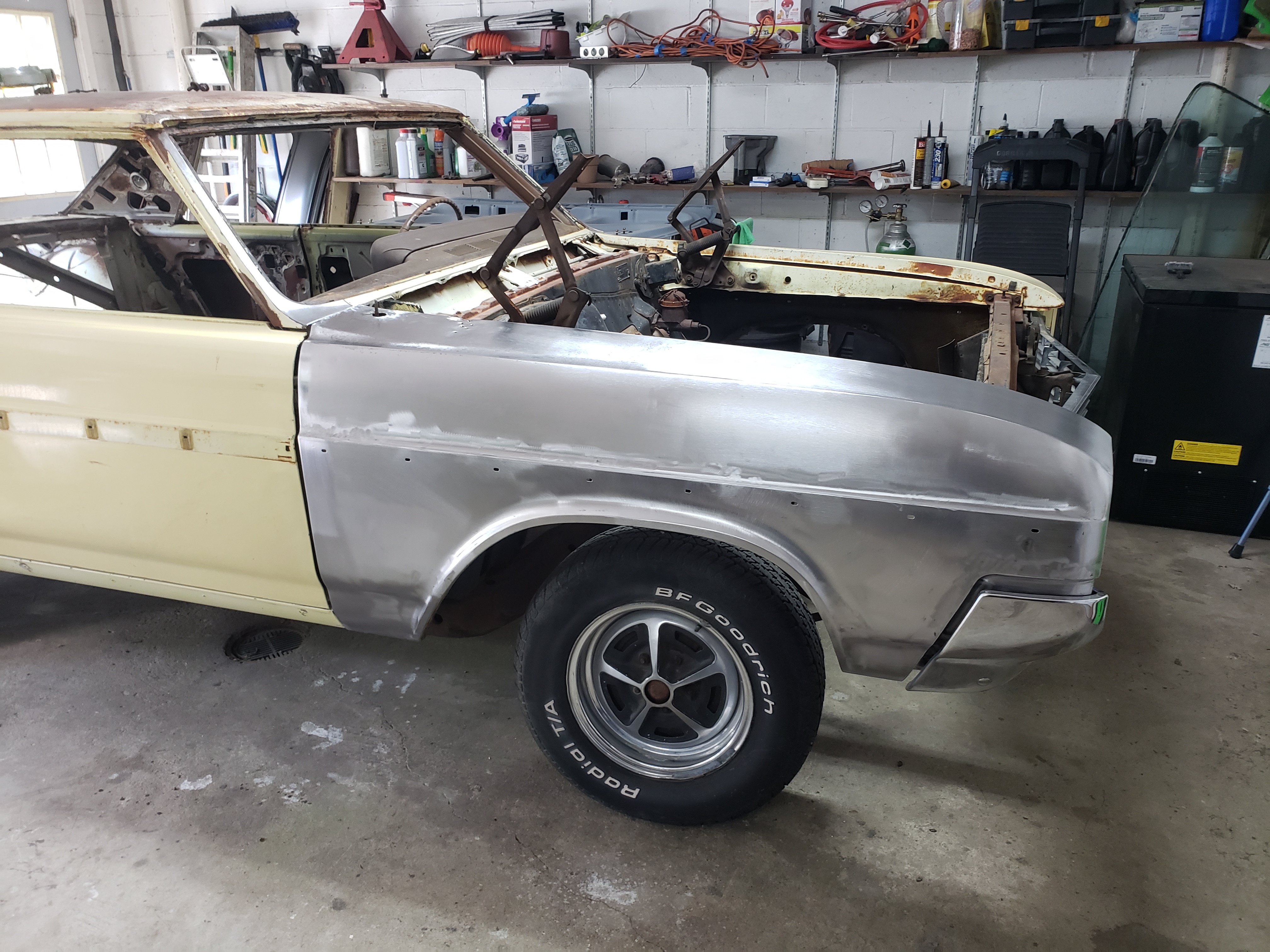

Outside of the front fender is stripped. I've got it unbolted and just sitting in place. The SCT works very well.

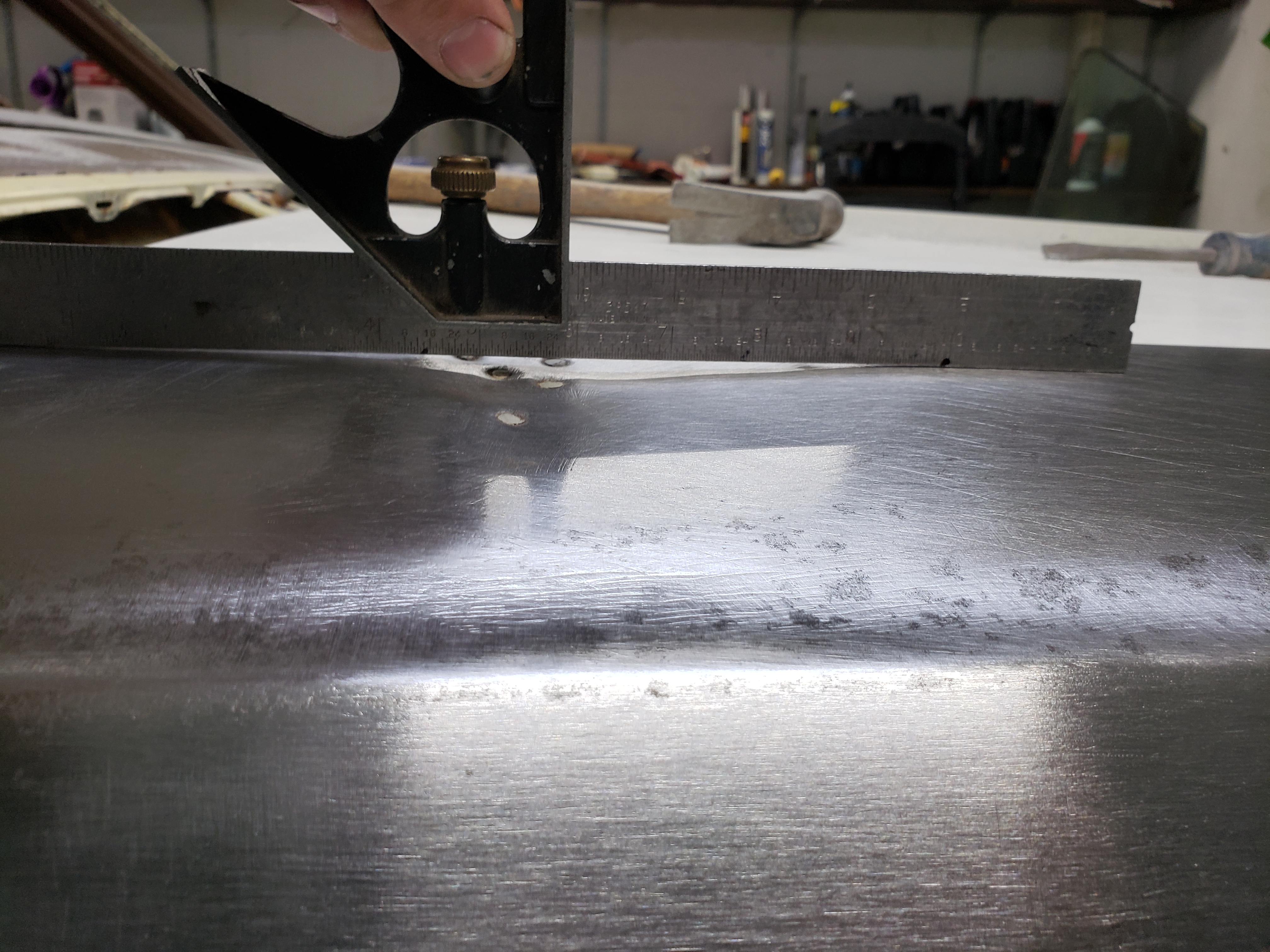

Here's what the ugly body work underneath the cracked body filler looks like.
I also tacked up a couple more pinholes in the underside of the decklid. Need to grind them down yet and skim some filler over them. I'm hoping to spray primer on the decklid and fender at the same time.
Whot happened? Some previoius owner read a how to article on generating better alr flow to the brakes to eliminate brake fade due to excessive heat and decided to drill a few "vent" holes?
As for the SCt, it looks like that, with the right grit of drum, it could do a lot faster job of stripping body panels than my DA can and at a cheaper cost in drums vx stick-ons.

In the old Chilton manuals you bought in the 1970s it would show step by step body repair pictures which always recommended drilling sets of holes along the dents to get it back closer to the original shape, before adding bondo on top. Could be just such era of repair work
Reactions: joesregalproject
Holes were drilled for pull rods, common before the stud welders and Lenco dent pullers came on the market. Sure, they should have pulled the fender and worked the dent out, but time is /was money, especailly on "old" cars that weren't particularly valuable (at the time).
Sadly, I've seen that method used by some old-timers as recently as 15 years ago.

Ugly work but commonly done that way in the 70's. Hardly anyone owned a mig welder back then. Not saying I'd want to fix it that way but in the big picture, look how long the repair lasted.
