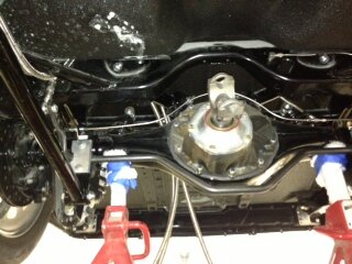

A few more pics I took during the process!!

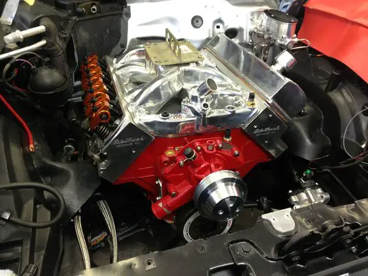

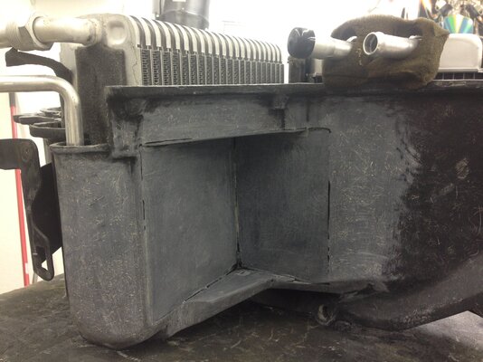

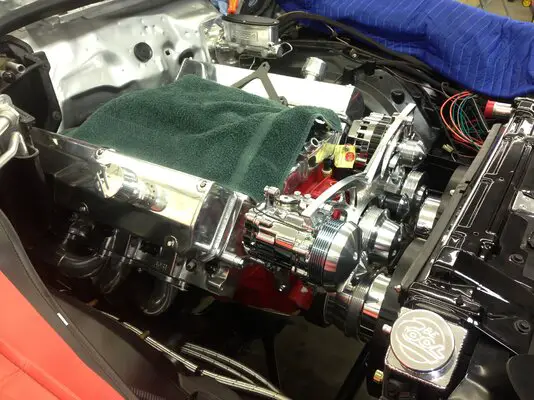

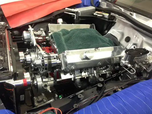

Well--- finally took the time over last weekend to finally install the new motor, trans, and American Racing Headers. I just have to say, other than the valve cover clearance on the passenger side, this thing fits great!!! I can't wait to get it installed permanently. I ended up taking a chunk out of the A/C box and I also was able to notch the valve cover to get the clearance I needed. My plans now are to get the headers Jet-Hot coated, get my valve cover re-welded with a filler panel, and I will spend the next few nights getting the a/c box fiberglassed back in and repainted. Not exactly how I wanted it to turn out, but I'm not about to not run A/C. All in all, I'm very pleased with the fitment of the drivetrain. Hopefully I can get this thing operational by the time summer gets here.

Thanks guys for the compliments. I ended up going with a 200-4r from CK Performance. I ended up going with the all billet unit they offer. It was probably a bit overkill, but I'm looking forward to seeing how it works. Should have the headers back by next week sometime and then it all goes back together.

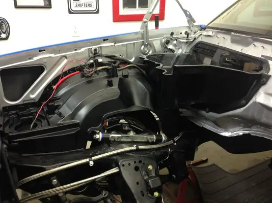

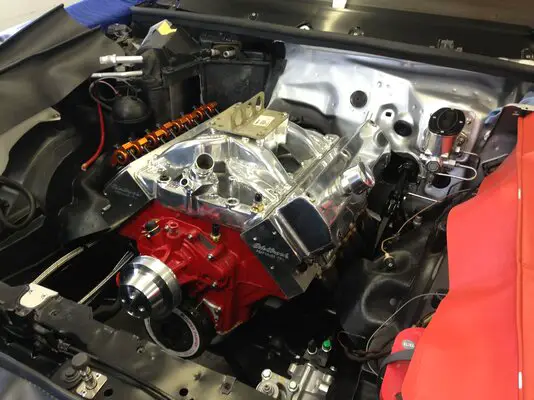

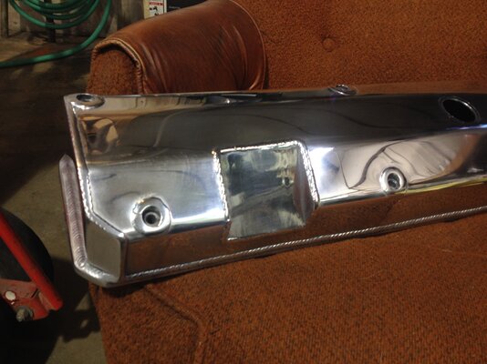

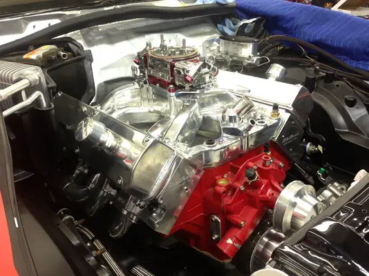

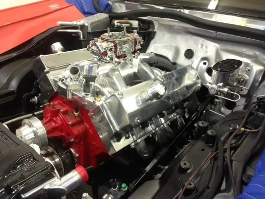

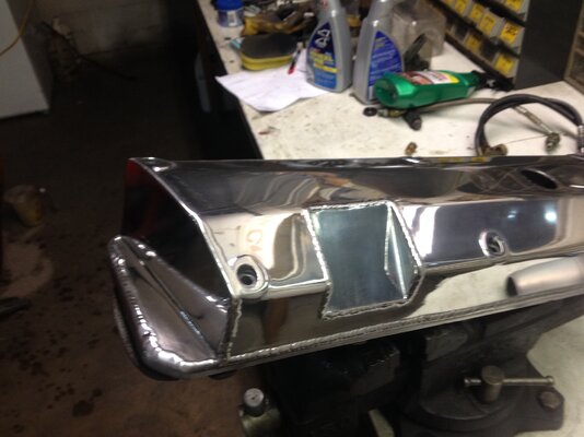

Well-- finally able to post a progress report. We finally had a chance to install the motor, transmission, headers, and front serpentine set up over this past weekend. I had some fitment issues with the AC box which I have finally overcome. I had to do a little fiberglass work to the AC box and also weld a couple of reliefs in the valve cover. Seems to have plenty of clearance now. I have all of the underhood wiring to do yet as well as finishing up the fuel system. I should have the driveshaft by the end of the week and will move on to exhaust after that.

I thought I would post a couple of pics of what I had to do to make the motor fit with the AC box..
