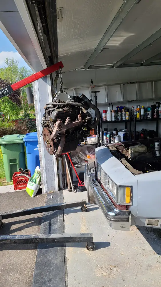

The messy part is removing the coolant, keeping it for the last step before lifting the engine!
tight clearance between the car and the garage door 🙂

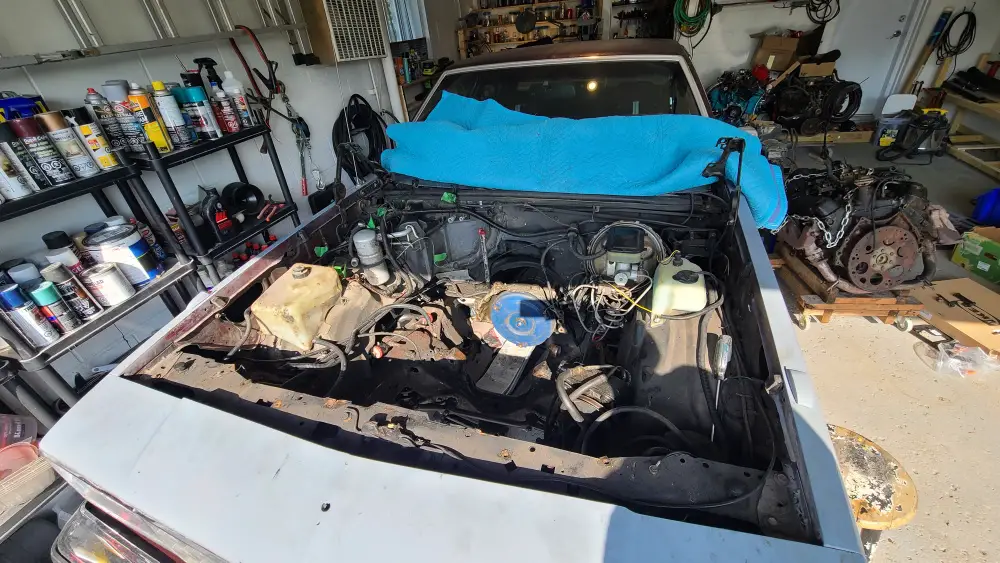

lota of crap to scrape and clean in the engine bay before I can think of putting the new engine 🙂
was quite funny to see one engine mount fall on the ground, disintegrated, as the engine was lifted 🙂

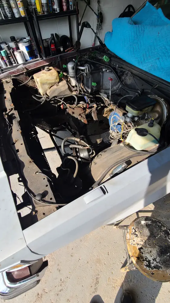

first phase is scraping the thick smudge layer off. not sure what I will do to next to further clean it, but happy to see years of engine oil leaks prevented rust to attack any part of the frame - at least, in this area 🙂
post-scriptum: my 2003 Oldsmobile Aurora with the Northstar-like V8 engine has better self-lube abilities, after 260000km, no rust around the engine either, but it extends till the middle of the car... 😉
...that part of the frame is like-new... love to see the # stamped in the steel and the fabrication marks. Also noticed that the factory welds are very, very crude.
