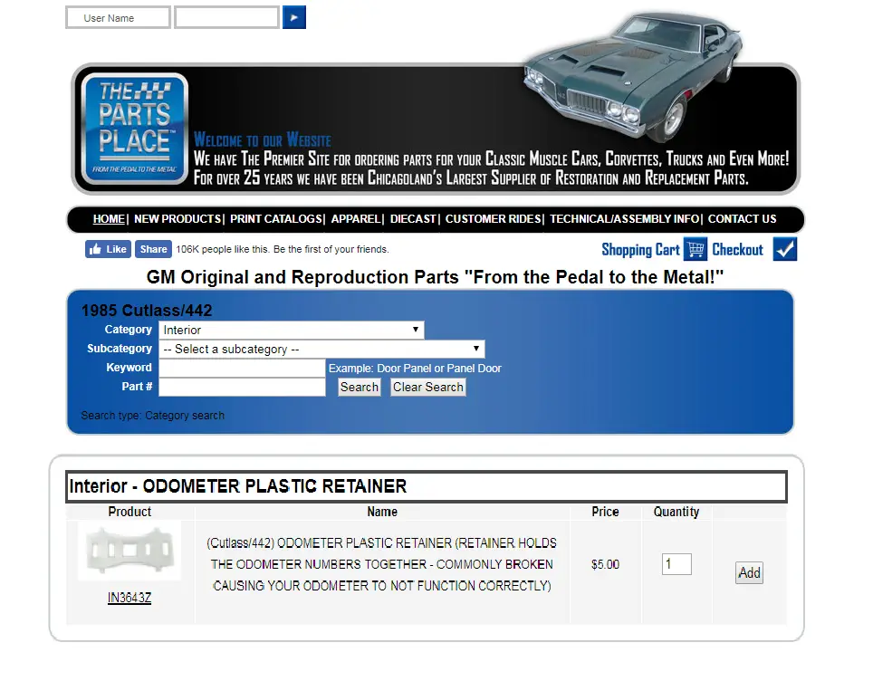

So if anyone remembers my gauge cluster mod, I spoke in the video about the little Odometer Plastic Retainer and how I was nervous because they didn't make new ones.......well, they do.
Found this just poking around looking at parts I may need to get. Good to know.
Hutch
That is good to know, I've kept broken Speedos just to have those plastic bars as a spare.
