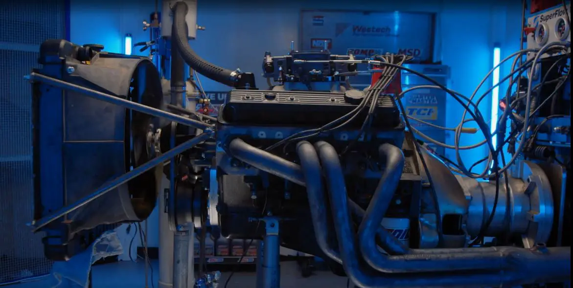

Rewatched that video, a standard 350 sbc (center bolt valve covers, aluminum heads, intake, headers, small cam, etc) that makes 408ftlbs at 3900, and 349hp at 5200. It gave up 8ftlbs and 14hp with an 18" 6 blade clutch fan. Ain't gonna miss that, nor feel it.
As said, the worst fan they tested was an 18" 6 blade solid fan. killed 20ftlbs and 30.4hp.
Let it be known, they tested the fans with a shroud and in front of a radiator.
This pic was with the clutch fan, but it shows their setup the best.
