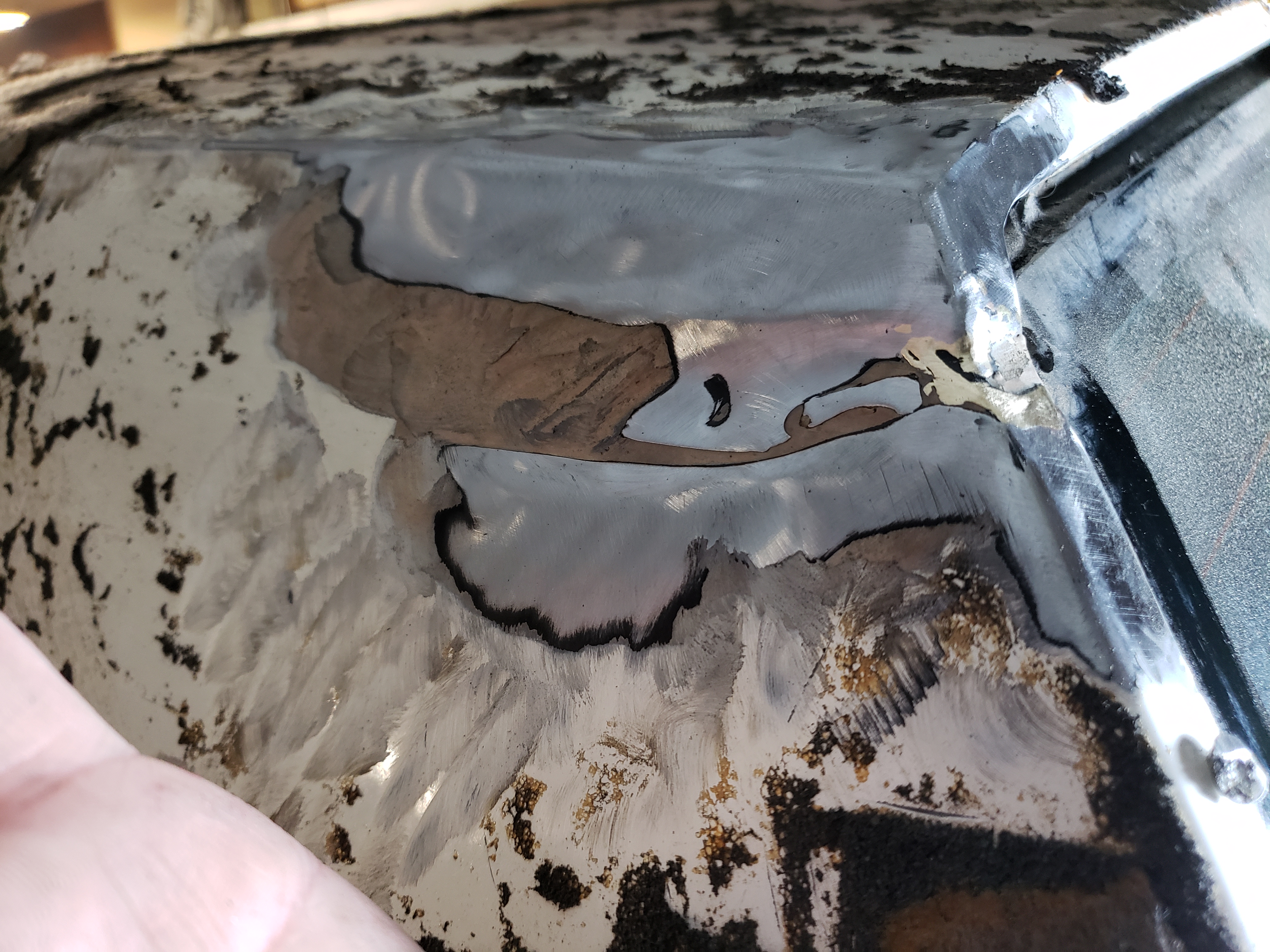

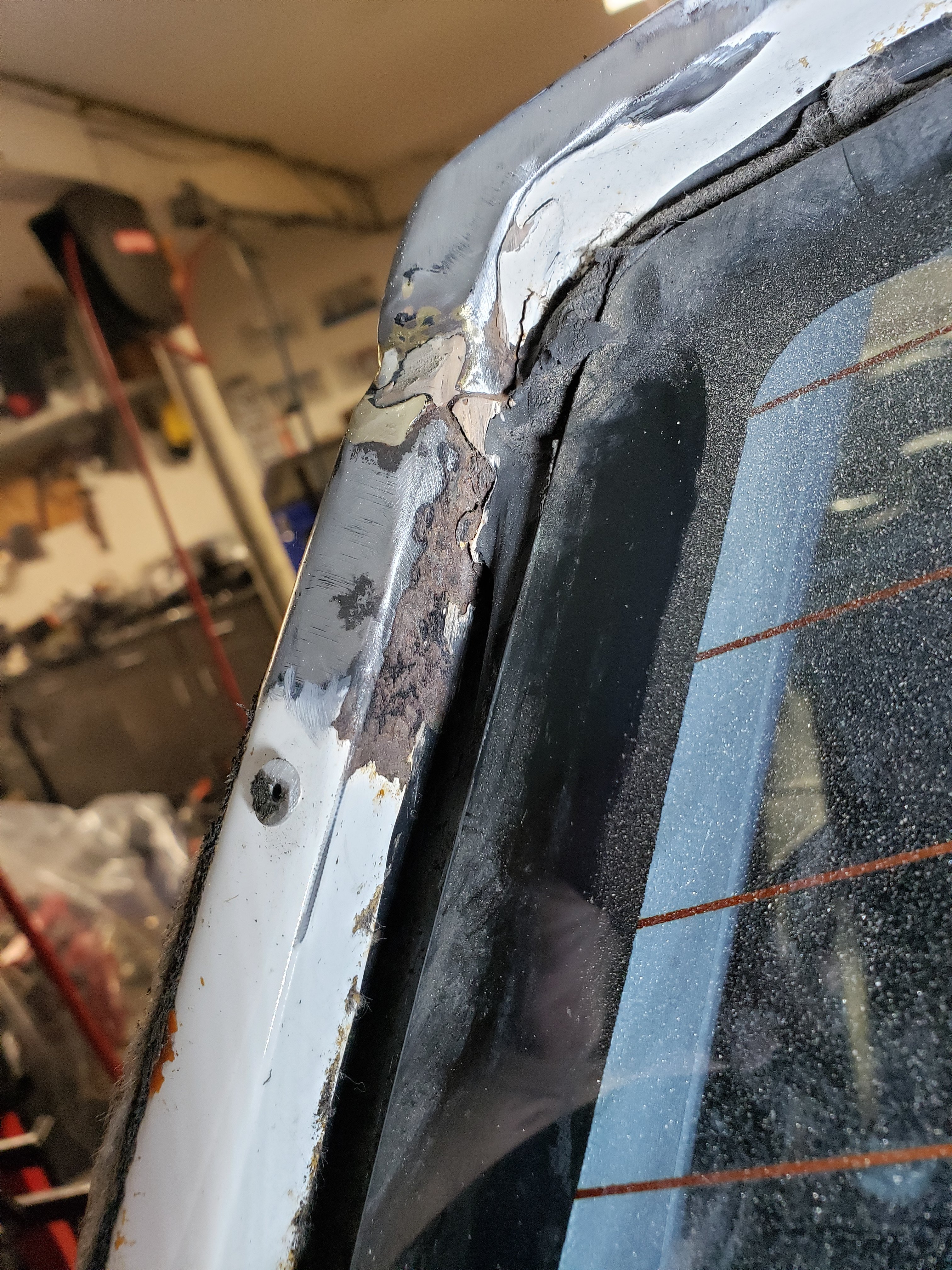

That divot where roof seem is looks like it's about 1/4 inch or more deep with filler. Is that normal? No rust really so I guess that's good
Any opinions from those who have defeated this beast before? Lol
Looks normal to me for a factory vinyl car. The factory filled the seam with lead, then slobbered on filler just to get it relatively smooth before putting the top on.
My car was factory hardtop that had a dealer installed top on it. My C pillars were super slick when the top came off, but the rust pinholes across the top and above the rear window dictated the roof skin swap.
Since I'm waiting on epoxy primer and rust converter I figured I would delve deeper into vinyl top area a little View attachment 132669View attachment 132670
When you get to the lead, melt it out. It's much easier.
Wire wheel until its clean, hit with a 36 or 40 grit rolock disc and fill with fiber reinforced filler. Go over the fiber filler with normal filler nice and thin. 😉
