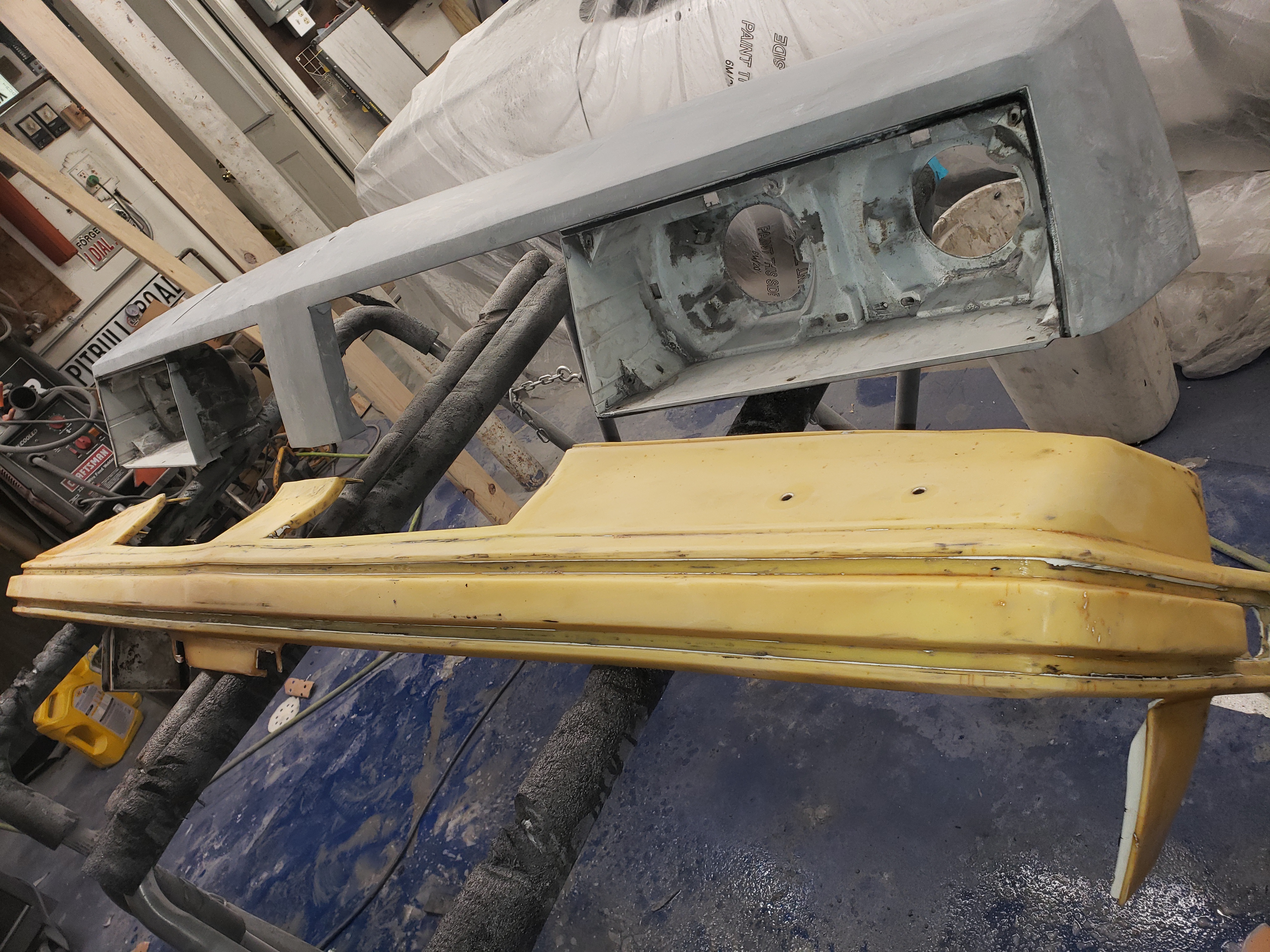

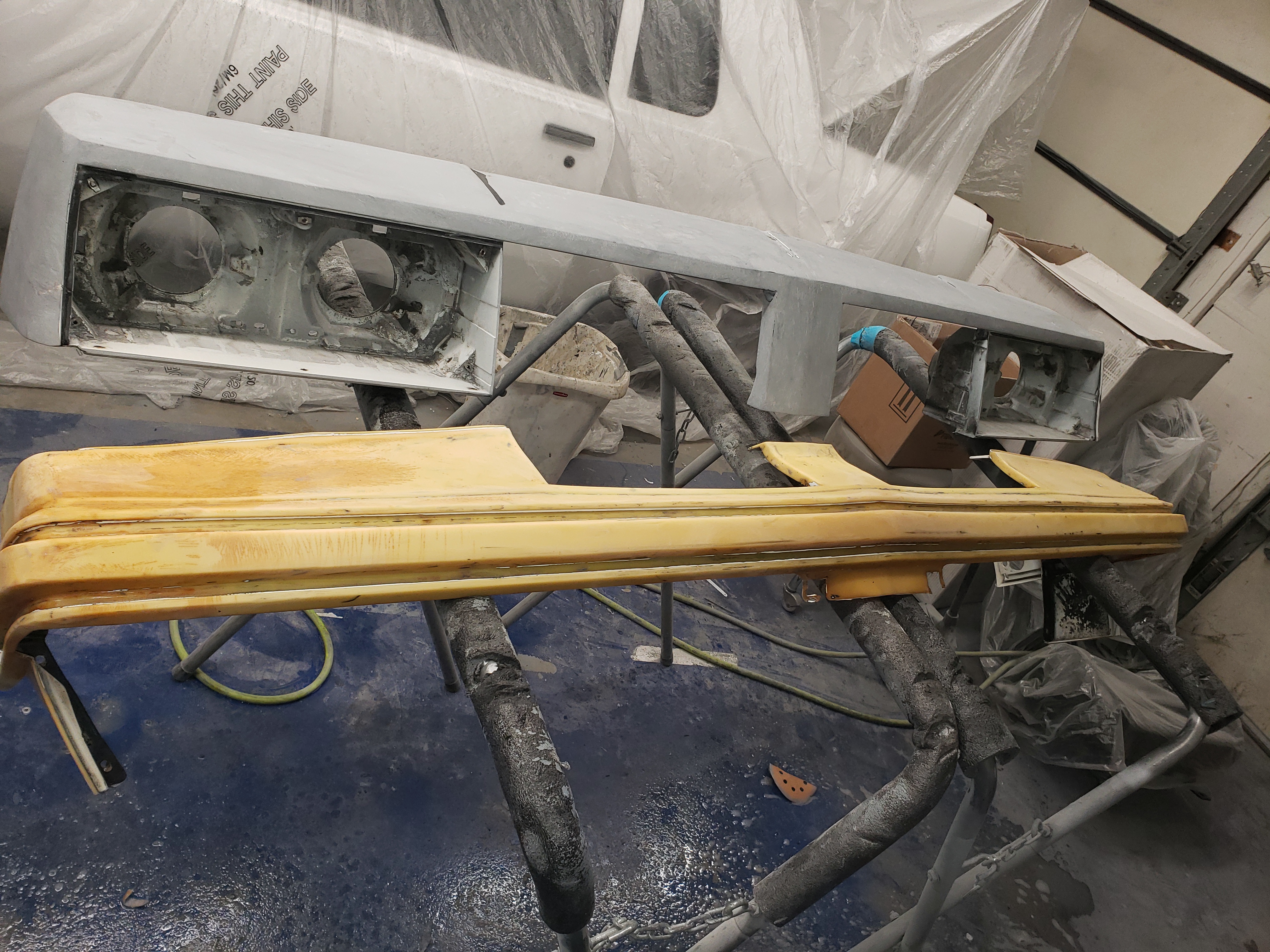

How'd you go about stripping them?These front plastic covers are pretty tough to strip. I'm about 98% there. I'd rather work on metal. View attachment 230139View attachment 230140
I used 320 on a DA with a soft interface pad where I could. And by hand where I couldn't. There are many long thin recesses and small creases and you can see in pictures where paint remains. I'm going to try some 220 wrapped on a paint stick for those.How'd you go about stripping them?
Originally I tried 600 and 400 but that would take eons. That old paint is tough.
Fingers hurt, eh? Don’t worry, I feel your pain there 🫠I used 320 on a DA with a soft interface pad where I could. And by hand where I couldn't. There are many long thin recesses and small creases and you can see in pictures where paint remains. I'm going to try some 220 wrapped on a paint stick for those.
