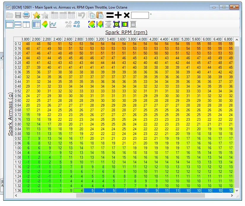

How far are you from the low octane LSA tune, and how far from the high octane tune on the bottom?
Sorry, my ADHD has me forgetting
Low Octane LSA, 5 to 10
High Octane LSA 15 to 20
The numbers seem to jive with what Happel and Holdener run on their LSA stuff. Happel seems to be on the conservative side of things which I like and Holdener is ragged edge dyno stuff.
Happels 4.8 LSA runs 13-17 on flex, 680 wheel on the terminator setup, but that might have been with spray.
His 4.8 LSA when it had HPT was 10-15 degrees and 570 wheel with 12-14 psi, 80% E, 110F IAT's.
Holdener just posted his 4.8 with a STS-V m122 blower picked up 80hp going from 18 degrees (520hp) on gas to 23 degrees on flex (600hp), but that is VERY controlled conditions with tap water temp heat exchanger temp.

Now that I'm caught up, 8-14 seems very safe for pump 91, as that should be what the LSA is built for on the high octane tune. If you have 317 heads i would think 23 degrees on top with E is no biggie at 10psi. The LSA has 821 heads and they are a faster burn than 317 and take quite a bit less timing, I have a rod that will confirm this.
Yeah the more I see the more I realize how low of timing I actually was running. I do have 317's, I didn't know about the burn rate on cathedral port vs. square port stuff.
8-14 does seem pretty reasonable for 91 on a realistic heat soaked setup. I have been digging around on LSA forums and they say 6* of knock retard is pretty common with 140 IAT on the stock tune on 91/93 which puts it essentially RIGHT in that 8-14 range. Max torque at 4200-4600 rpm. 12ish PSI.
General consensus says 20 degrees seems possible if it's cool and on 93 octane, or spraying some alky. That stock LSA 14-20 high octane table does make sense for an engine that is not heat soaked and on 93.
24-26 on E85 seems like the general consensus so another 5 degrees over gas, which kinda aligns with the Holdener gas to E85 test he did where he went from 18 on gas to 23 on E.
I'm going to dial the fuel in on this 8-14 tune and once it's more settled (there are still some holes due to the fuel pressure change when I went to twin pumps) I think I will throw the 2.55 pulley I have on and see what that does to my boost. It should get me to 12-13psi and I will dial the fueling in there. If my IAT's aren't crazy I will look into creating a slightly more aggressive timing table to try at the track. Probably 12-18 degrees and do an A to B comparison at the track to see if I pick up any MPH.

Happel posted an LSA tune on a ly6 last week that was tuned to run on 87 but add timing with flex. He was running 8-12 degrees on 87 with 6psi and added 6 degrees with 50% ethanol intro. Exactly what I want my tune to do.
I added the timing into my low octane table to get me to 8-12 base on gas and then plugged a goal of 6 degrees into my flex adder. I also pulled my IAT retard back a bit. It was starting at 140 so I bumped it to start at 160. My goal is to hit 14-18 in flex at the track and then trickle in 1-3 degrees and see how the RPM behaves.
