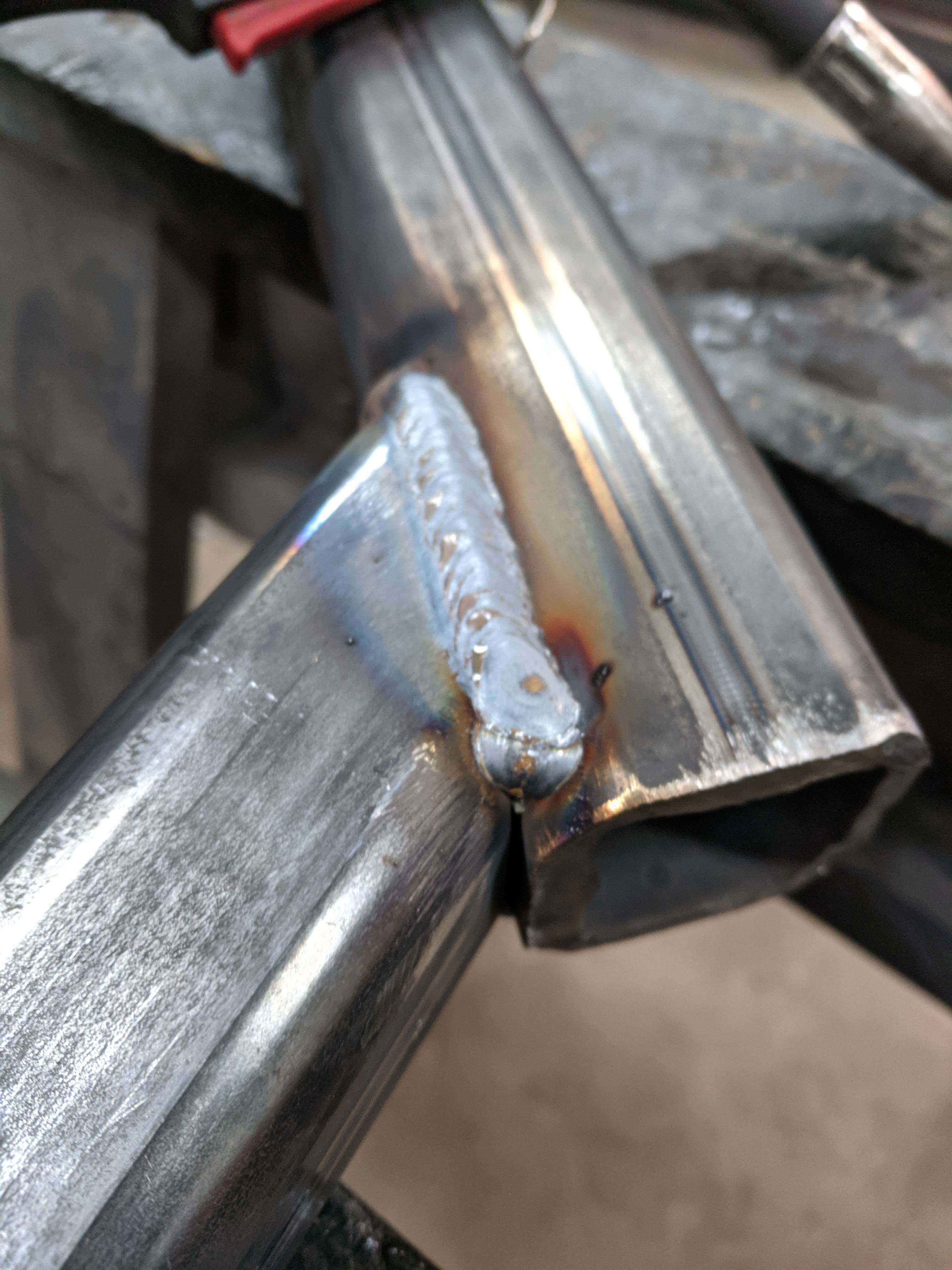

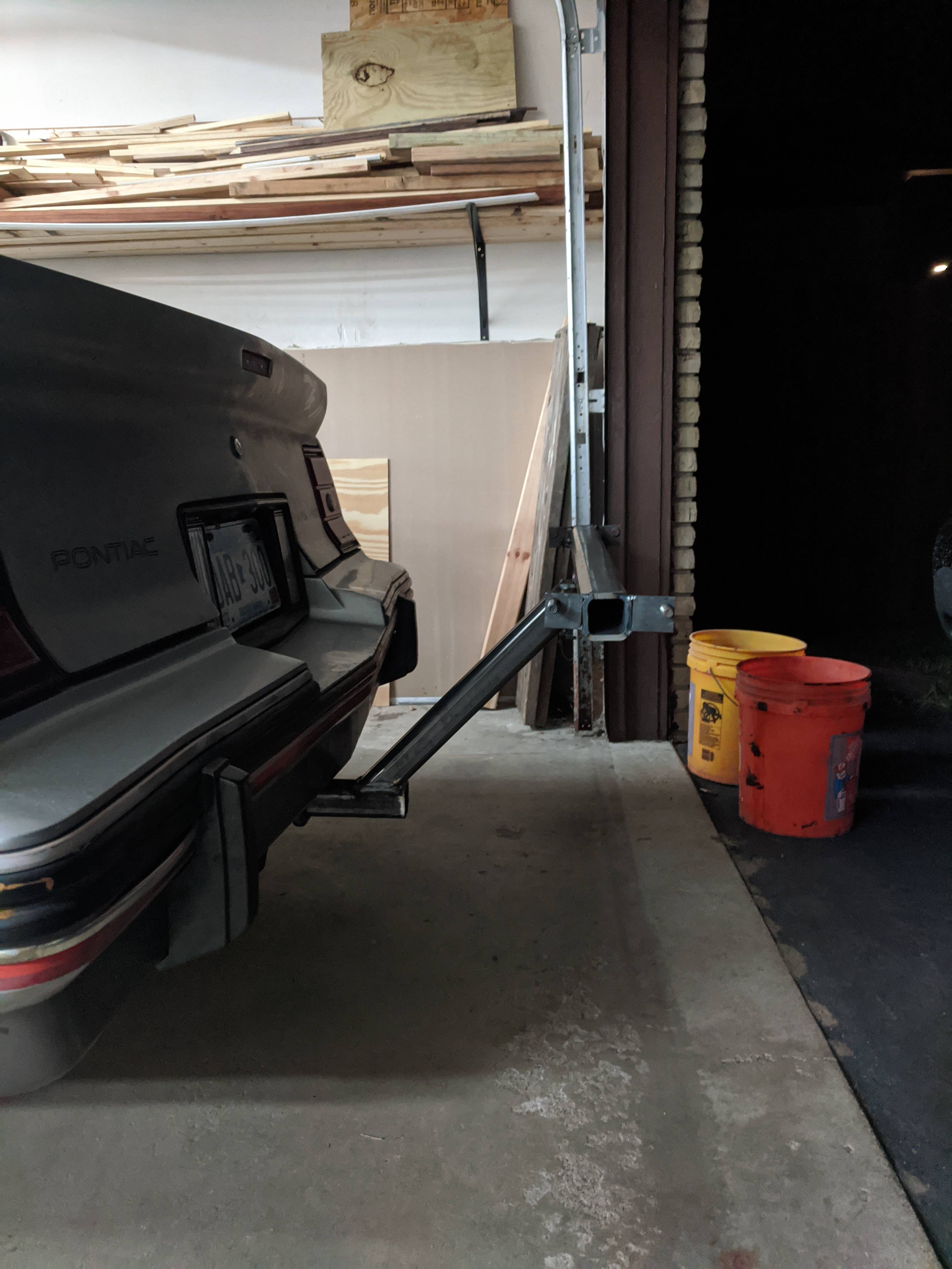

Got the 2" square tube today and got started on the tire carrier. I brain failed and bought 1/4 wall instead of 1/8 wall so it's stupid heavy but it turned out nice. Holds the drag tires nicely. I had some leftover studs that I pounded into the tabs and each wheel is held on by 2 lugs.

What? No TIG welding? 😉
Lolz, yeah I thought about flexing with the tig on this project but it's 3 hours away at Dad's so I pulled out the hot glue gun welder instead 🙂 . He has been fiddling with the torch and pedal on his Maxtron 450 big arse welder since that is TIG enabled and wanted to see if that works.
I should be getting into my fair share of TIG work this winter with turbo pipe fab work on my Cutlass so just be patient 😛

The tire caddy also hit resonance on certain road patterns and shook the car. I need to shim the gap between the hitch and the tire caddy.
