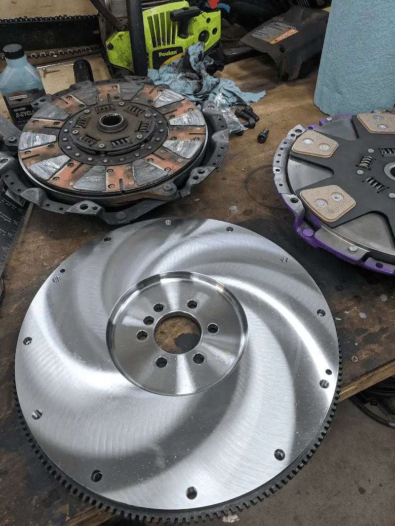

As usual dad's diagnosis from 250 miles away was right. The friction disk warped.
Some heat marks on both the pressure plate and flywheel. Going to call some places Monday to refinish the flywheel. It's just in the boarderline of fitting in my lathe.
The rework I did on my exhaust and crossmember this winter did pay off. The exhaust dropped out easy and pulling the xmember was quick. Took about 2 and a half hours not working really hard. I can probably get it down to 2 now that I know the order stuff needs to happen.

Bought a new clutch from a local buddy. I found a few places to refinish my flywheel so gotta make some calls tomorrow.

Yesterday I spent 2 hours driving around trying to find a shop to refinish my flywheel. First one said they would do it, I dropped it off, drove 45 mins home and got a call as soon as I got home that it was too far gone and they wont do it.
Called 3 other shops and they either don't refinish flywheels or didn't pick up the phone.
Finally found one that did it. They removed 0.017". 24 hour turnaround for $107. He said it was a tough one and took a lot of CBN off the blanchard but it looks good, it was cheaper than a new $400 flywheel and got done soon.

Flywheel looks good. What are the differences between the two clutches?
