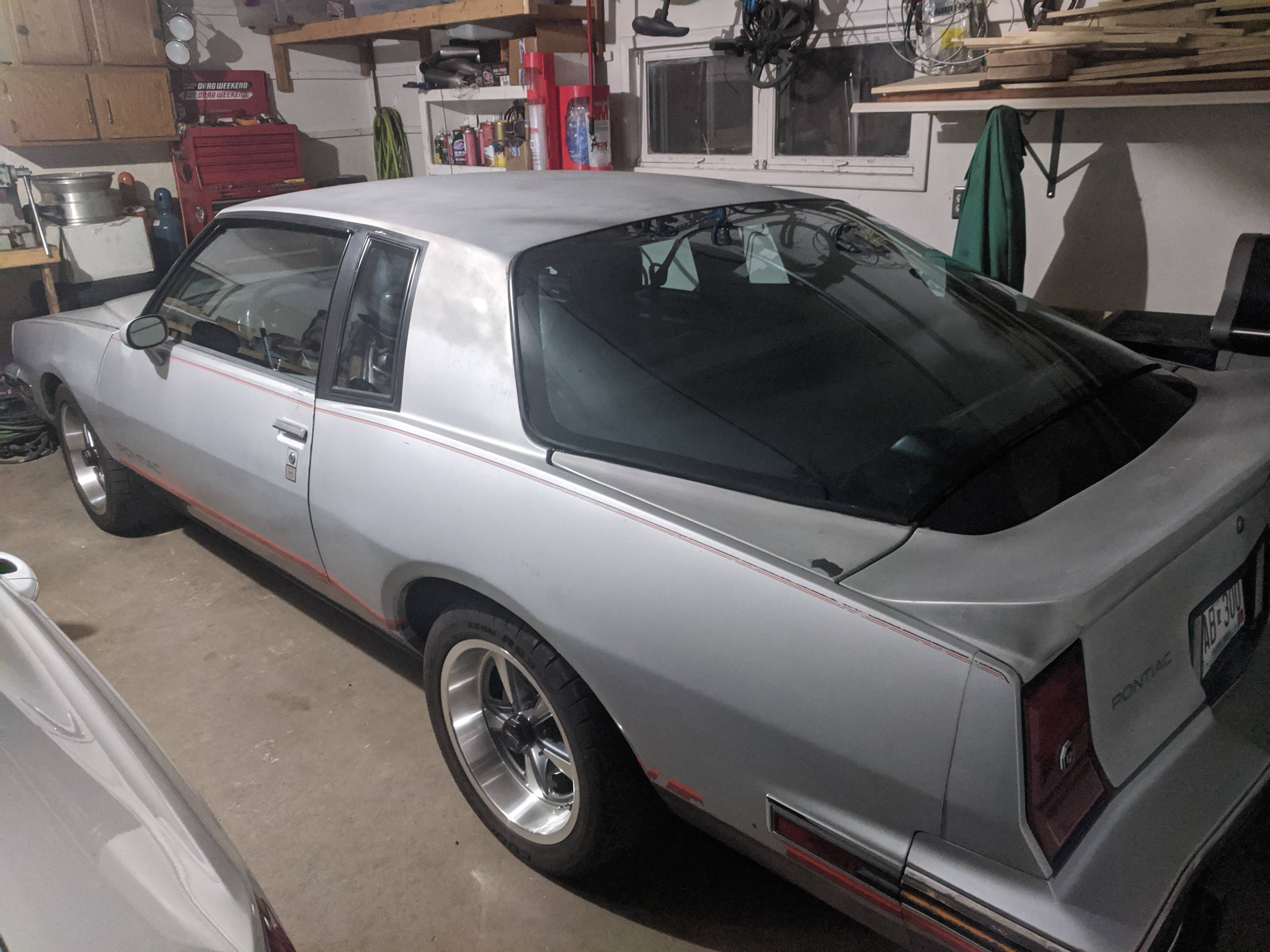

I'm supposed to be leaving in a few days to make the couple thousand mile trip to Hot Rod Power Tour and back and I don't have vital engine parts laying on the work bench and I'm not scrambling to overnight parts so I can make the trip. All I can think to do is vacuum the carpet, give the car a wash and load up the cooler.
Something seems wrong. Either 5 years of slow and steady updates are starting to finally pay off and the car is legitimately working, or I'm forgetting something important that is going to strand me on the side of the road somewhere in Indiana 600 miles from home.... Let's hope for the first option.

I aligned my front bumper and hood. Front bumper has always been low so I pulled the support up and pulled the hood forward and down on the hinge side. Found out I had half a dozen missing bolts in the driver's inner to outer fender joint.
Painted my front air dam, checked some nuts in the exhaust for tightness, changed oil in the trans, found some vaccum caps and hoses that had small cracks, and vacced the carpet.

Took the car on a short cruise and everything seems ok. I need to clean it up and load the cooler and I'm good to go.
