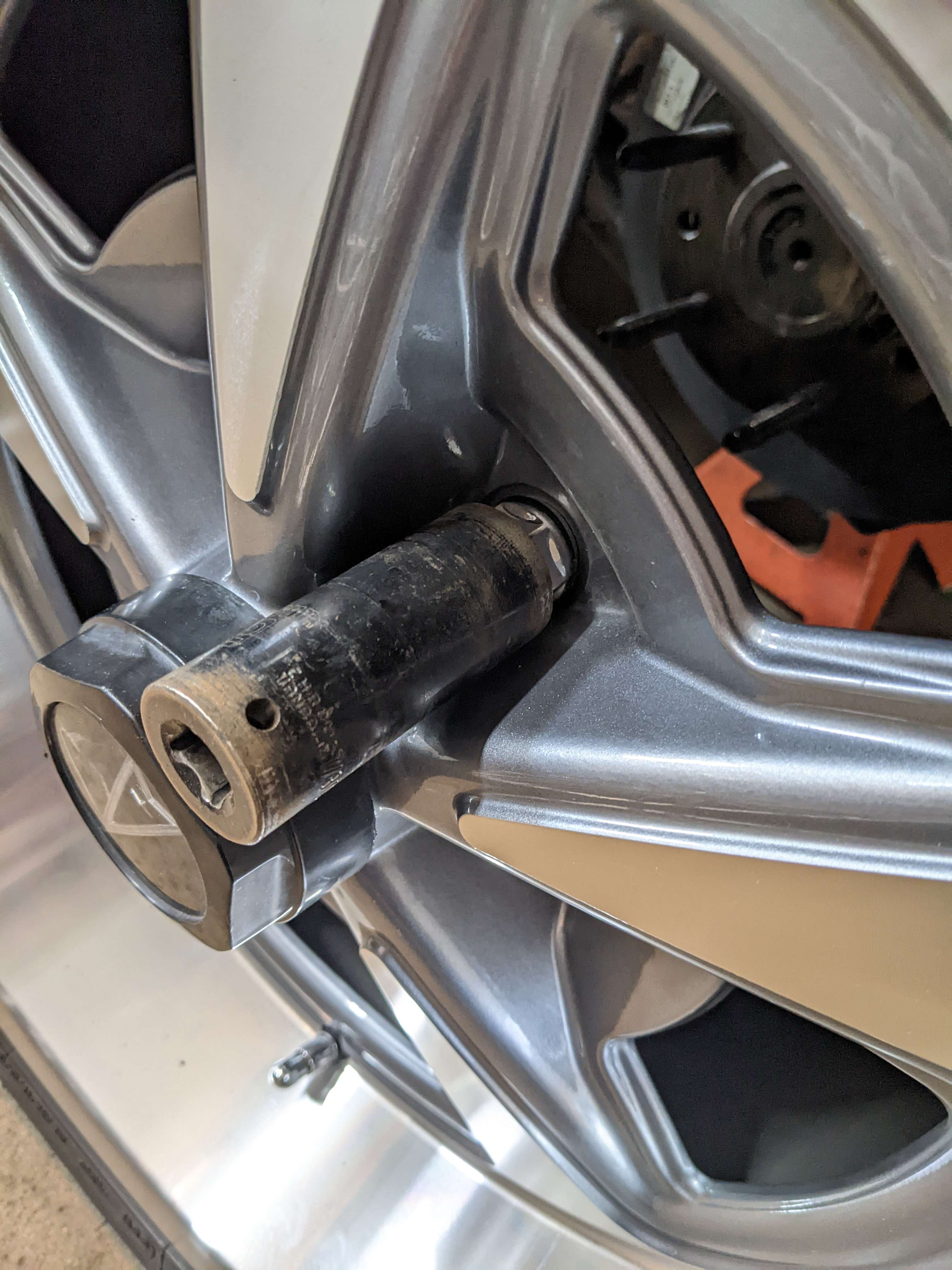

Trying to get the studs replaced so I can drive the car before Midwest salt life kicks in.
Good news, plenty of room
Impact socket clears pretty ok. I might turn the OD down at the very end so it doesn't rub the wheel. A standard 7/8 chrome socket fits fine.

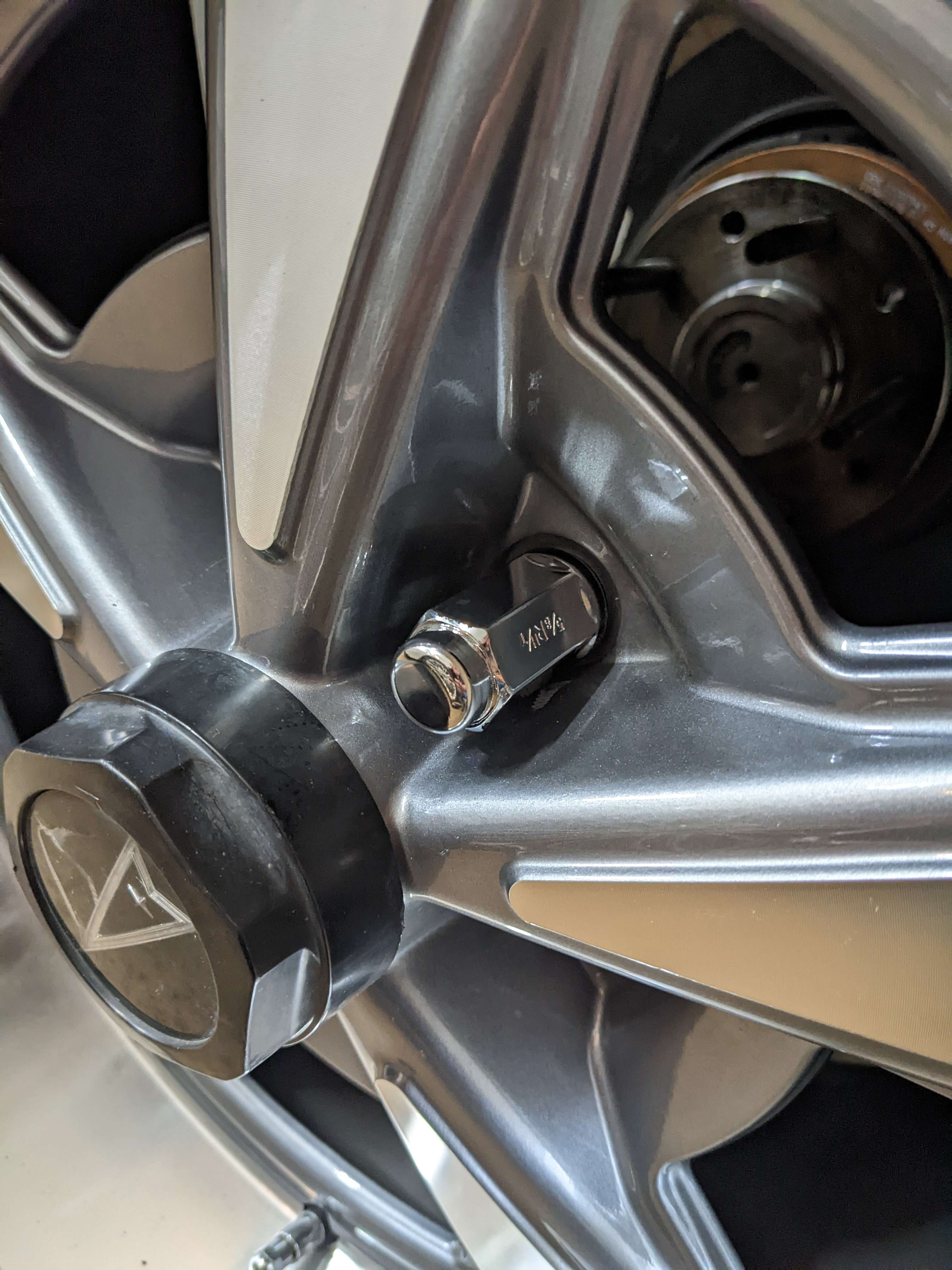

I need to cut the end off these lugs but I've got a plan

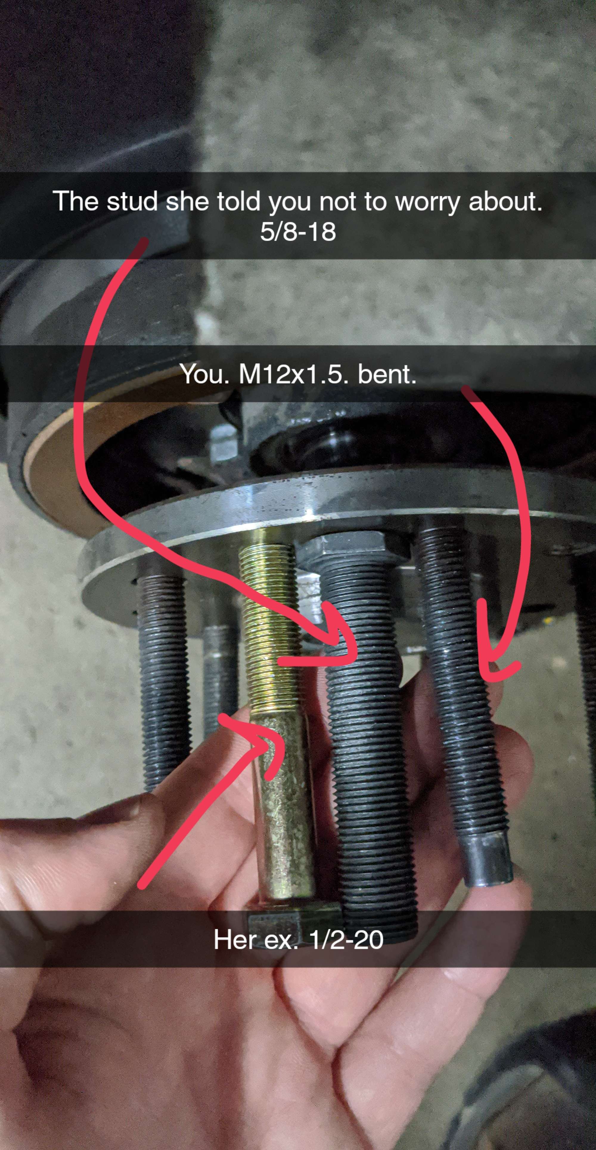

I feel like you might be overcompensating, but I also wanna see you try and bend those. Lol

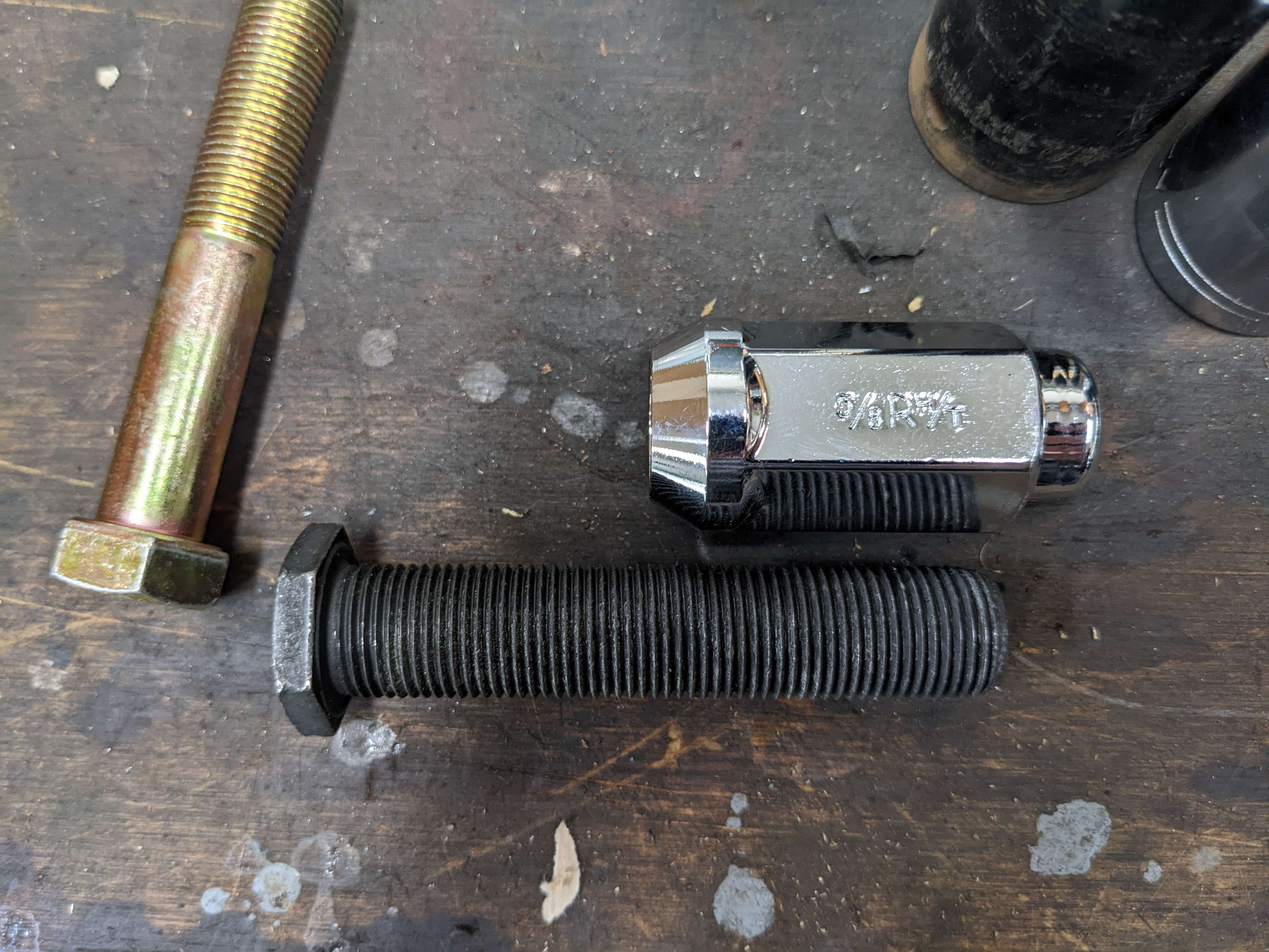

5/8 were the same price as 1/2 and I have an excuse to use my lathe so overkill it is!!!
Aways flexing the lathe, and our inadequate metal turning abilities. 🤣
Looks good, and you have influenced me to get a set of shank lug rims from the get go, thank you for trailblazing that failure for me. 😘
