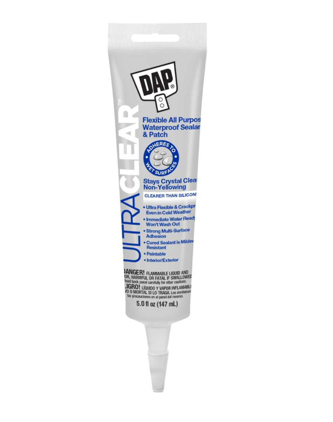

If those new center caps don't look like they are going to stay on any better than the originals, I usually use a few dabs of clear silicone to help hold them on.
I also put a small perimeter bead of clear silicone around my sticky weights on my wheels too.
This is the stuff I use. DAP ultra clear
Good idea on the DAP. Jegs has the tank braces available, but the neighbor might have an eaiser solution, just have to wait for him to get back from vacation.
