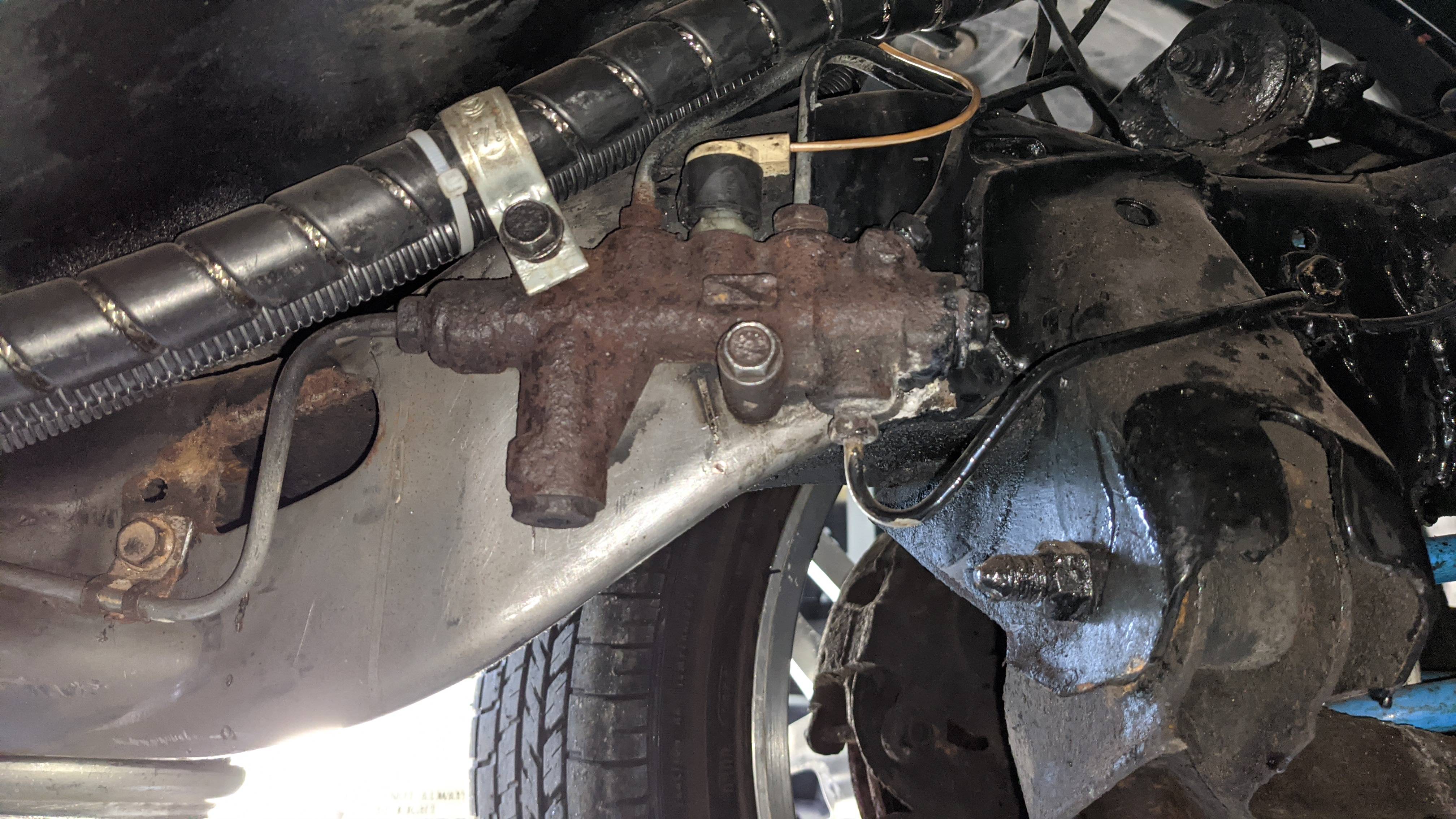

Could you have it (proportioning valve) plumbed backwards? That would keep a few lbs od pressure on the front brakes instead of the rear.Yup, real quick like too! I noticed the other day when leaving the show I could hear that infamous roar again. Only does it at 60mph or above, but it raises concern if something else is going on.
I'm running a stock valve from an 80's "box" chevy that was disc/drum since I kept destroying the threads on the brass valves from the stainless lines.
That's possible, not ruling it out. Doesn't the front MC line go to front line on top of valve? Rear MC line to rear fitting on valve?Could you have it (proportioning valve) plumbed backwards? That would keep a few lbs od pressure on the front brakes instead of the rear.
When you set HPT for a stock TB it'll whistle with an aftermarket. Mine doesn't whistle....Unrelated, but applicable.

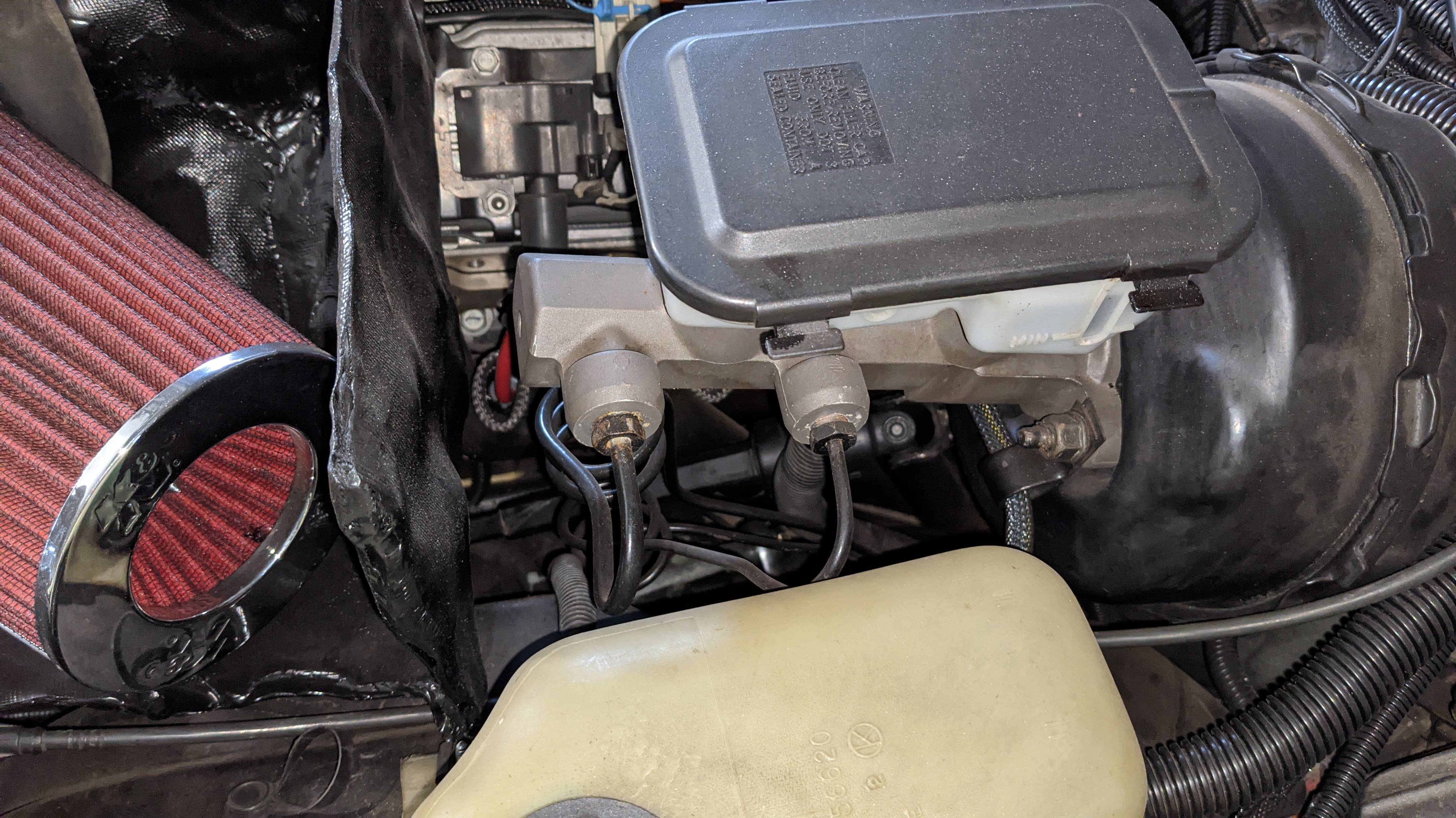

Mike, so you're saying the rear top (left arrow in pic) should be going to front bowl on MC? If so that's def my issue! Grrrrr, I hate messing with brake fluid.Here's my car:
Top rearmost line is for the rear brakes.
Same big boi line at the front of the MC:
