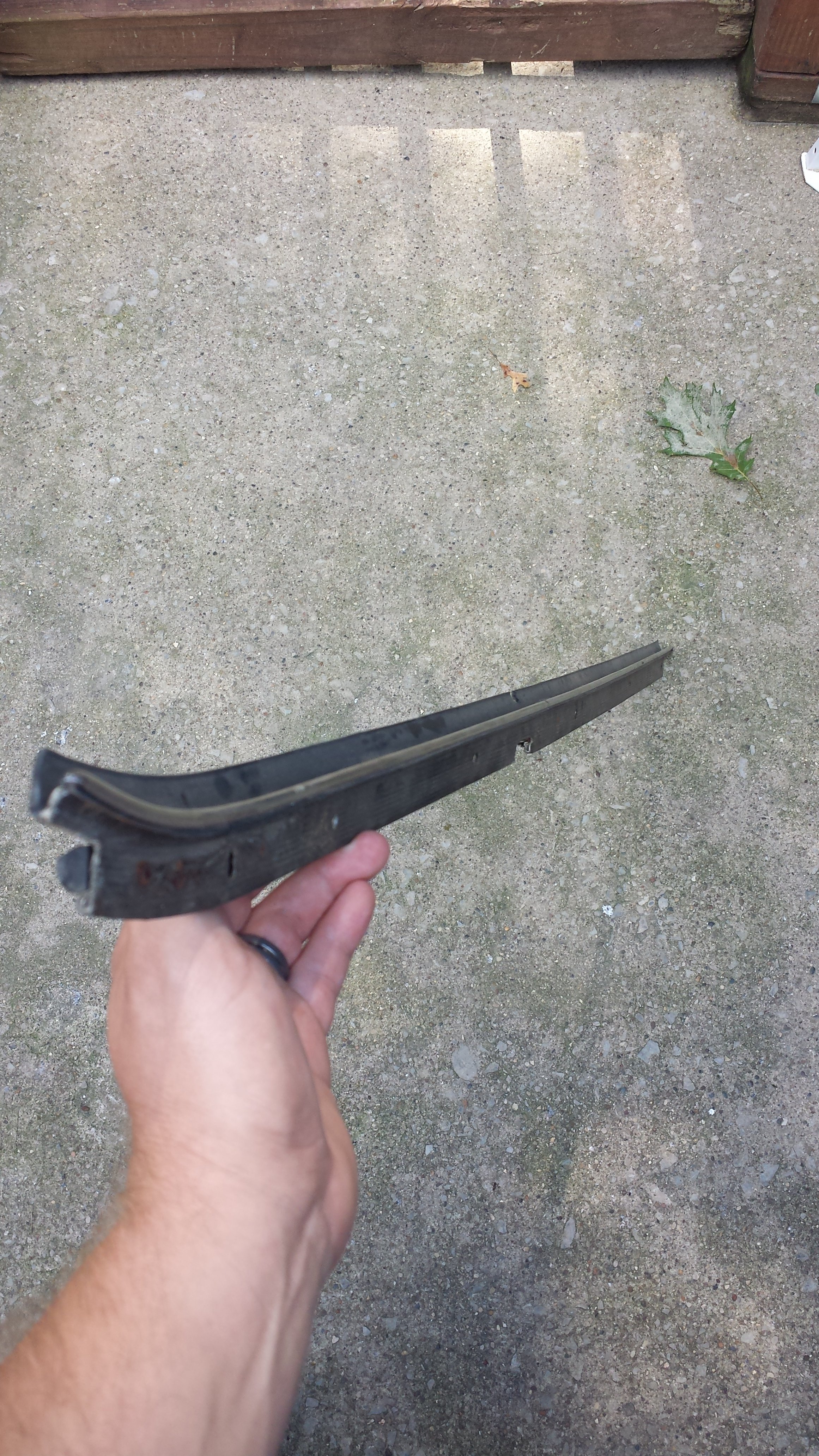

Dug out my outer window sweeps to figure out which are the correct ones i need to order. I'm pretty sure i need the type without the reveal molding as my cutlass didn't have the chrome trim on top of the door flat....guys please correct me if wrong. Also, buick guys chime in please, the 87 regal, GN, and cutlass all use the same sweeps correct? I'm thinking about getting the black bead style for the GN since all my trim will be black, just wanna make sure first. As always, thanks everybody for checking it out!!!View attachment 54281
Ever find out if the regal and cutlass had same inner and outer sweeps? Or if they were actually different.
