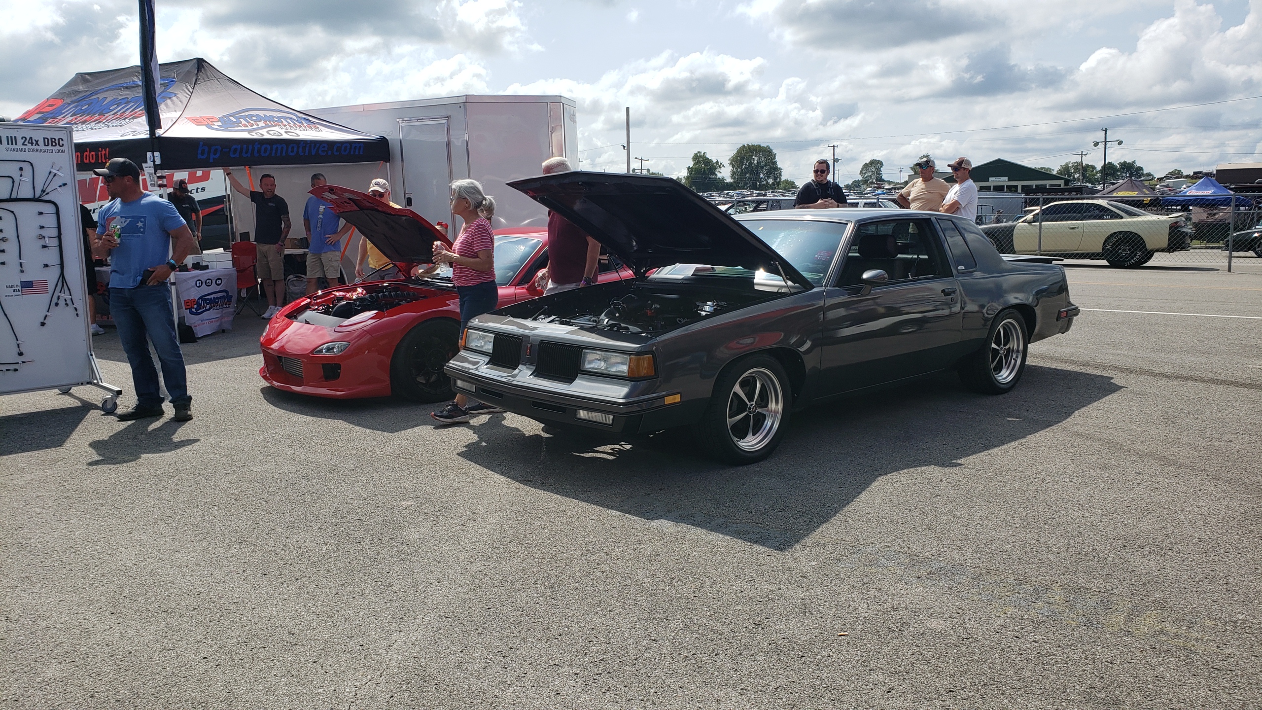

Forgot to mention, I had the privilege of parking at the BP Automotive booth for LS fest. I have their efi harness on my car, and the owner Bill is a super cool dude. They're local in KY, and everything is USA made with ridiculous QC standards. It was cool to see the attention the cutlass got by actual car people instead of the normal boomers who think our cars are dumb. Gained some traction with some companies for hopeful future endeavors, and also going to start preparing for Bluegrass World of Wheels in January. I entered, just have to hurry and wait for a response. That's all for now, I think.
