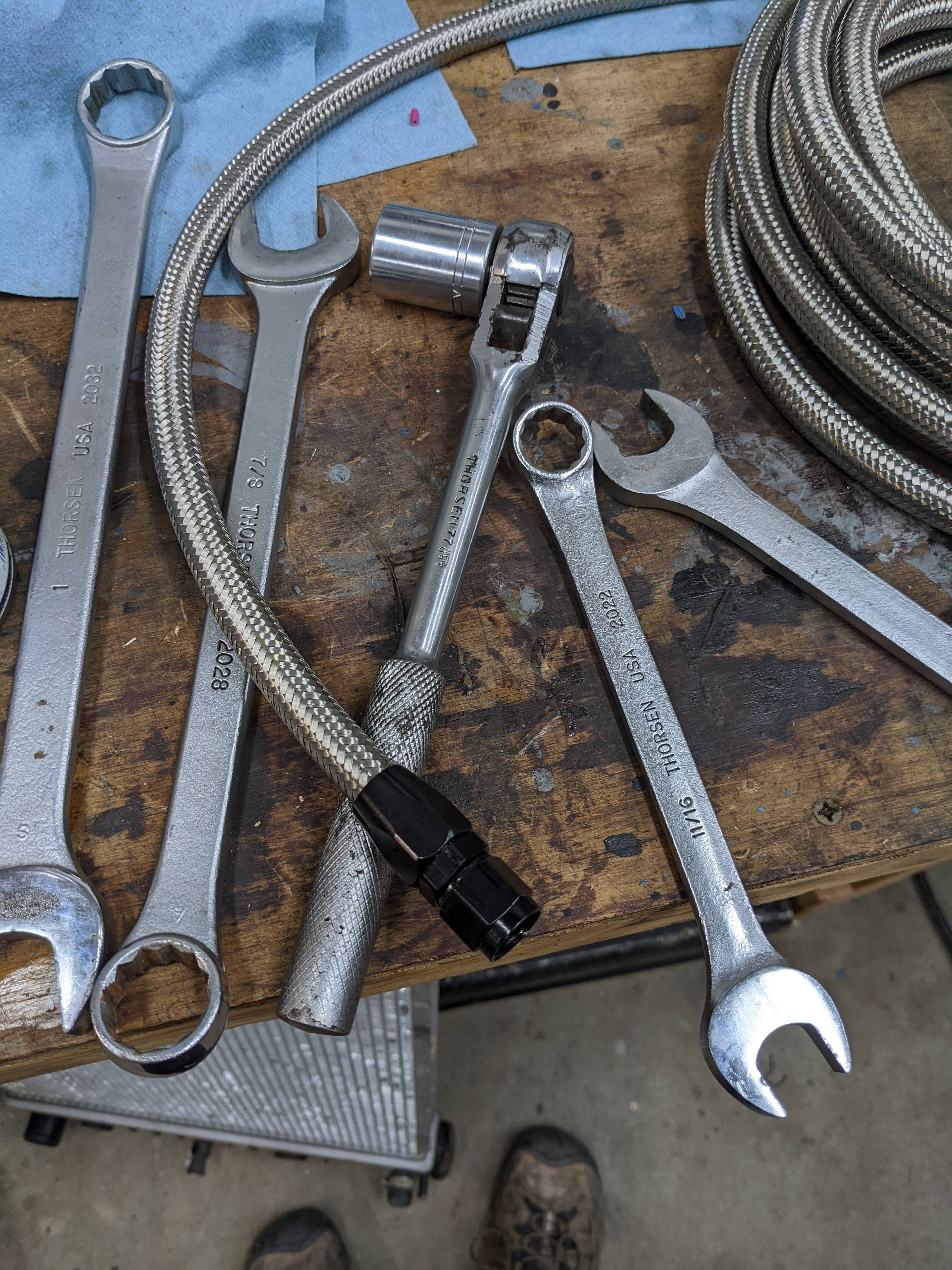

Fuel filter and feed and return lines are in.
I left the extra hose in the engine bay. When I get the SFI engine in I'll figure out the final length and cut and install the hose end.

Am I the only heathen that doesn't give an F about using AN wrenches and just mars them up without a care in the world?
Honestly they really don't mar up that much using steel wrenches (shrug)

It's not marring fittings, it's giving them character...

I wrap some Teflon around the fittings I care about. I have AN wrenches and adjustable, TBH, they may the fittings too.
