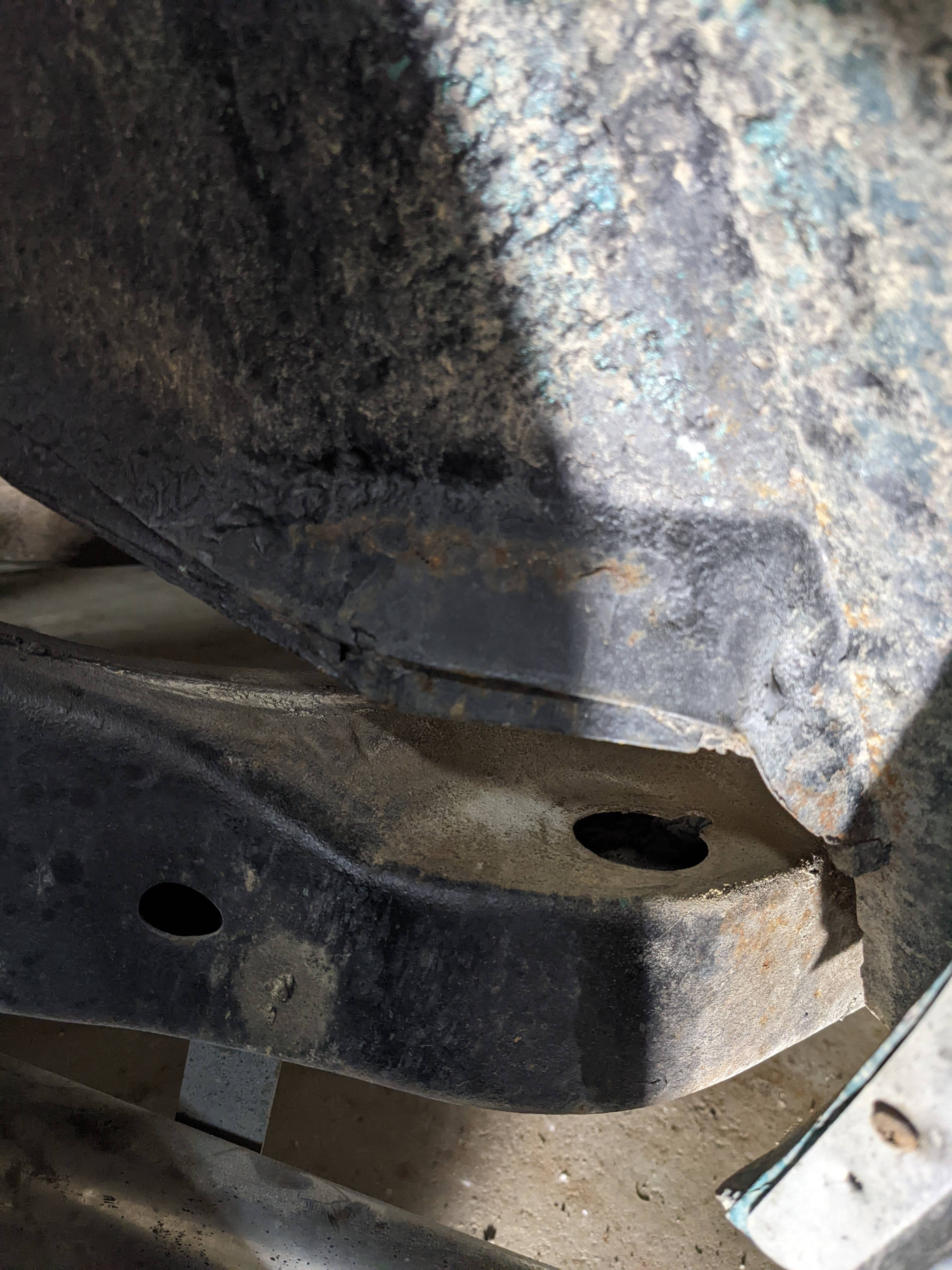

Got my body mounts installed tonight. The last of my fuel system parts showed up and I planned to get the tank and pump wrapped up but I called it quits at just the mounts.
I used the bolt kit from Mike's. It was ok. The OEM bolts were longer on the header panel making it a but tough to line everything up, the OEM bolts had more thread and they had a chamfer on the first few threads to make alignment better. I was hoping for an OEM replacement and these were OEM inspired. They still work but weren't ideal.
My 81 non f41 car has the GP bushings oddly enough
It was time
Most frame holes were fine
But the fronts behind the front tires were rusty
Used one of the spare washers and although I didn't have a 1.5" holesaw I had a lathe and boring bar so I opened it up and laid it in the frame and tacked it in from the bottom
I only fixed the passenger front, the driver's probably should have been done but it wasn't as bad, so I left it alone. Either way it's done.
It was time

Yeah I have been lucky in that both my 2+2 and this car were Texas cars and are relatively clean. I was a bit optimistic thinking the Cutlass would be as clean as my 2+2 (which was spotless with zero broken bolts or frame holes rusted out) and I wasn't, but still I have nothing to complain about.
2 broken bolts and 2 rusty frame holes is honestly almost best-case. I don't envy Canadian cars.....
