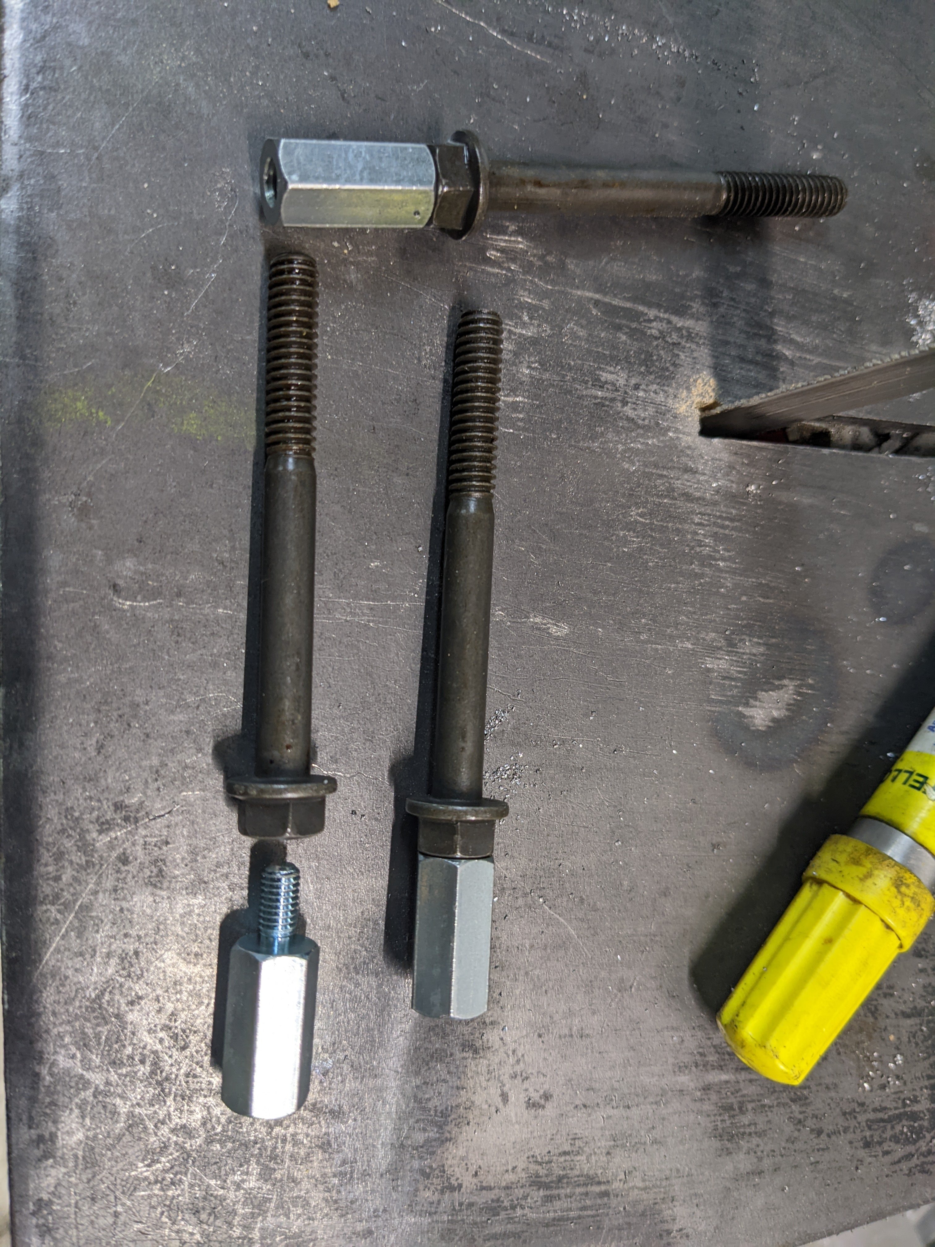

Busted out my lathe skills and made coil bracket standoffs by tapping a 10-32 hole into the top of the new valve cover hardware and threading a standoff into the top. I need to weld a small tab to the top of the GM coil bracket and they should be good to hold them in place.
Put the cometic mls header gaskets and new valve cover gaskets in too.
I'm waiting on motor mounts and then I can drop the engine in. Might be tough to get it running in 5 after work days next week but it's not unreasonable.
