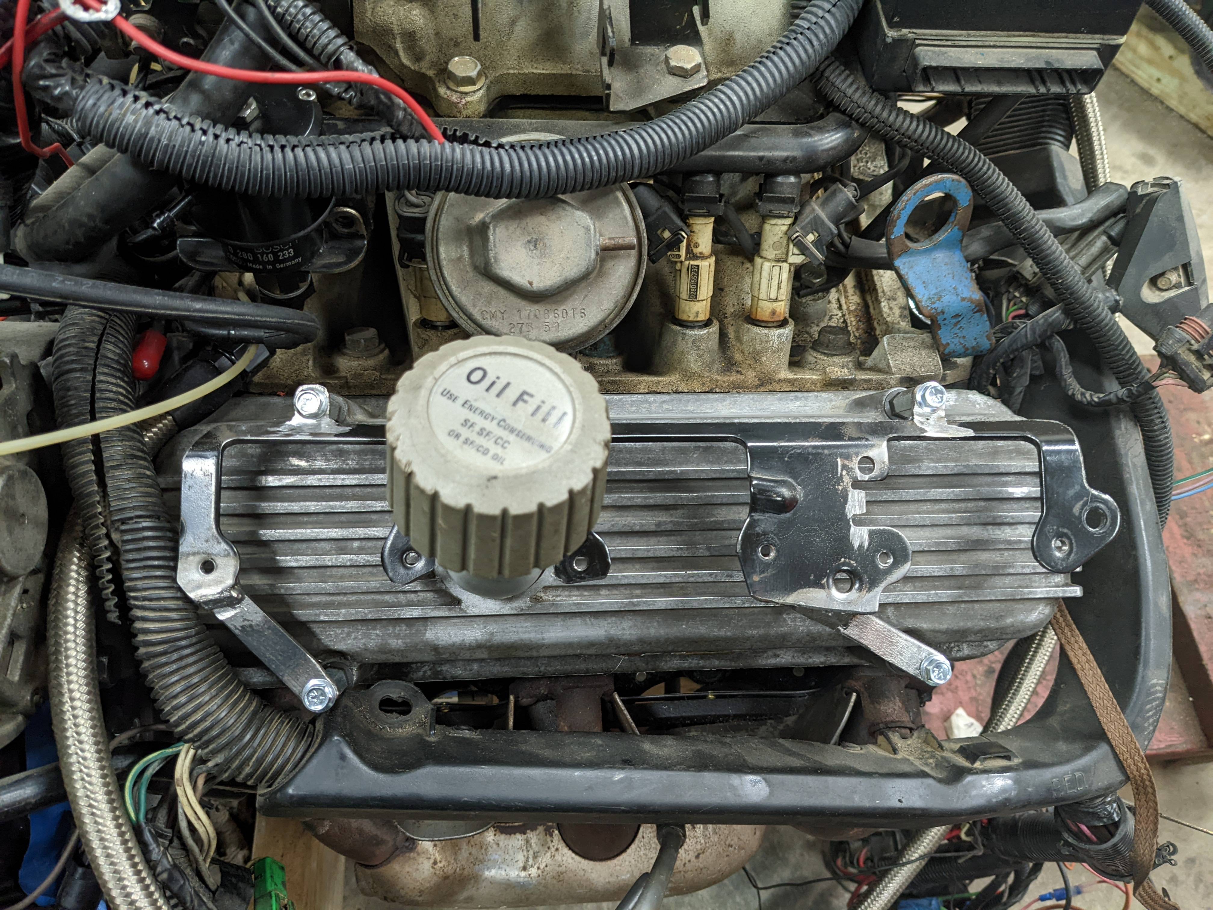

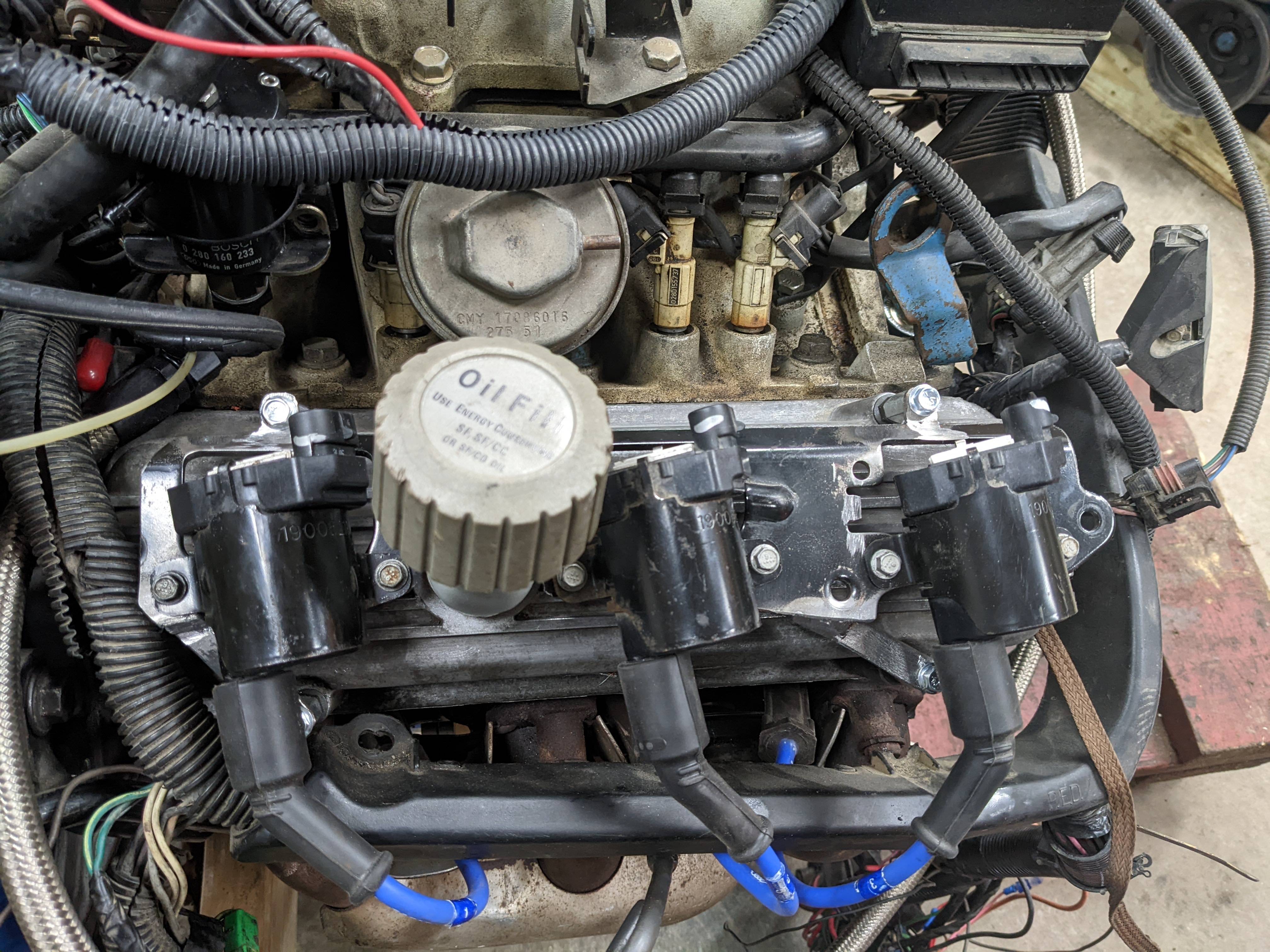

I did the LS coil conversion in '19 when I first got the engine running due to 3 ignition modules dying/being dead and 2 coils ohming out as bad.
Cheapest way forward that wasn't a high likelihood of blowing up another old NOS coil or module was to do the LS conversion. I just roughly put them in place on stock brackets slightly cut down and never got them mounted.
So I got the tabs welded on, welded the extra holes shut and cut off the extra tabs. I'm pretty happy. They aren't as good looking as billet but they came free on the coils and took maybe 2 hrs to modify so no complaints. Just need to shoot some paint.

Knocked another long term 'around to it' project off the list

Like the brackets, I went right into my valve covers. Work of Cation though, I was real close to the A/C box so my Passenger side coils are much closer, and forward, than the drivers side. But I suppose you were already running these so you know your location is good.

Coils are mounted

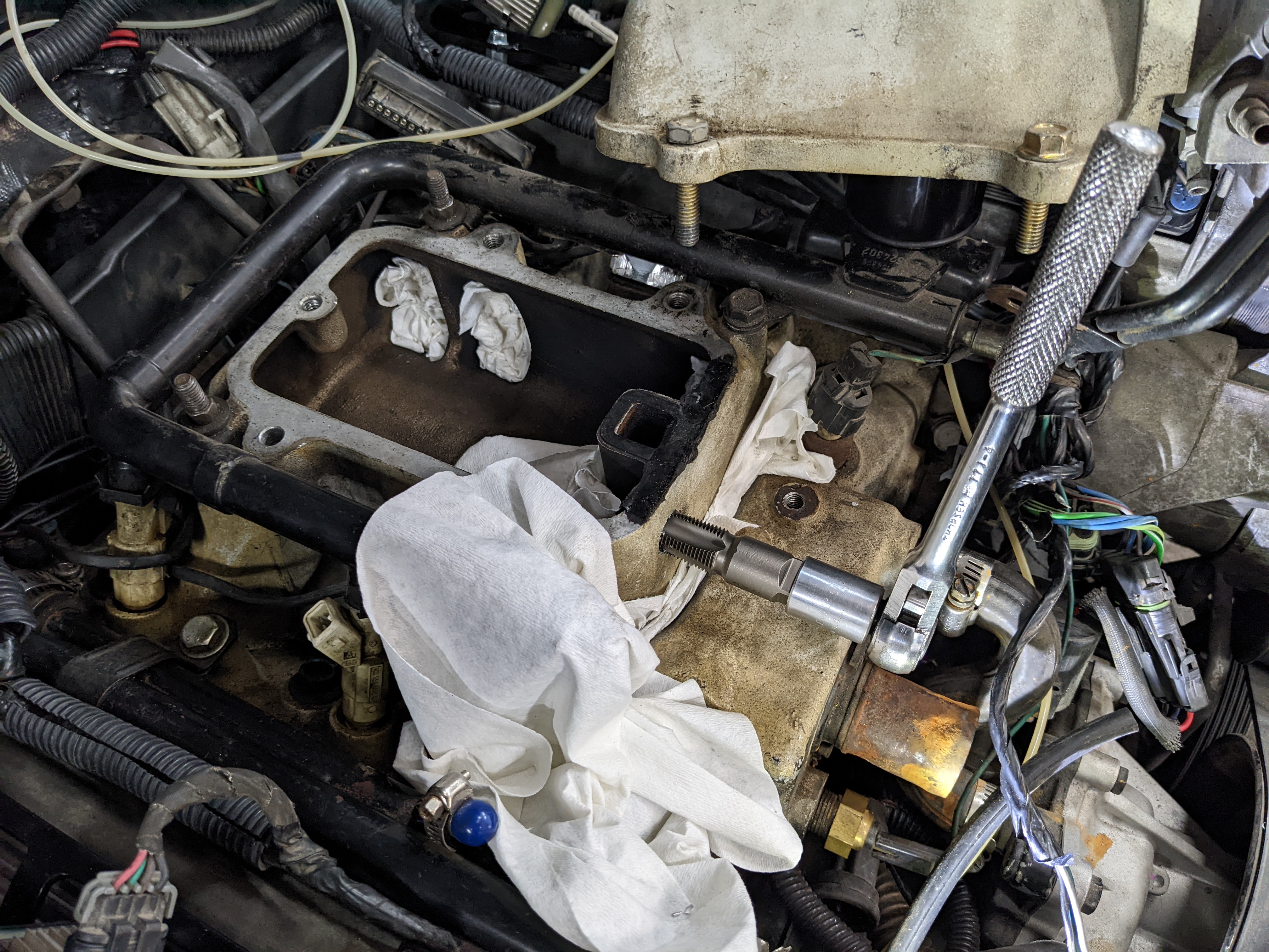

Was all ready to put the fender back on but realized I forgot to relocate the IAT from the intake tube pre turbo to in the intake manifold post cooler. Correcting the sins of GM engineers past.
Had to disassemble half the intake, drill and tap a 3/8 npt hole, disassemble part of the wiring harness and reroute the pigtail to reach the intake manifold location. Also hung the turbo since it's really easy with the fender off.
