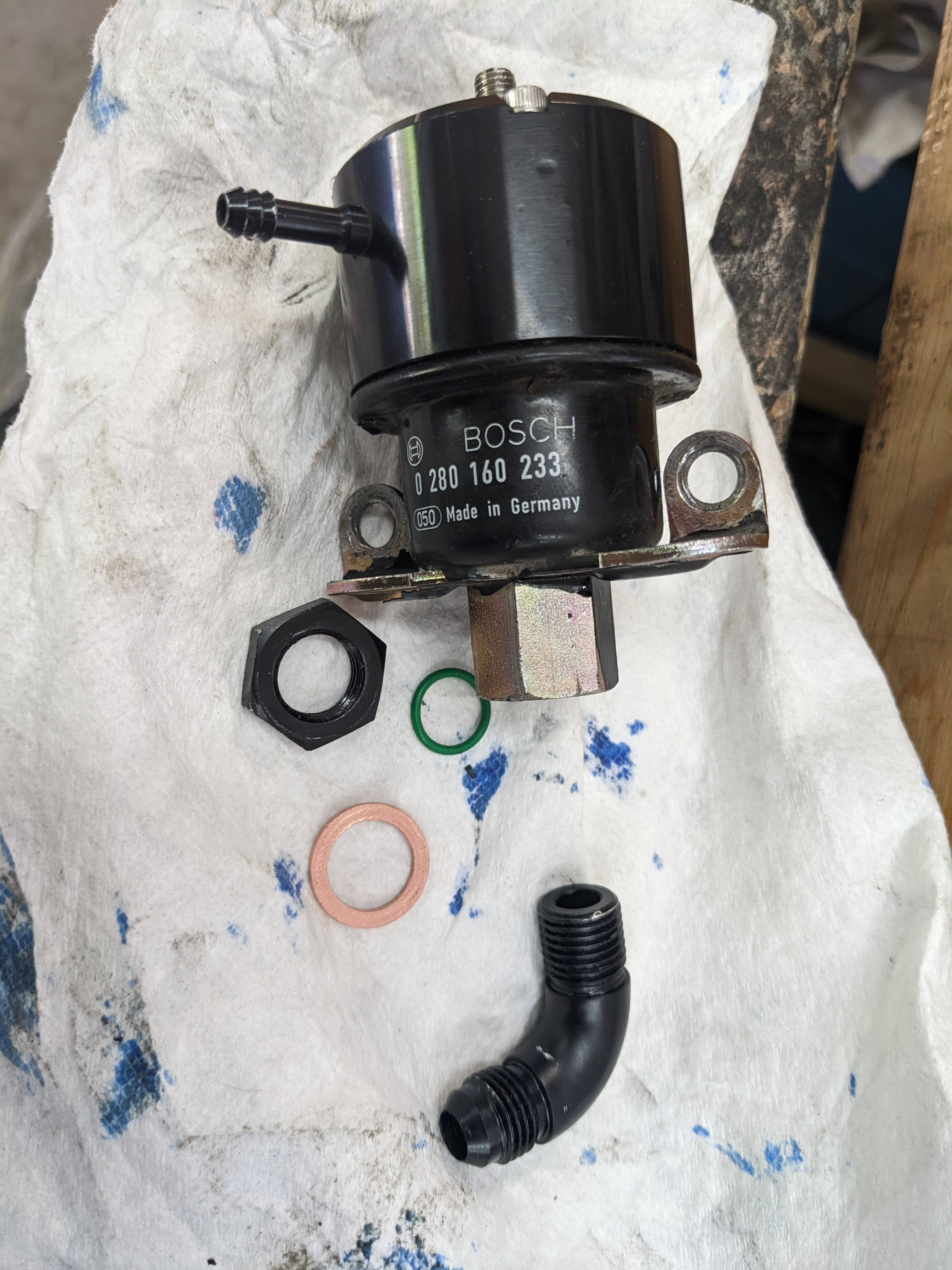

Messed with fuel leaks for the morning. Bought the racetronix regulator 90° fitting but design error, there's no seal on the thread so the fuel just leaks past the theads. I jammed an injector o-ring between the fitting and the regulator internally and it fixed the issue but I'm not a huge fan so I might revisit it.

Seal the jam nut to the body, don't seal the thread to the nut. Maybe I'm missing something?
