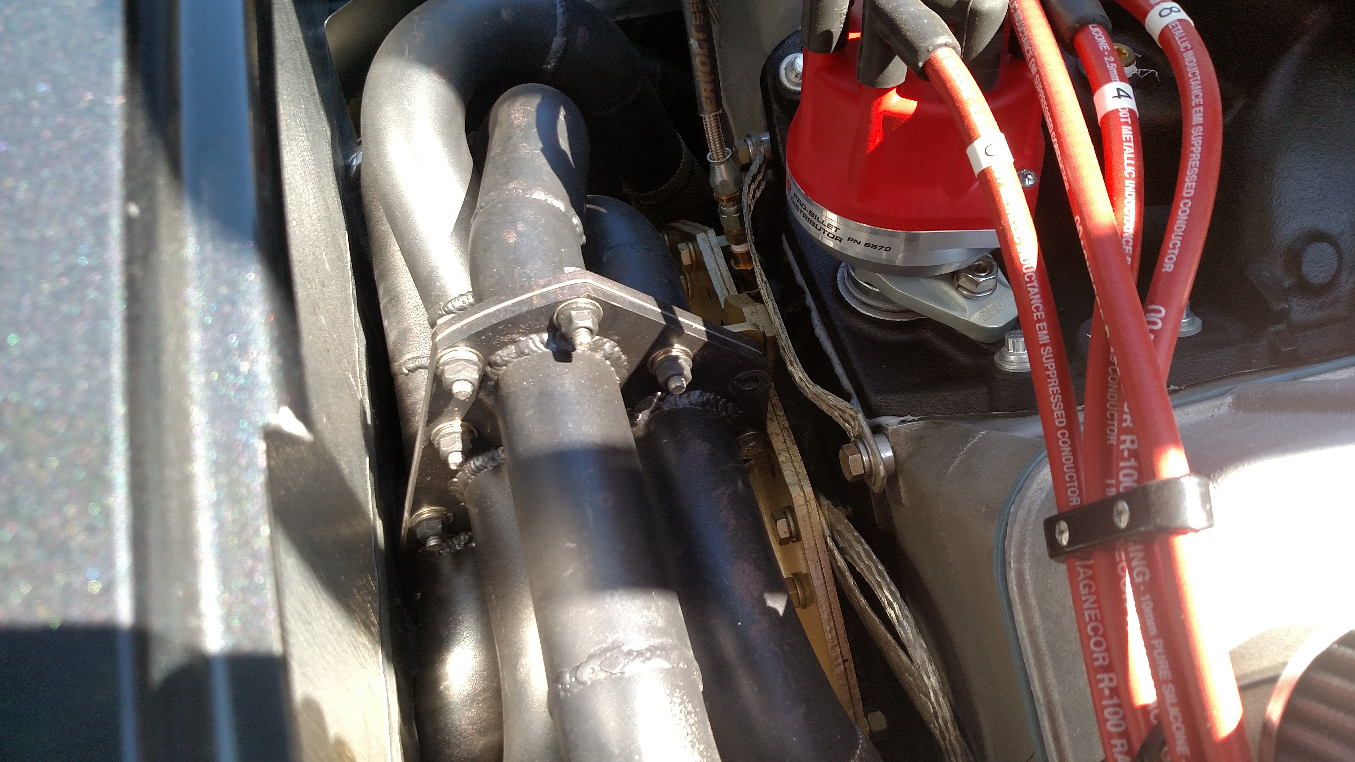

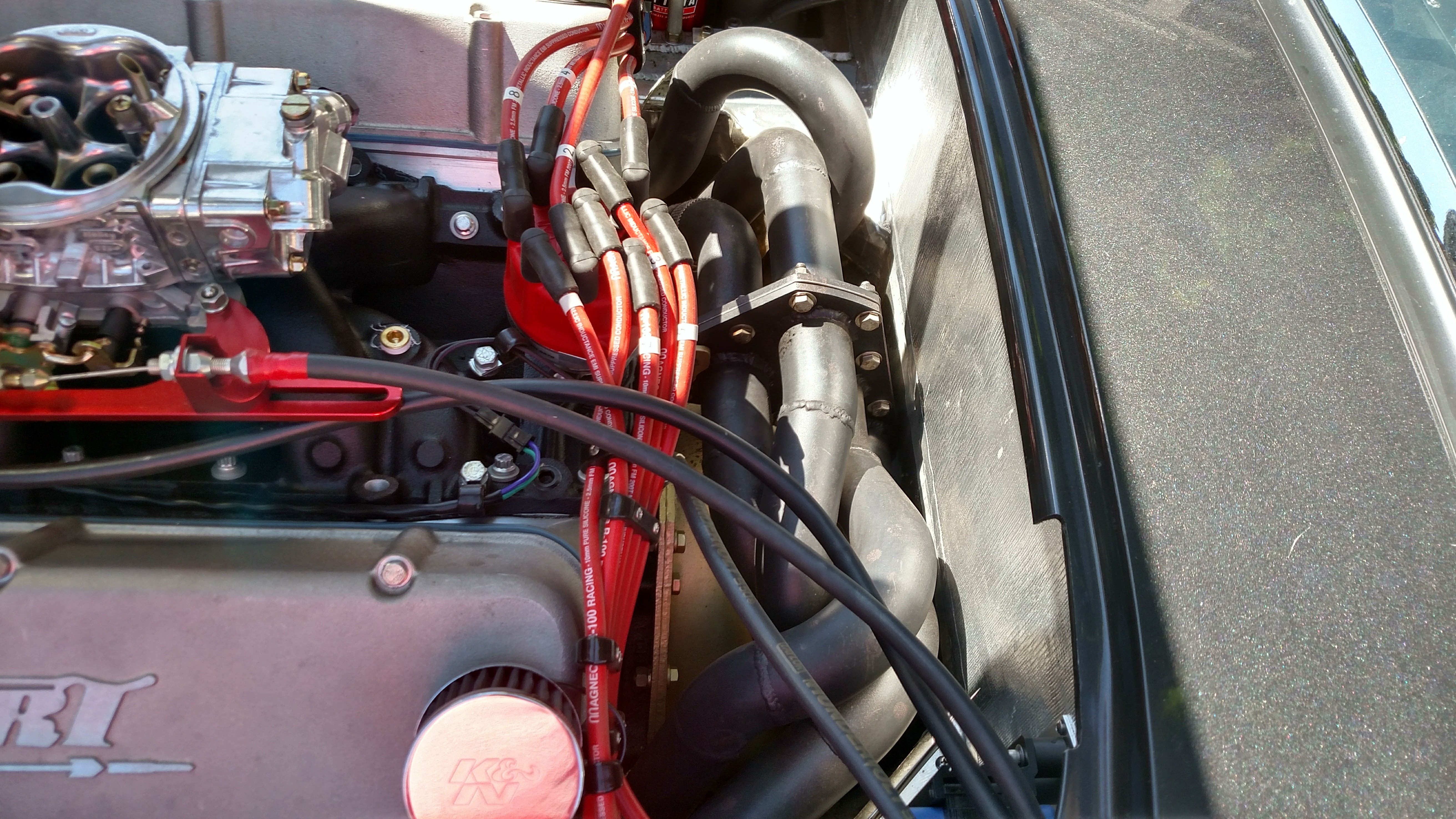

anyone ever hear 8 into 1 headers in person or know info about.
View attachment 98970View attachment 98971View attachment 98972View attachment 98973

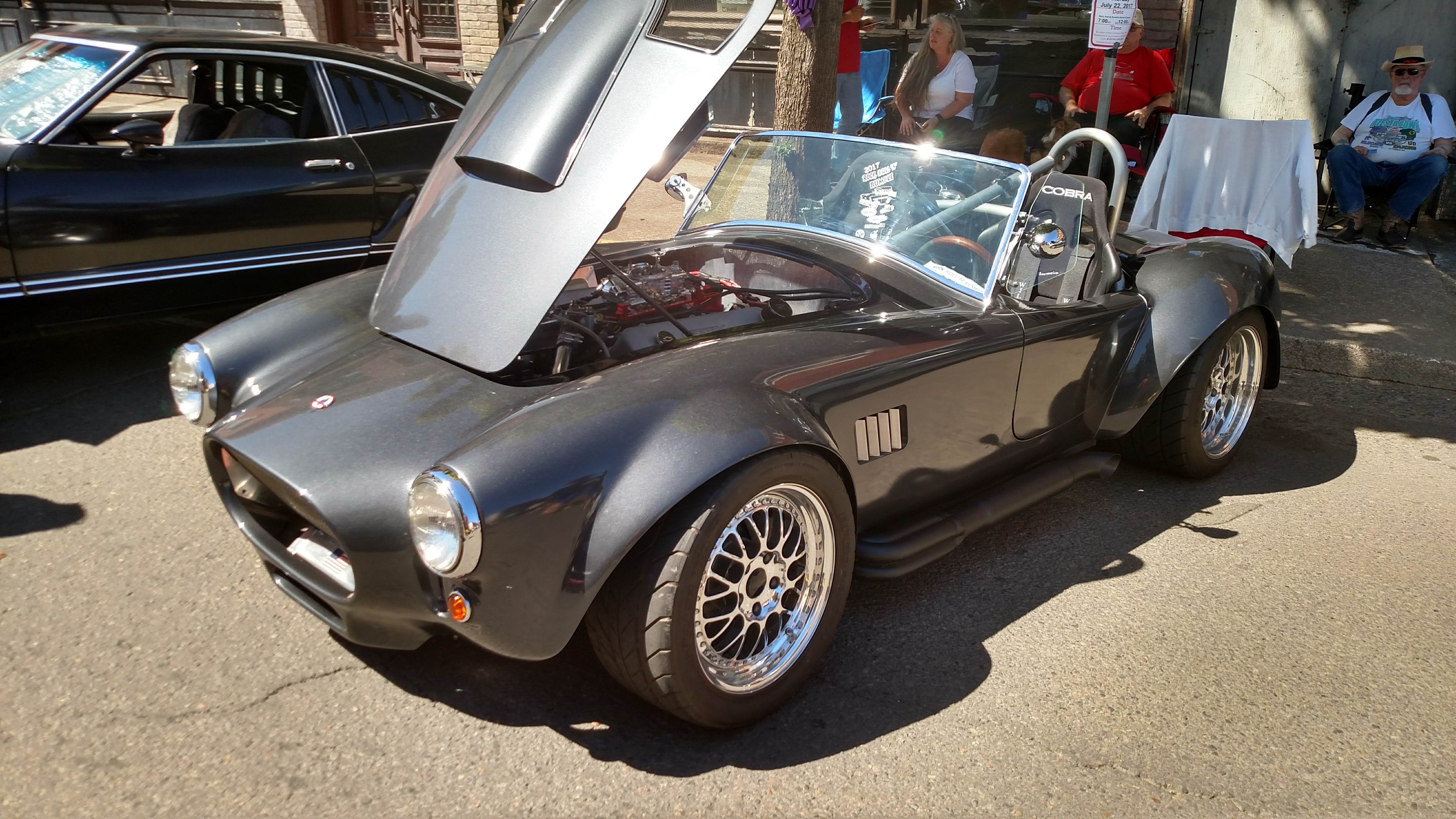

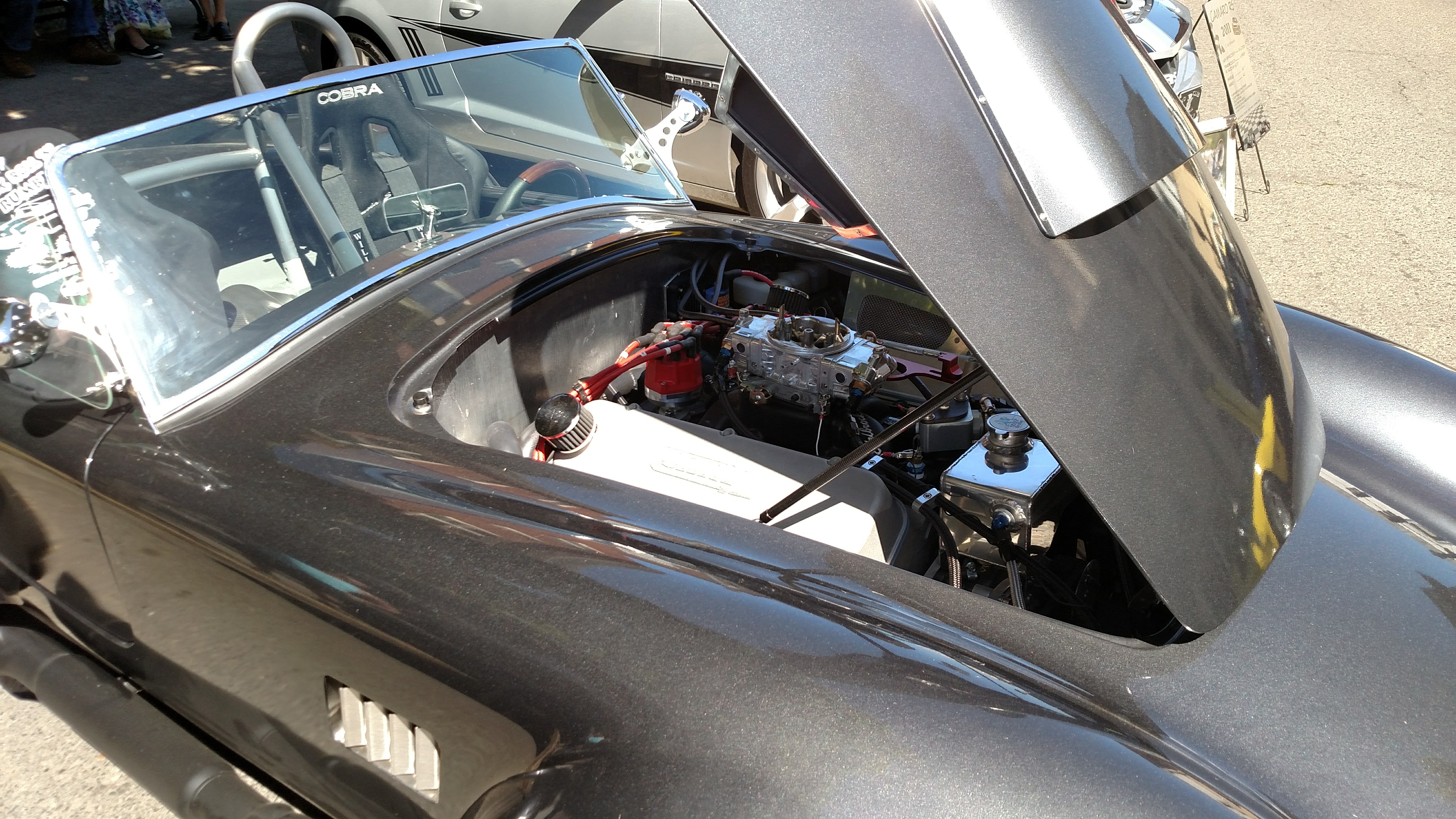

Ran across this at a car show South of Eugene Oregon a couple years ago. Built up aluminum BBC with these wild headers shoehorned in there. Sounded wicked. Dude said it made 750ish horsepower. Wild ride in that coffin car.
Not much on fake Cobras, especially with Chevy motors, especially a big block, BUT I am very intrigued by the exhaust.
If he managed to squeeze some 180s in there with a big block, I'm impressed to say the least.
