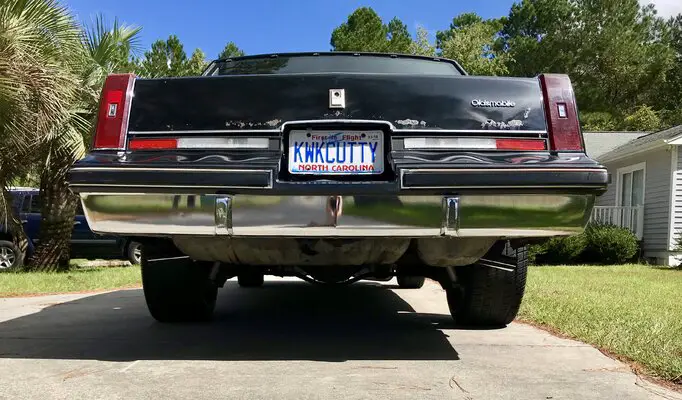

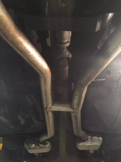

It'll fit. I think all the basics have been covered here. Yes, the Jegs kit exits out the back like a stock monte carlo would. You can cut this kit off at the last bend so it will exit behind the rear tires like a GN or 442.
You can see where the exhaust is cut here.
I also added an H pipe, the kit has no balance tube.
For the money its actually a decent kit. Everything is mandrel bend, and the piping is of decent quality. The only real gripe I have is the hangers that it comes with suck. They will probably break, I recommend replacing them with something a little more robust. Its pretty easy to change the mufflers out if you'd like.
Inquiring minds want to know. I can't see the cut in your image set. Is it in front of the axle? I have two of these kits, and I want to them to end up out the sides like yours.
Kwik_Cutty88
Moderator
Moderator
Nov 22, 2011
1,173
661
Coastal North Carolina
I cut the pipe right before it makes the last bend to go straight. Hope this makes sense.
