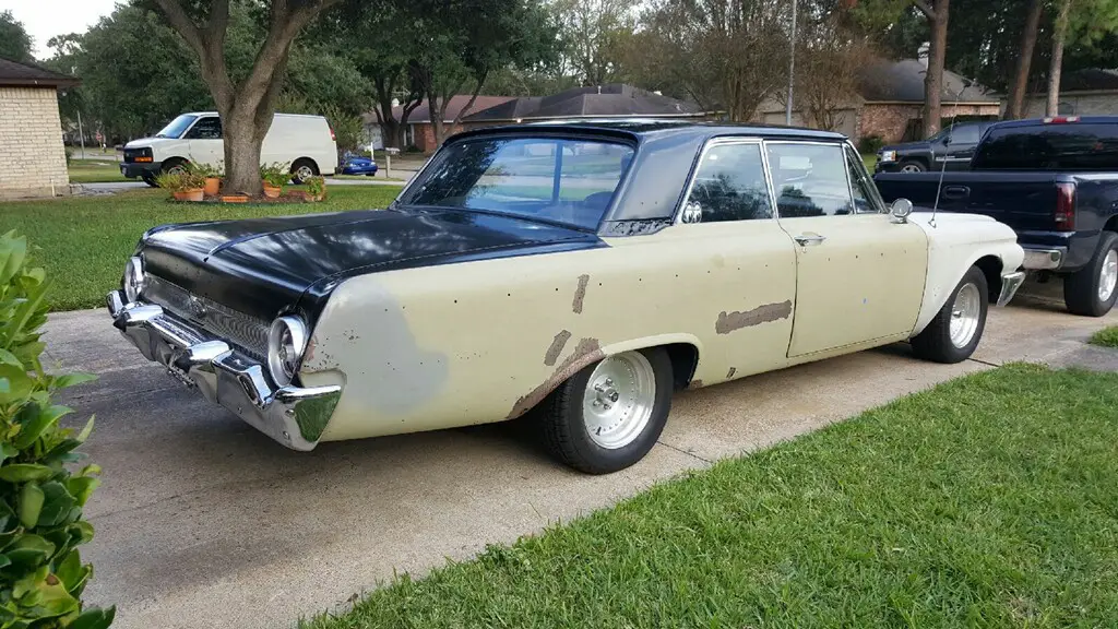

Dad's 62 Ford Galaxie

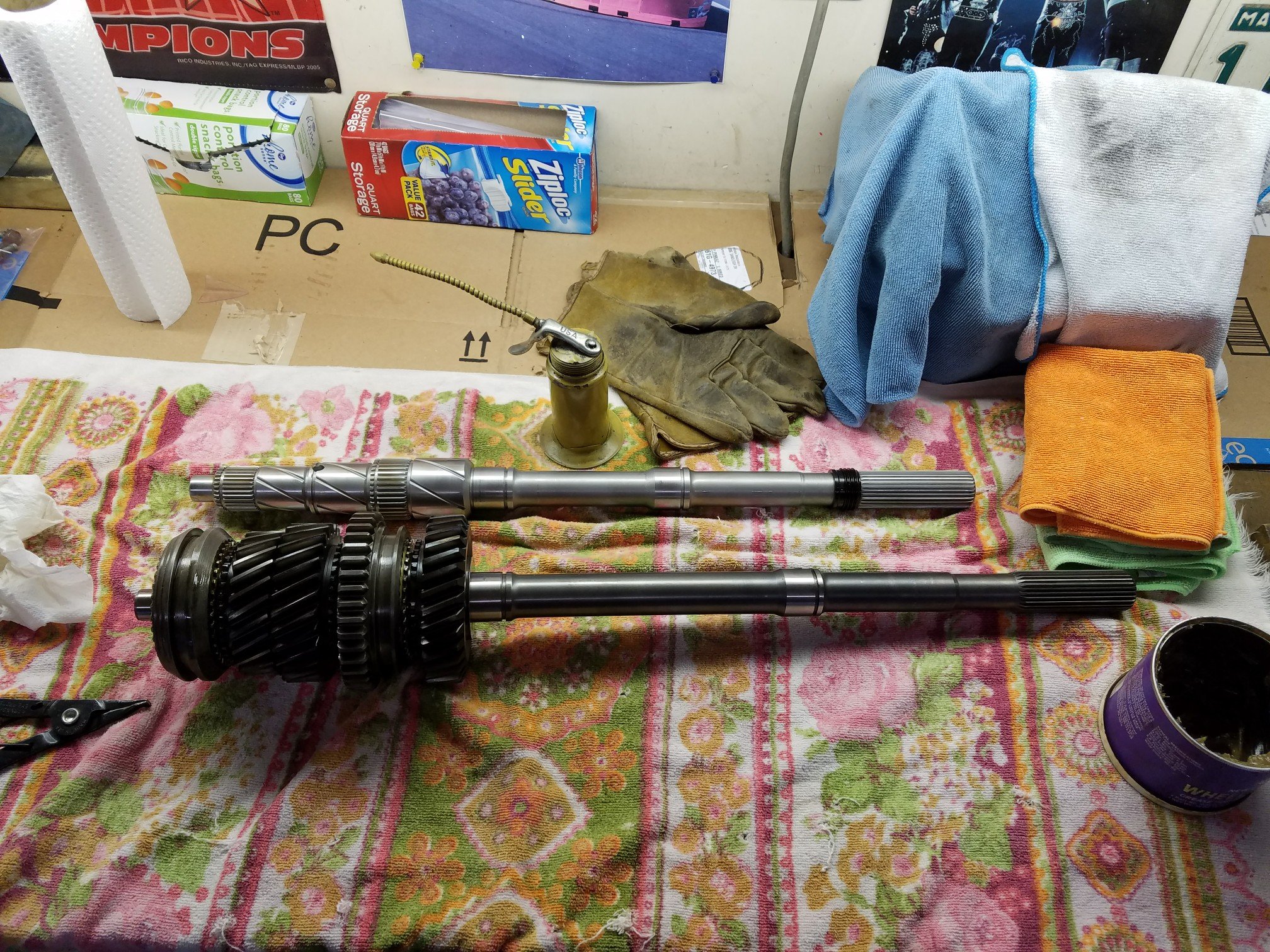

Meanwhile I've been working on the toploader after work this week. Monday night I finished the clean up and scraping on the case. I also got the needle bearings back in order in the counter shaft and installed a dummy shaft in it to hold them in place. I got the countershaft back in the case with the thrust washers and also got the gear train swapped over to the long shaft.

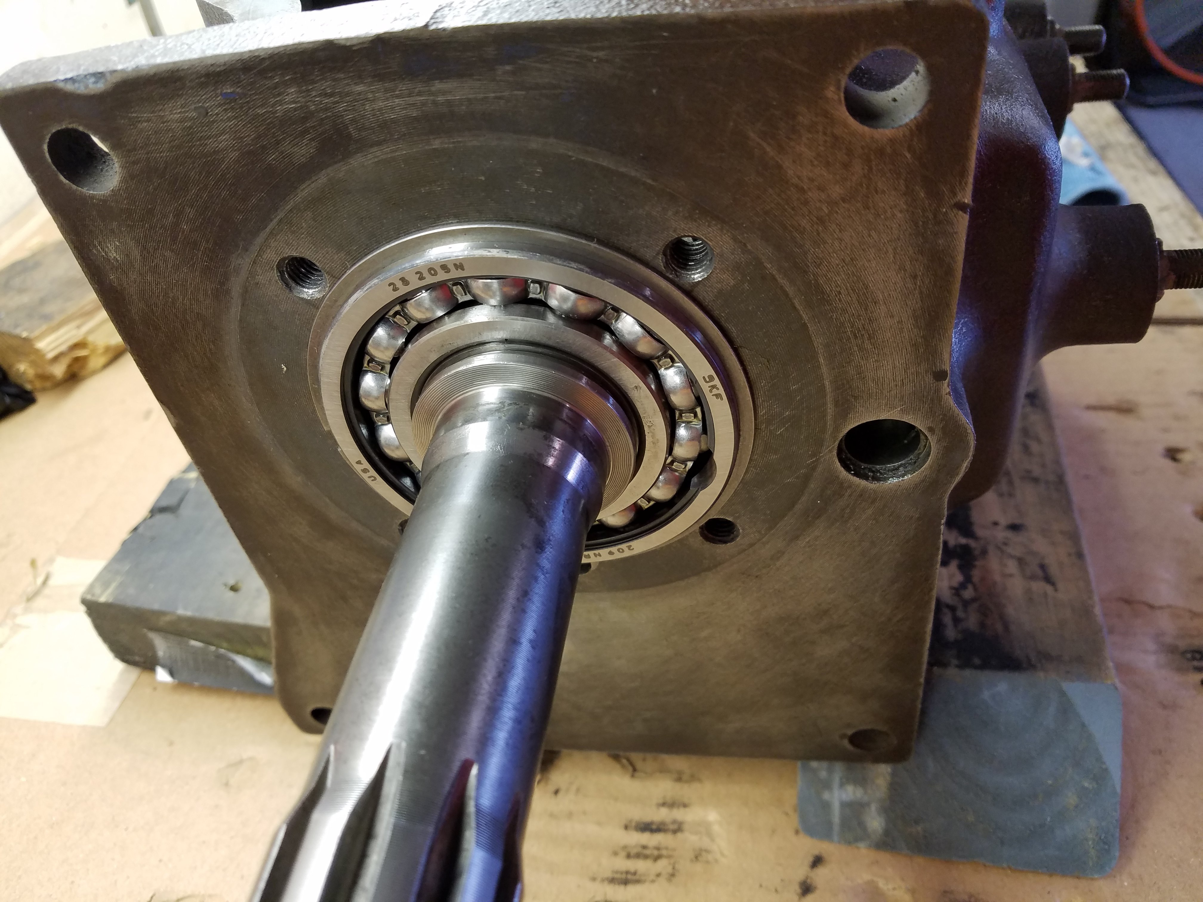

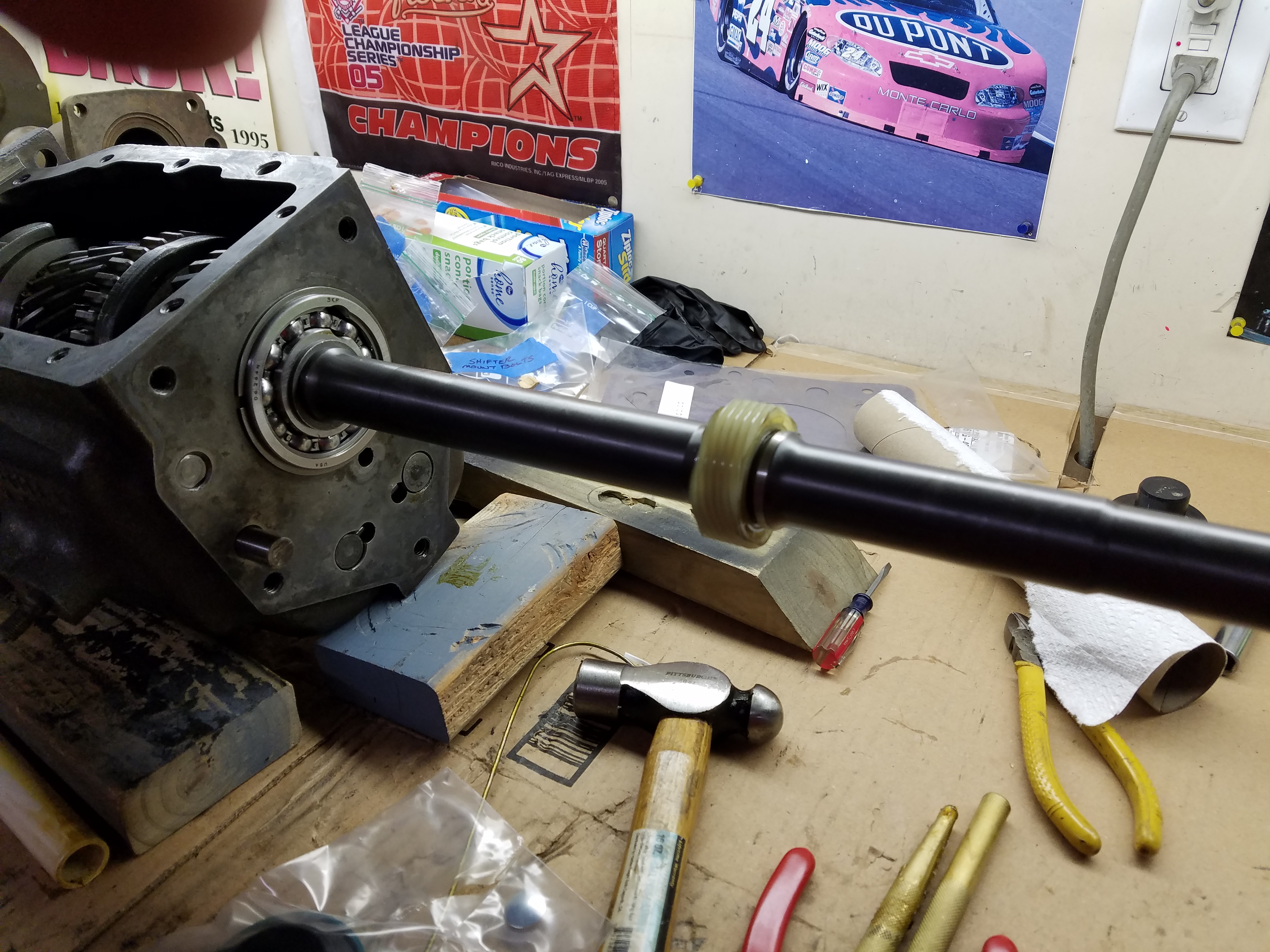

Tuesday night, with my brother's help, I got the mainshaft and gear train back in the case, then got the shift forks and rails installed. We also got the front bearing support, tailhousing and big input shaft cleaned up. Wednesday night we pressed off the bearing on the input shaft using my new OTC 2"-9" bearing splitter (bad boy). We got the new bearing pressed on the input shaft and a new bearing pressed on the main shaft and got the input shaft installed. It was pretty close at this point...
Thursday night we didn't work on it. I took a partial day of vacation today and got it buttoned up. It went together real nice. Shifts like a dream. It is going to be a really nice gearbox for someone....

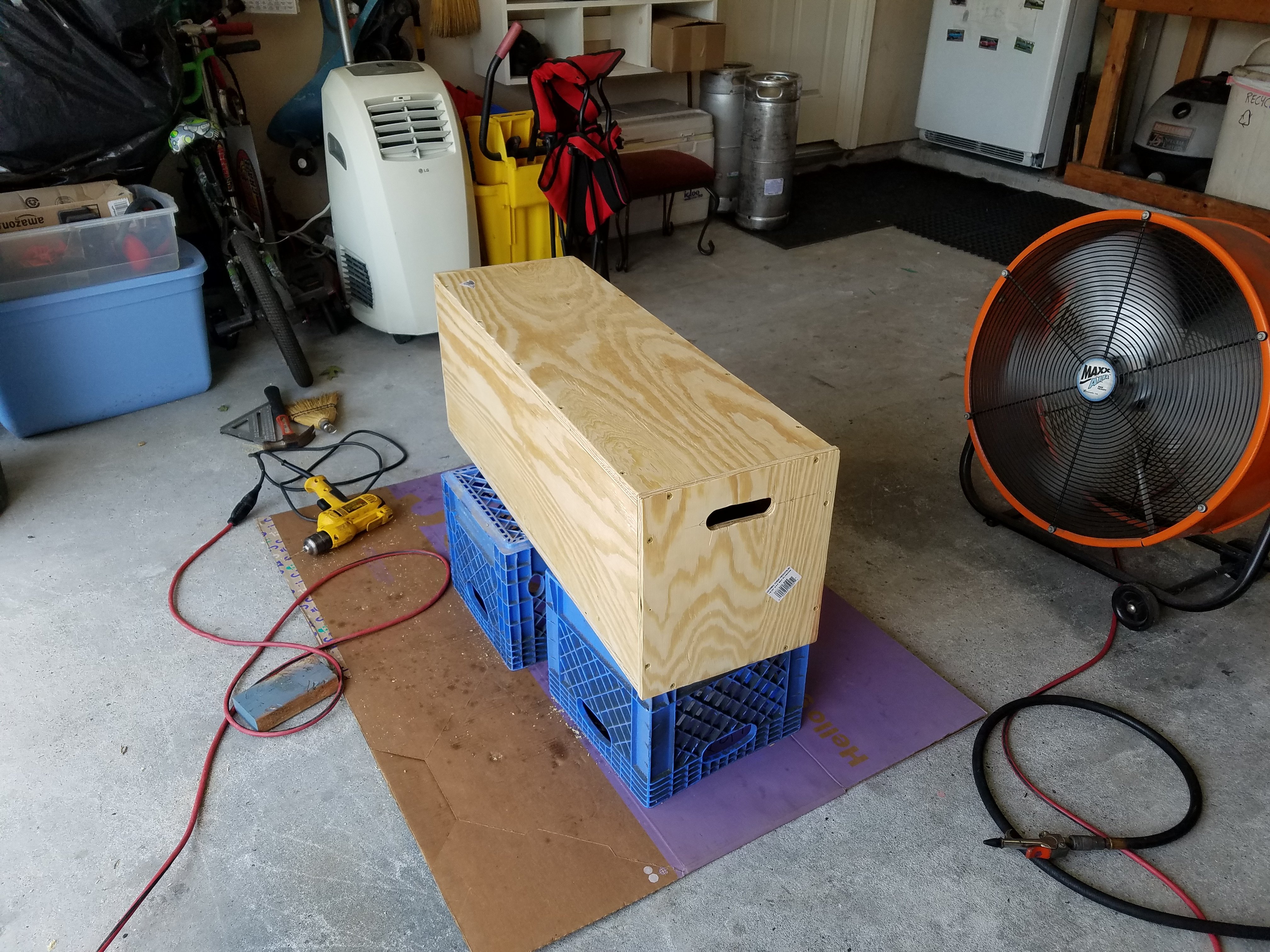

Tomorrow morning I will build the crate for it and will likely get it listed for sale online.

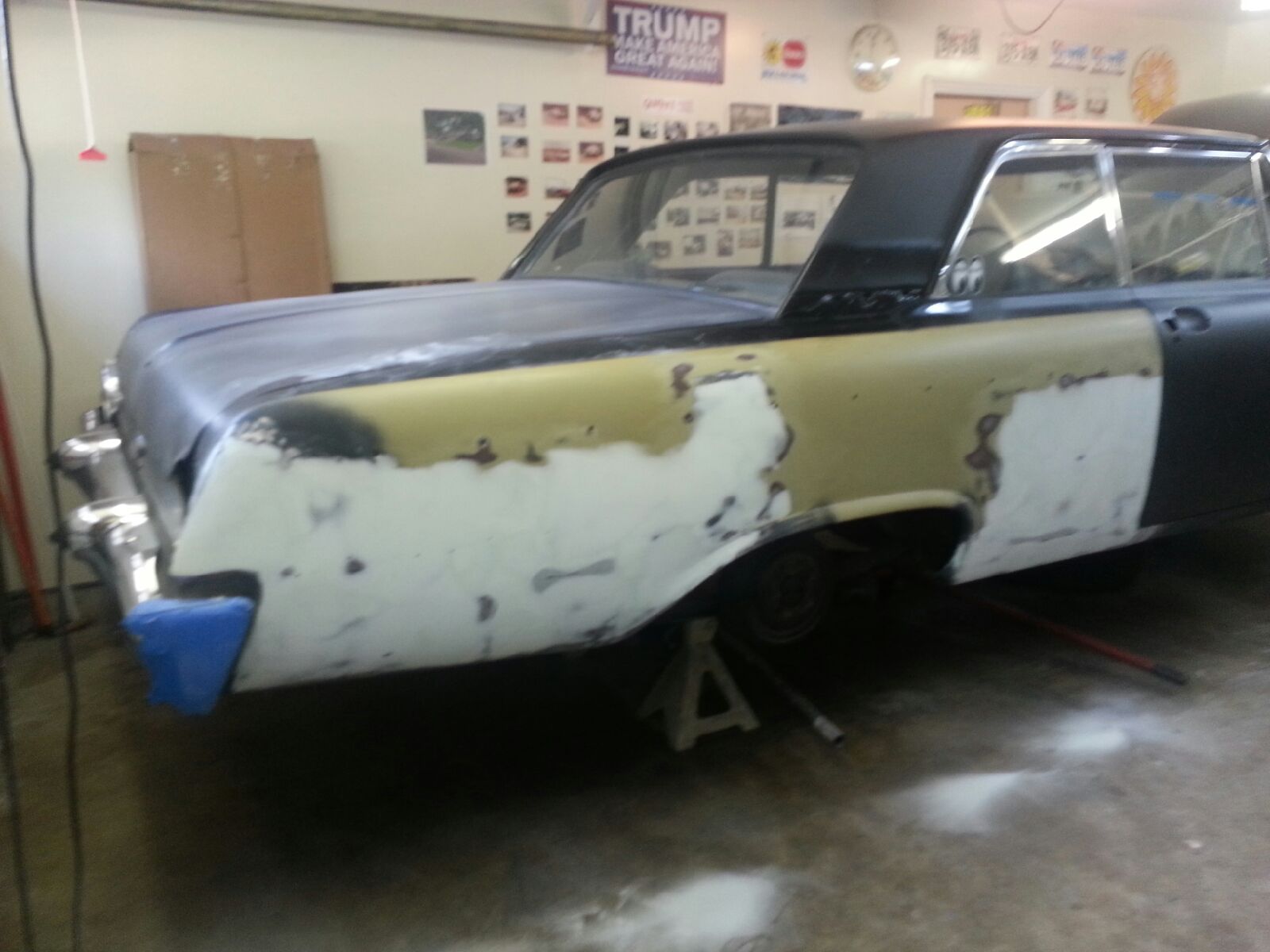

Work on the Galaxie continues. Dad is semi-retired so he's been doing some body work this week. Here are a couple of pics. This was earlier this week....
His comment was 'the hand is pretty happy' referring to it feeling pretty smooth to the hand. He sent this next pic earlier this afternoon with the message 'getting smoother'.

Progress on the Galaxie continues. I got the trans I've been working on crated up. I'm not a wood guy but it turned out ok. 137 pounds all together....

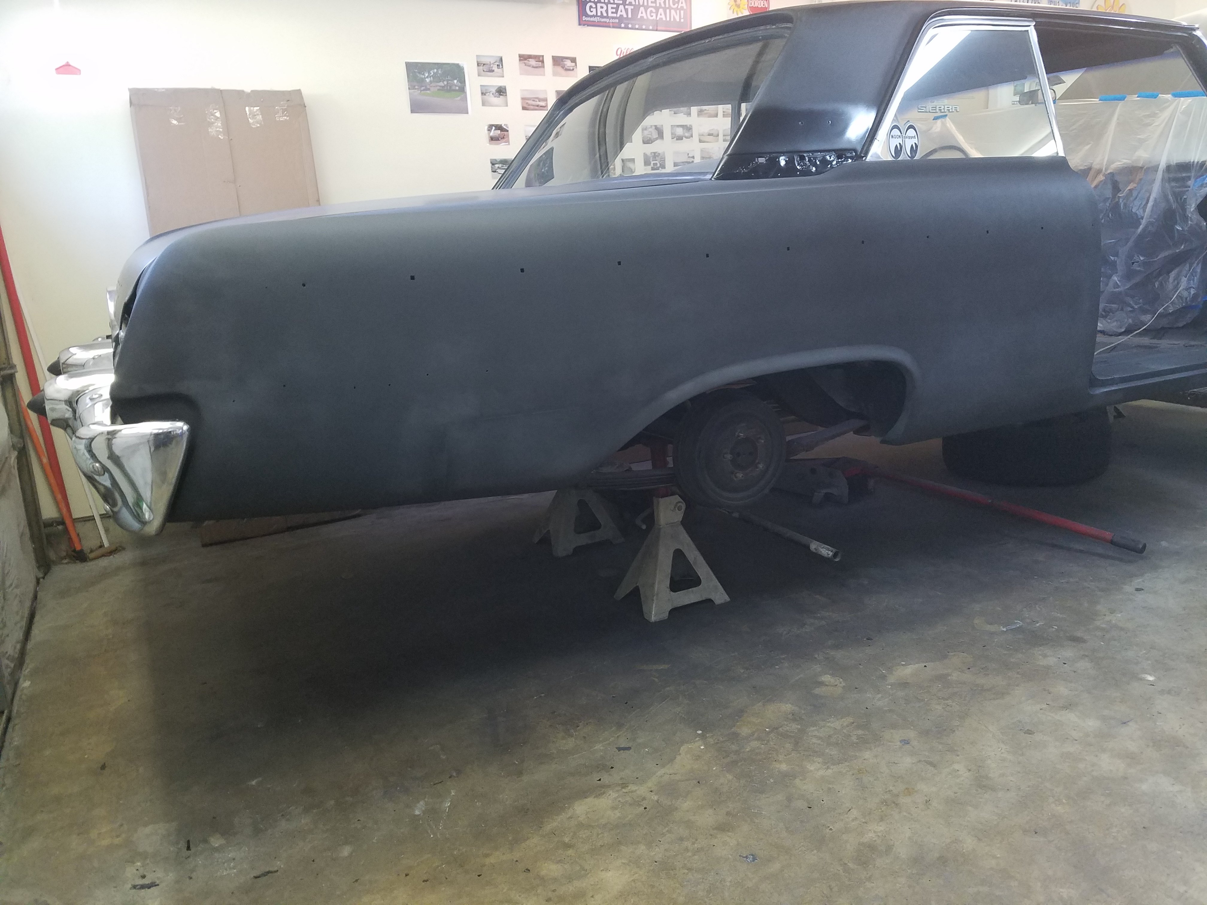

I finished up at about 3 and it was about 93° and humid so I was over being outside. I decided to grab a shower and then head to dad's to see how he and Sean were doing. Sean sent me this pic before I got there with the car taped up.....
I was surprised they were at this point. The metal work on this side turned out better and required less bodywork. Add that to all the work dad put into it this week and here it is in primer.....
It's come a long way from this.....

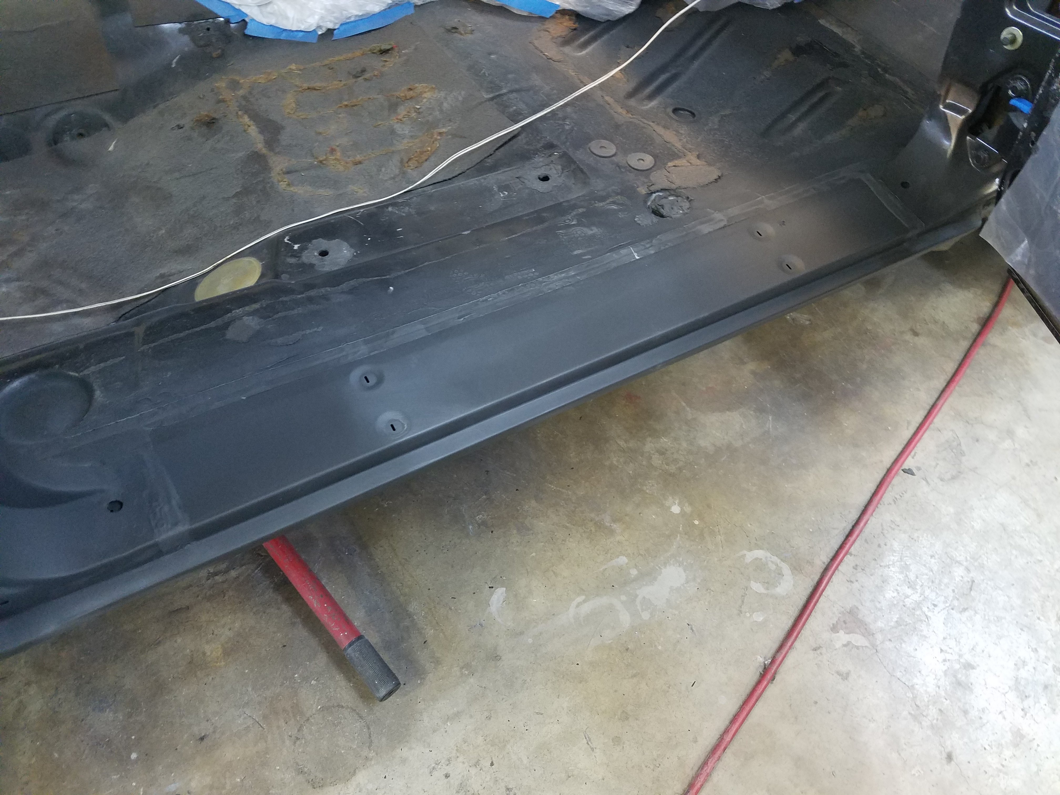

Here's a look at the rocker primed and seam sealed.....

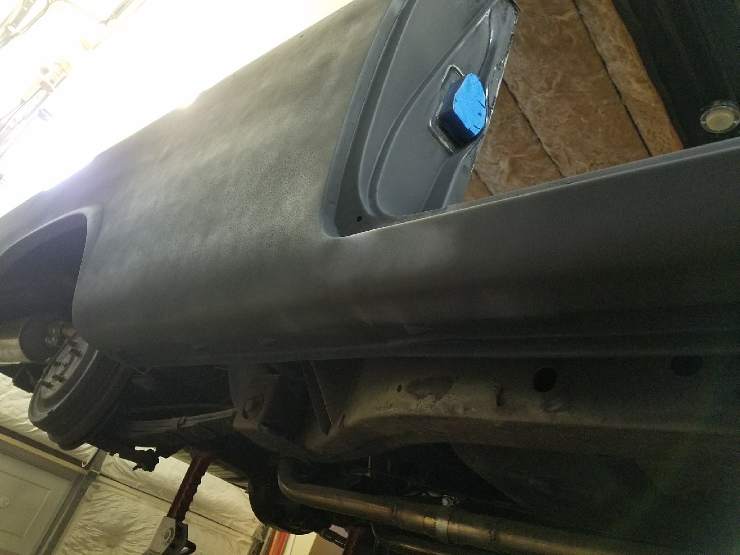

And here's a look at the bottom of the rocker/quarter showing the filled seam and the drains we fabbed....
The primer didn't flow out that well. I'm not sure what was wrong but it went on a little rough. Dad ran a piece of 220 sand paper over the whole panel and slicked it out in about 10 minutes. I don't seem to have a pic of that. They still have to prime and paint the backside of the inner rocker and trunk drop off where we welded in the new metal. They also need to touch up the wheelhouse and then dad is going to undercoat it. Dad is also going to touch up the paint on the outside of the frame rail where he got yellow epoxy primer overspray on it. We are all so glad the yellow is gone. They are going to shoot the door jamb and cowl black and then the passenger front fender can go on. They'll be working on getting the passenger quarter in epoxy primer. Still plenty of work to be done but all the eye sores are gone. I think the car will be painted this year. We're excited.
There are crate engines but a crate transmission is a new one for me...😀

Was waiting on this week's galaxie installment...was worth the wait. Looking better and better every time. Great job so far. It's going to be a sweet ride when done! Trans crate looks very sturdy also.
