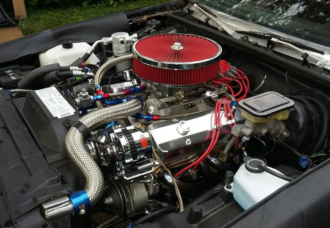

I just did this earlier this year with my 355 SBC install in my Regal that has a Holley and a 200R4.
