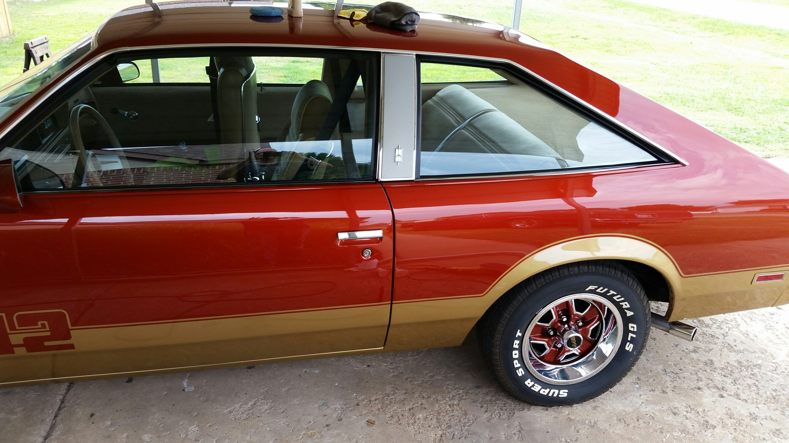

I resanded the deck lid this morning and got it buffed. Looks a lot better. Still a little lumpy but I can live with it. I'm doing panels at a time so my buffer has cool down time. Got ready to do the passengers door and quarter panel and it started raining like crazy
Got the passengers side buffed under the car port while it was raining. Had a couple bad spots I was not happy with in the paint. I got them sanded out and buffed. I'm pretty happy with the paint job now. It's not lazer straight but it looks good enough for a driver
