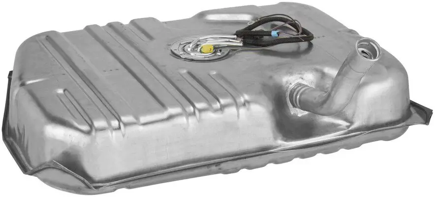

I would like to get away from the on engine mechanical fuel pump some time next year, run a return line back to the tank along with a return style fuel pressure regulator and set it up for 6psi max.
Tired of this 93/E10 mix perculation when hot nonsense when it comes to my ZZ4, i didnt go through any of this back in the mid 90s with my street/strip setup('75 chevelle), i know, much better gas back then, so this upgrade has to happen.
I had a lQQk around, and Rock Auto showed me a year specific unit for my malibu(1979), 17gal, with filler neck attached, in tank fuel pump, supply/return/vent tubes, its all i need to keep things simple, im already familar with the electricals, use heavy guage wiring, a heavy duty relay w/flyback diode, soldering connections, oil pressure switch, etc.
Spectra Premium GM306CFI - https://ecat.spectrapremium.com/en/parts/GM306CFI
Would this do me justice for my needs, or is there something better, this will be my first time upgrading any fuel system, ever.
Thanks

To save your pump, a baffled tank is best. RockAuto offers a Regal tank, 307C (does not call it a Grand National). $147. Monte SS tank, 306C, is $182 and has a slightly longer filler neck. Picture looks the same...

I guess the spectra tank i posted is just a stock tank, but with a in tank electric pump attachment but with no internal baffleing, no relateable info on the tank it seems. That MC gas tank lQQks more ideal, i'll just have to modify the filler tube length if indeed it is slightly longer and i'll also need the factory pump and lines assembly with electrical connections.
