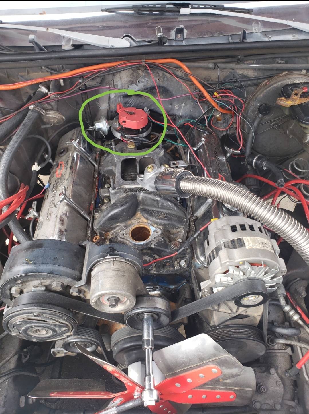

Backwards ?No the motor did not rotate while pushing it. Also your fan is installed incorrectly, right now it is just pushing air not scooping and pulling the air through the radiator.

You have a standard rotating fan on there right now. On a normal v belt drive the fan will spin the same direction as the crank (clockwise), but being that you have the serp set up on there the fan gets spun in the reverse direction (counterclockwise). If you look at the left side of your fan in your photos notice how to blade is not scooping the air as it would be rotating counterclockwise.Backwards ?

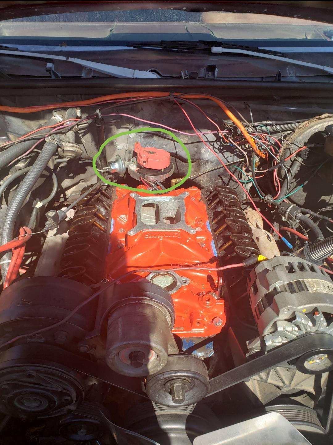

Maybe not when you pushed it but why is there a socket on that pulley bolt ? Did you try to turn the pulley ? Did that turn the crank as you did that ?I got the distributor back in exactly how I had it... View attachment 194492 View attachment 194493

Did the engine rotate when I pushed the car ?
Wasnt this discussed in the original thread ? SMHYou have a standard rotating fan on there right now. On a normal v belt drive the fan will spin the same direction as the crank (clockwise), but being that you have the serp set up on there the fan gets spun in the reverse direction (counterclockwise). If you look at the left side of your fan in your photos notice how to blade is not scooping the air as it would be rotating counterclockwise.
Here is the best photo I can find showing how the blades would be shaped on a counterclockwise fan:
vs what you have:
