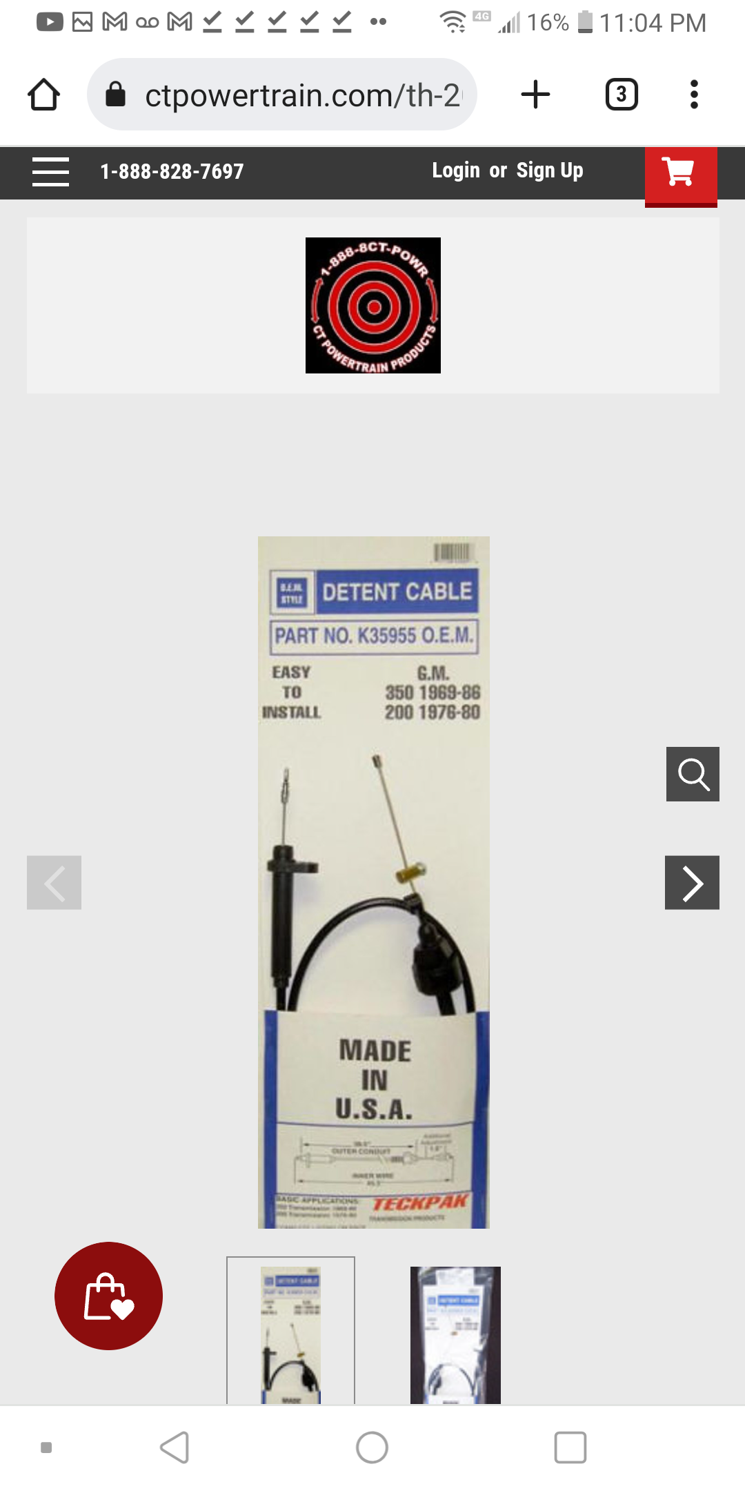

I think this is the one I need?
Pioneer Automatic Transmission Cable Detent CA-1937​
Can anyone concur?
There is this style and another style that has a slot instead they both say they will fit my car but does anyone know which one will work best for my car I can't see what kind it had on it because the cable is broke right at the bracket so the wire tip is gone thank you everyone for your help I appreciate it
Pioneer Inc. Detent Cable - CA1980​
78Delta88
May 23, 2022
437
SW Arizona
There are several I found this one on CTPowertrain
