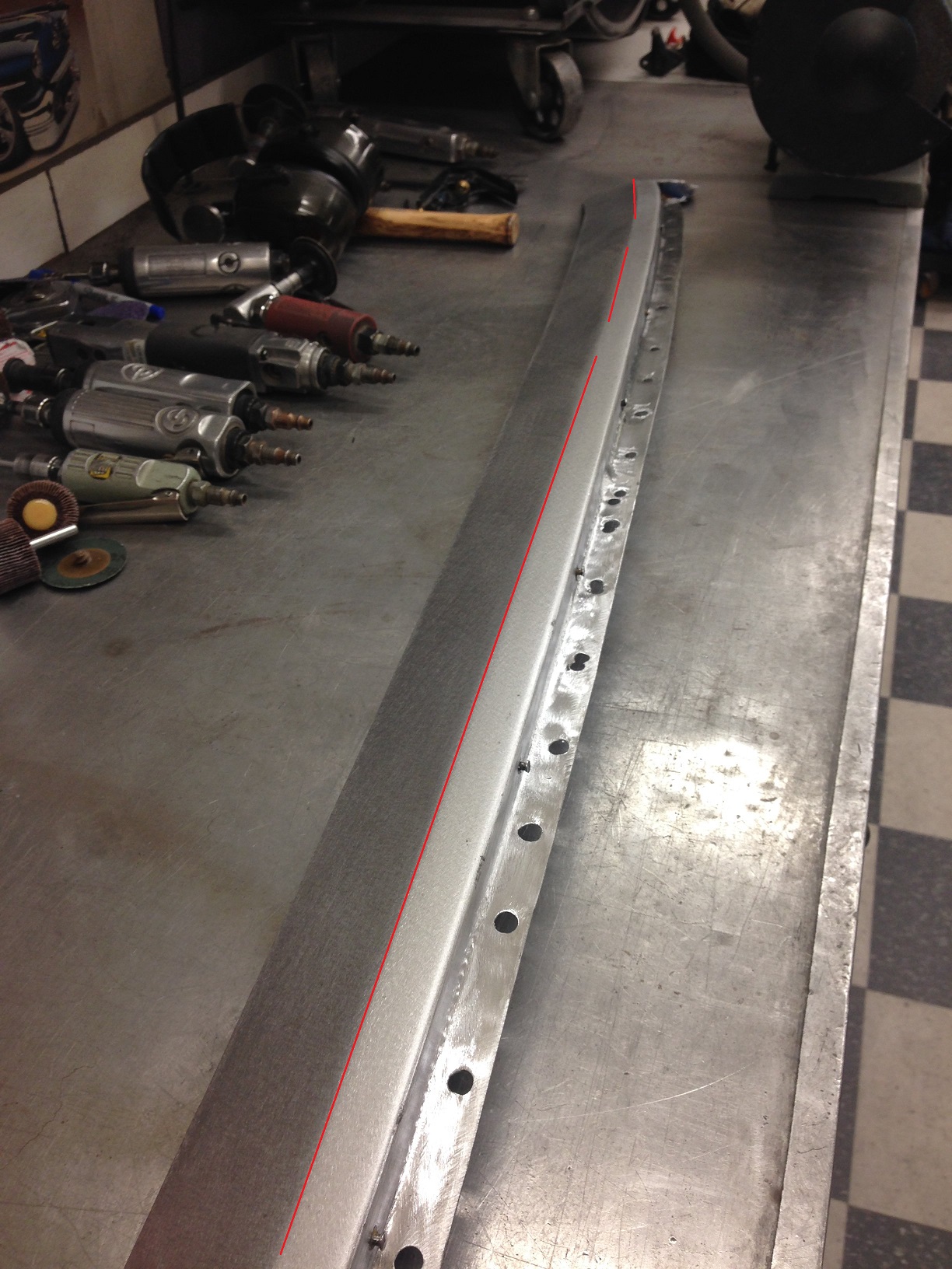

I did get several free hours to work out in the garage today, so I spent my time concentrating on preparing the new piece for installation.
Surprisingly, it took the better part of the day. The areas where the outer skin meets the "A" pillars is pretty complex, there's a lot of different parts that all overlap and attach there.
I started by trimming down the sections of "A" pillars just below these attaching points. From there I shortened up the outer skin a couple inches up from the body line and made it uniform.
With that done, I fired up the propane torch and melted out the lead from the roof to "A" pillar seams. If you're doing something similar to this at home, this is the proper way to remove the lead from these areas.
DO NOT sand or grind the lead, as we all know it's toxic and you don't want it airborne.
The lead they used has a low melting point, a little heat from a propane torch is all that's needed to melt it out.
With the lead removed, I was able to get a bit clearer idea of how the different panels were attached. I had to grind and cut through the brass brazed areas at each end inside the channel, and then a couple of careful cuts were placed to separate the channel and skin section from the rest of the structure. This is easier described than accomplished!
This left just the spot welds along the flange to drill out and separate. Drilling out spot welds I find a very frustrating endeavour. It seems no matter how carefully I look, feel, and estimate where the exact center of the weld is, I usually seem to miss at least a little bit of it.
After redrilling a few that I missed edges on, and one or two completely hidden ones, I finally got the section I wanted out. After spending more time cleaning up edges, hammer and dollying the flange flat again, and numerous other areas that needed attention, I had the replacement section cleaned up and ready to go.
There's not really much worthy of pics here, but here's a couple anyways:
It's still purposely cut oversize until I figure out the final plan of attack, but it's always easier to trim more off than add it back on.
Tonight after work I will concentrate on cleaning up the existing channel on the car a bit more and see if I can at least utilize the top 1/2" or even 1/4" below the roof edge or so. If I can, I think I will be able to keep the repair confined to the channel area, which I think would yield the best outcome.
I'll report back here tomorrow night with my findings, and we'll see if I'm any closer to a resolution.

Can you cut the original roof back to the point shown in red and slip this up under? Cut it in half in the middle to make insertion easier?
By the way, I dig your Surgery...the die grinder on the left is identical to my old favorite that recently gave out after 20 years of hard use.
Thanks for the clarification and suggestion Quinn. I really appreciate it.
I can certainly do that, in fact I think that's going to be "Plan B". I'm going to shoot for "Plan A" first (see tonight's update), but if Plan A doesn't pan out, that'll be my backup alternative. The idea of cutting the new piece in half to make it easier to work with is great, I may end up having to do that.
