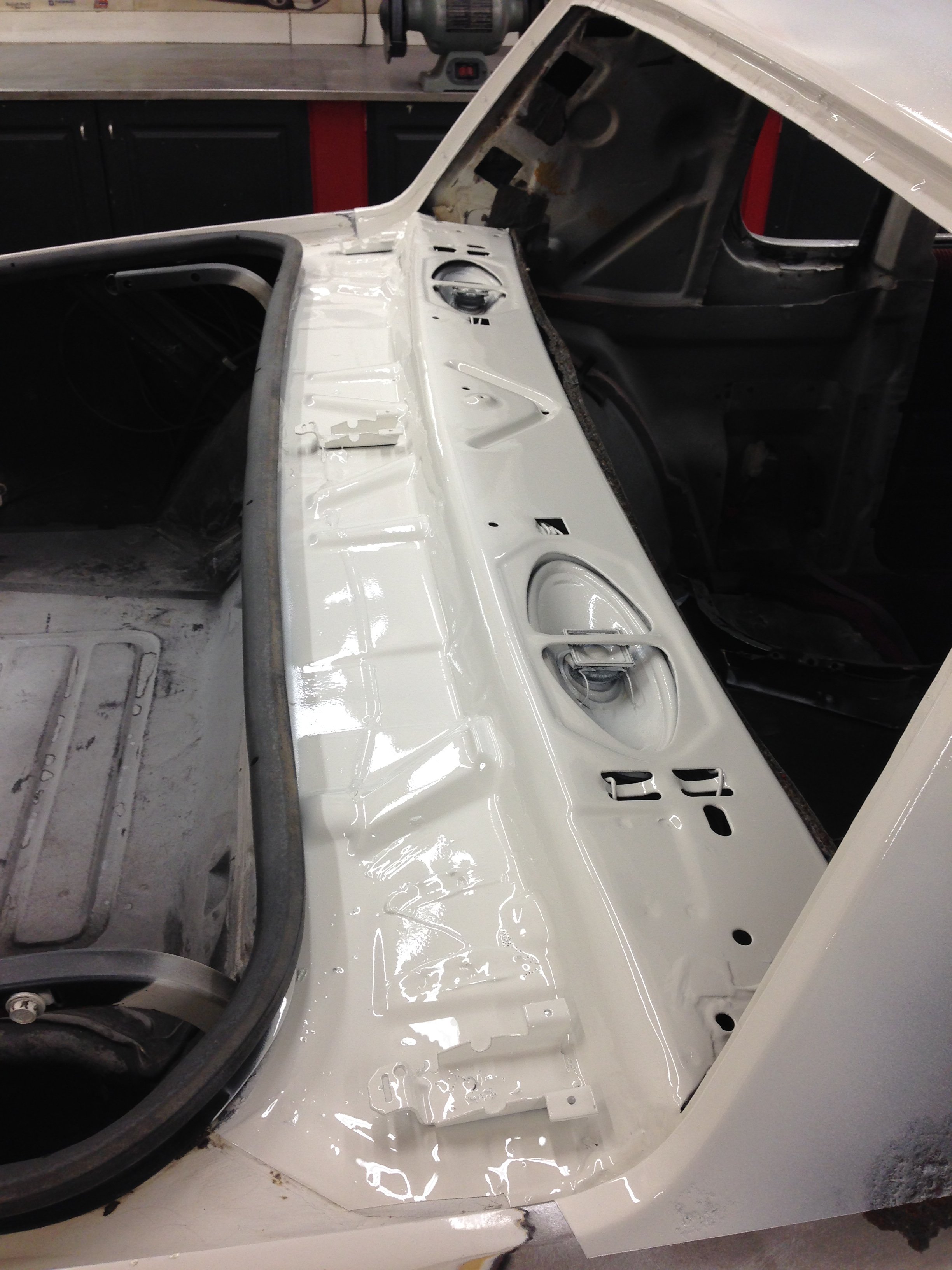

Amazing skills bro. I am about to purchase a 83 cutlass diesel that I am converting to ls power but i noticed it has some rust. what is the name of the panel shown below. I have the panel with the speakers is the rear seat divider or package panel but i cant seem to find the name for the panel that has the trunk weather strip attached. Im located in the bahamas and just want to take on a project car
