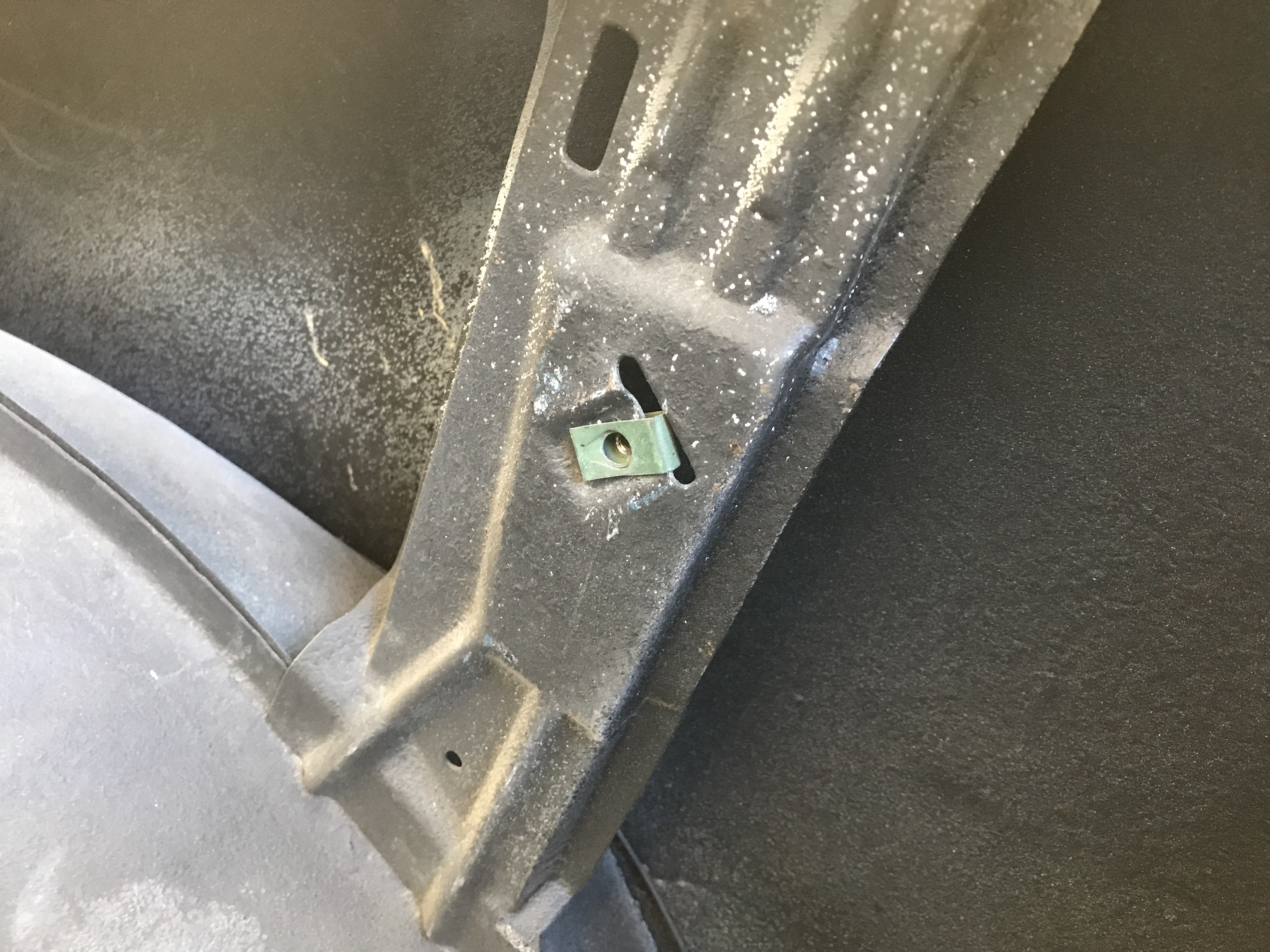

I used it as a reference to my car several times, and several things became perfectly clear almost immediately - the trunk braces, mounting points and attachment methods are quite different between my “A” body and the “G” bodies even though they look similar.
The attachment point on the trunk brace on your GP is noticeably lower than on mine...
...which causes an interference issue with how the front of the jack sits up against it. (It just won’t sit right no matter how you position it or which hole you use)
I’ll be able to work around this by orienting the jack the same way but spinning it around 180 degrees on its axis and installing the bottom of it flat against the brace, but it’s going to require a much shorter stud/wingnut fastener than the stock one, because the stock one is way too long when used that way and isn’t threaded all the way up.

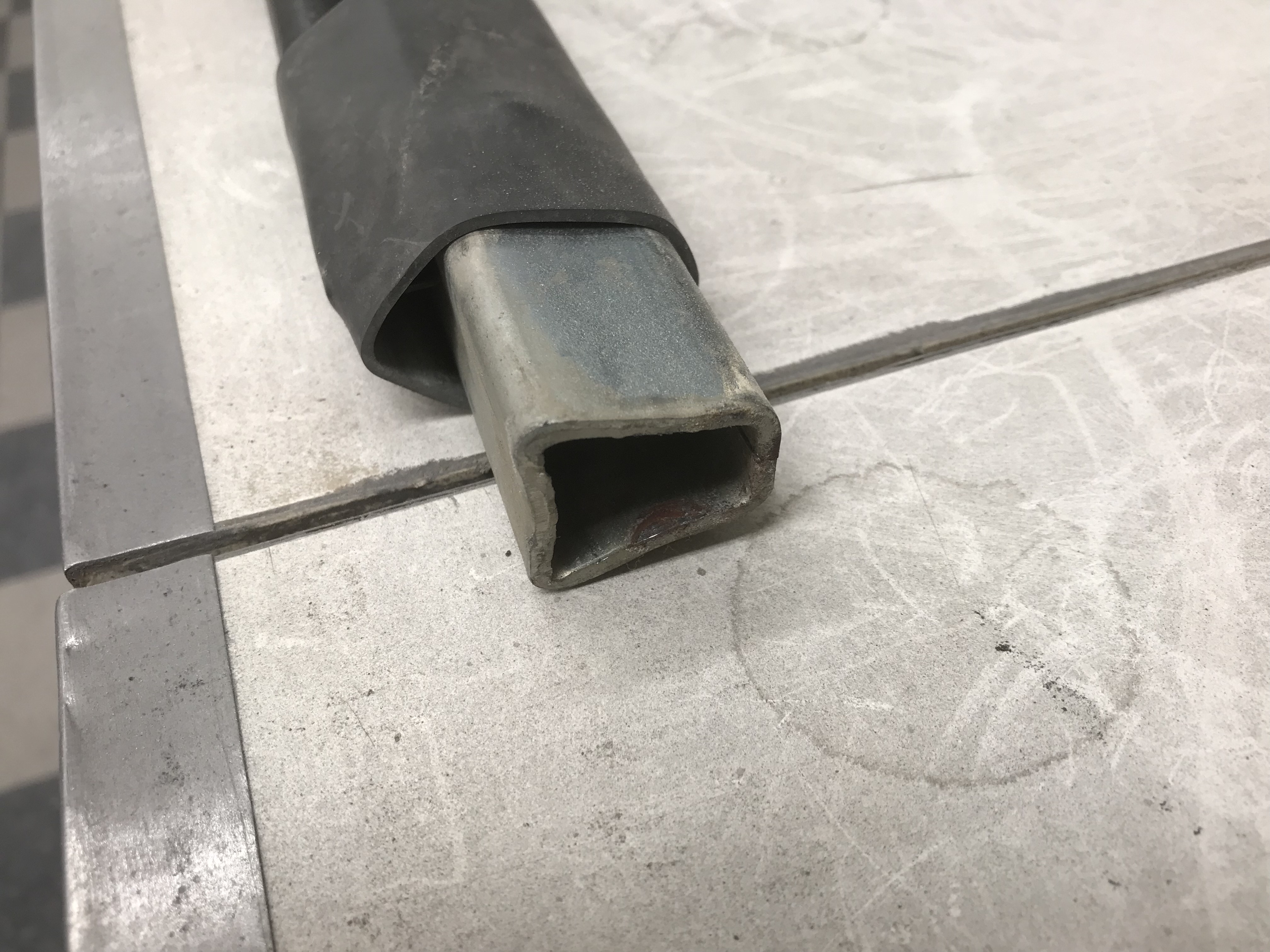

On the other end, my bumper jack has the end of the stem open on it...
...which is designed to hook into this bracket in the trunk:
The newer style jack has this closed off bracket on the end of it which prevents it from attaching the same way...
...but I’m thinking if I remove the bracket it might work the same as the original.
