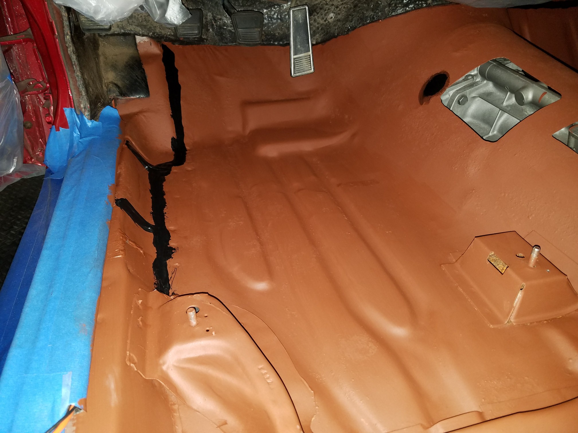

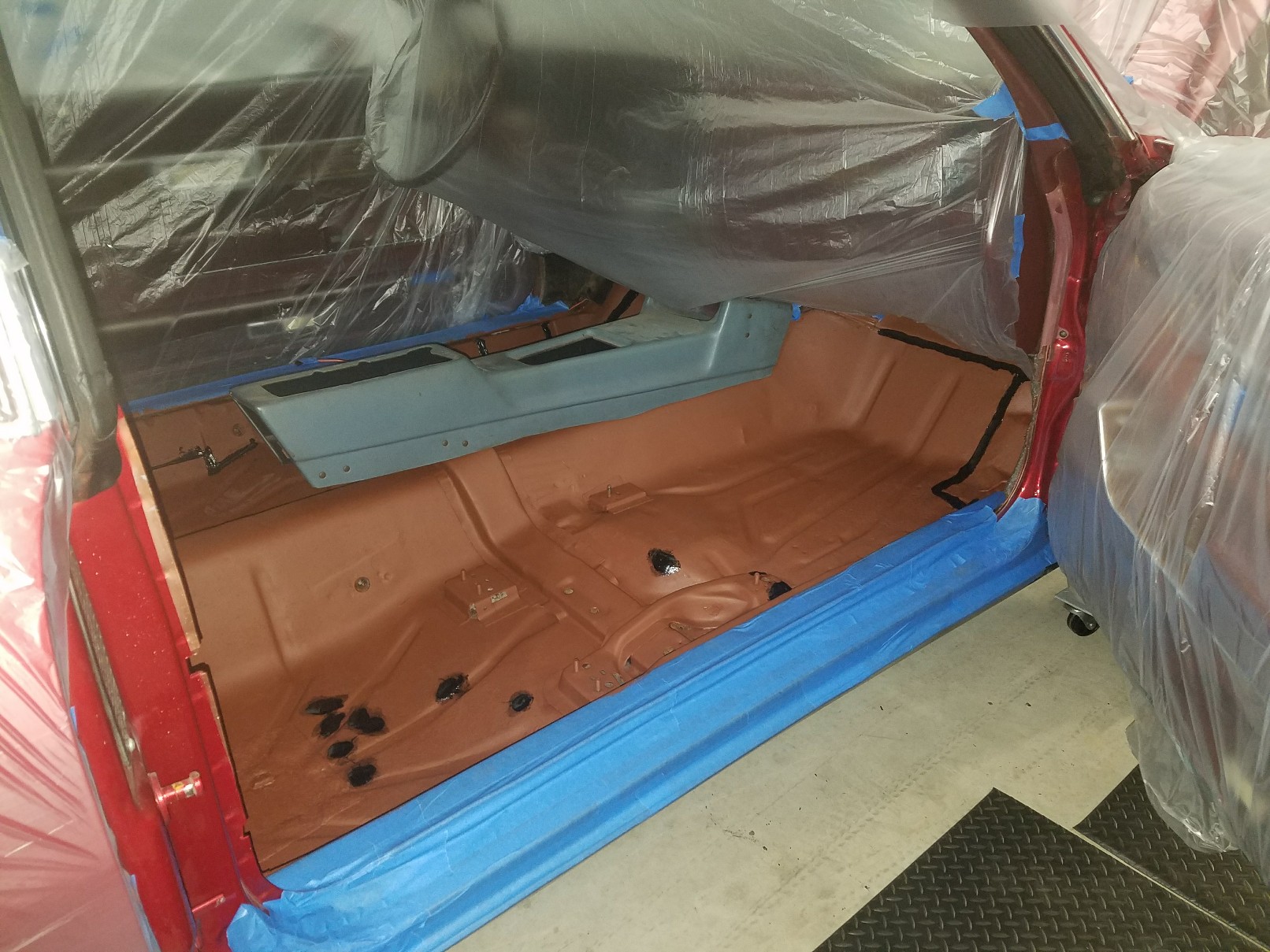

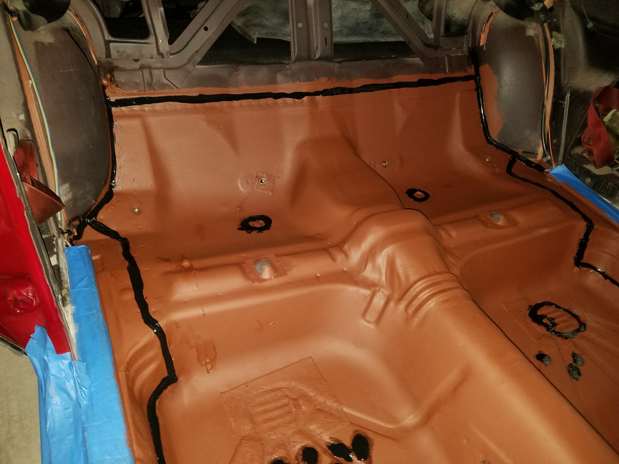

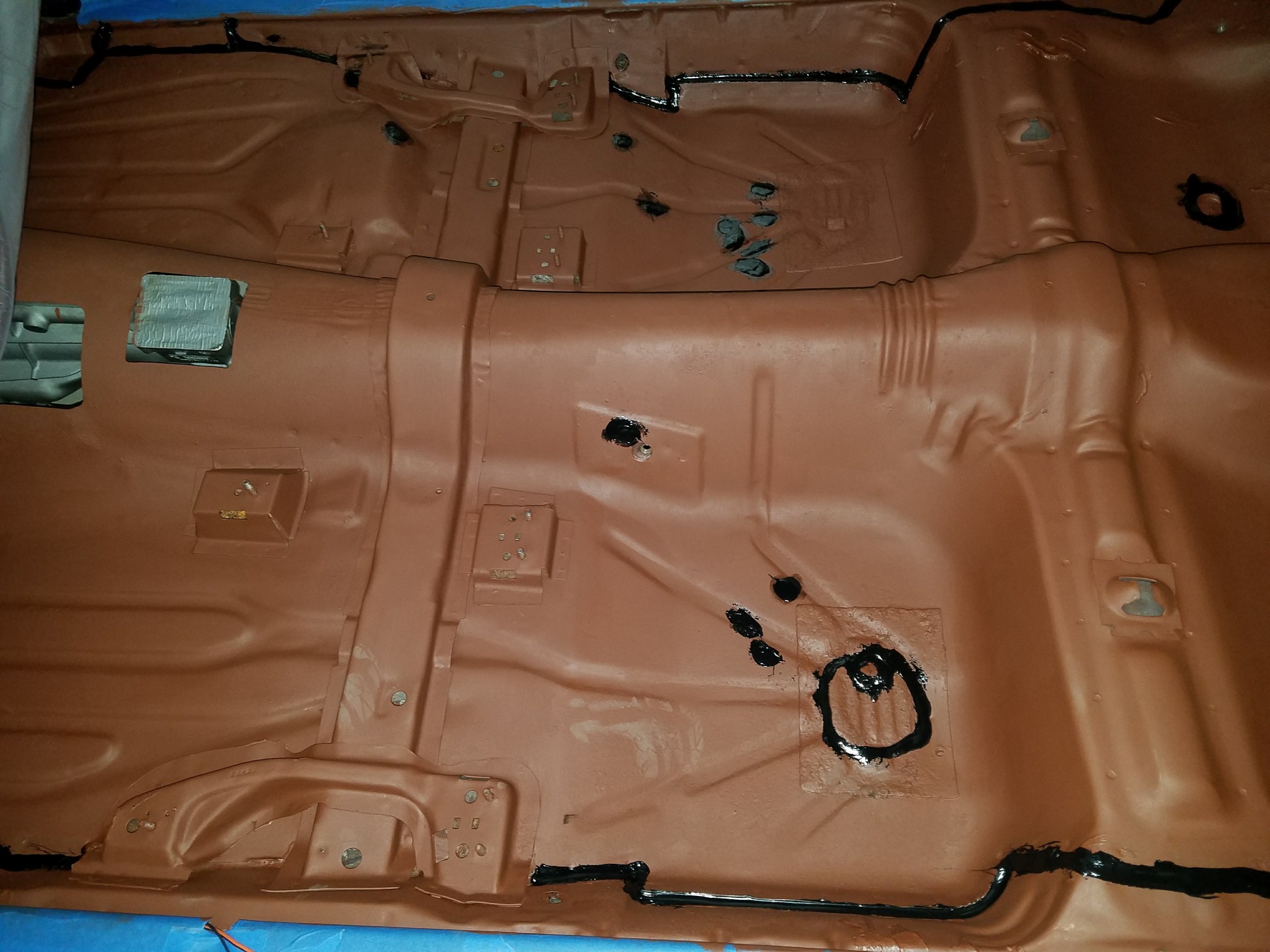

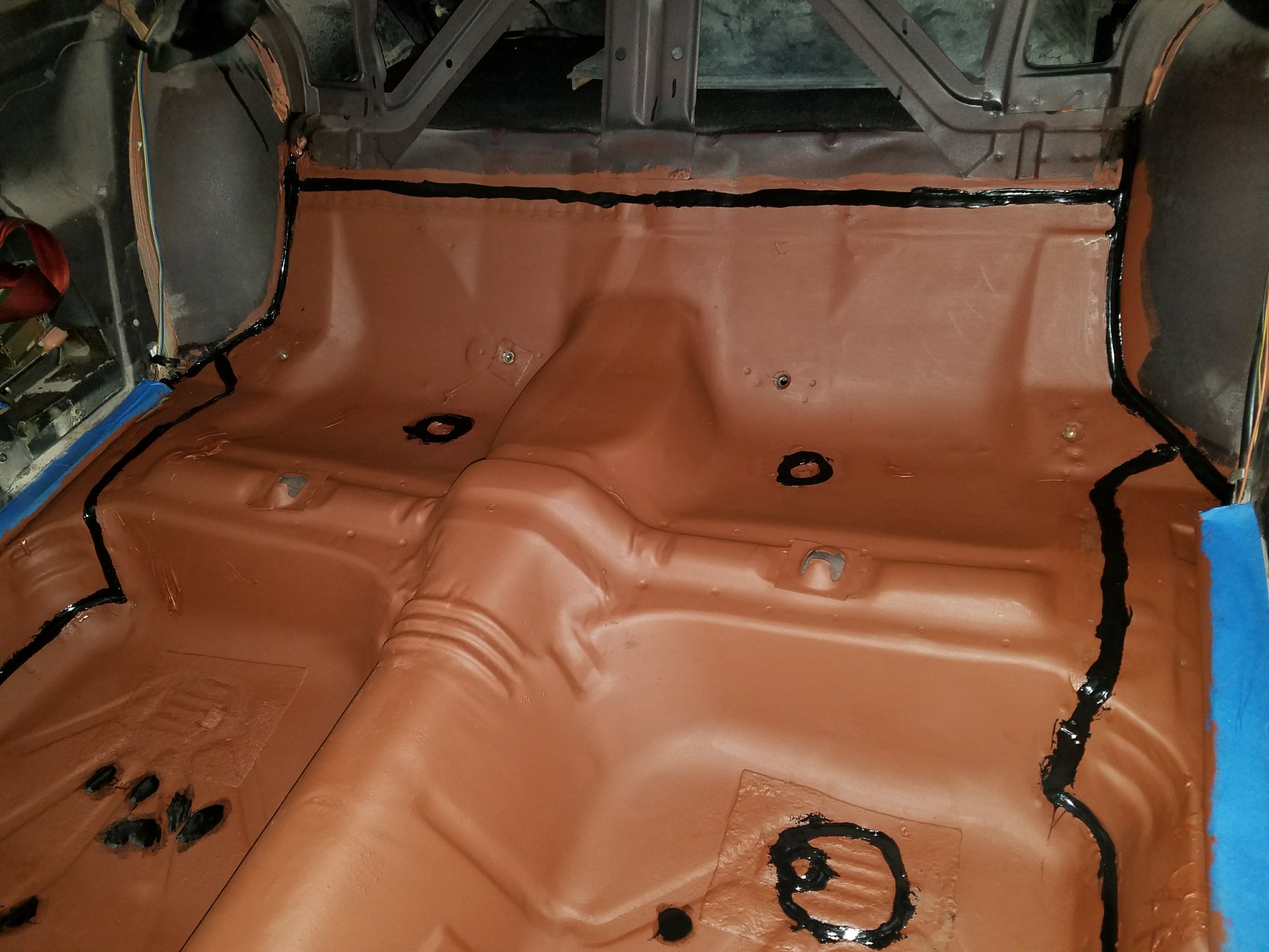

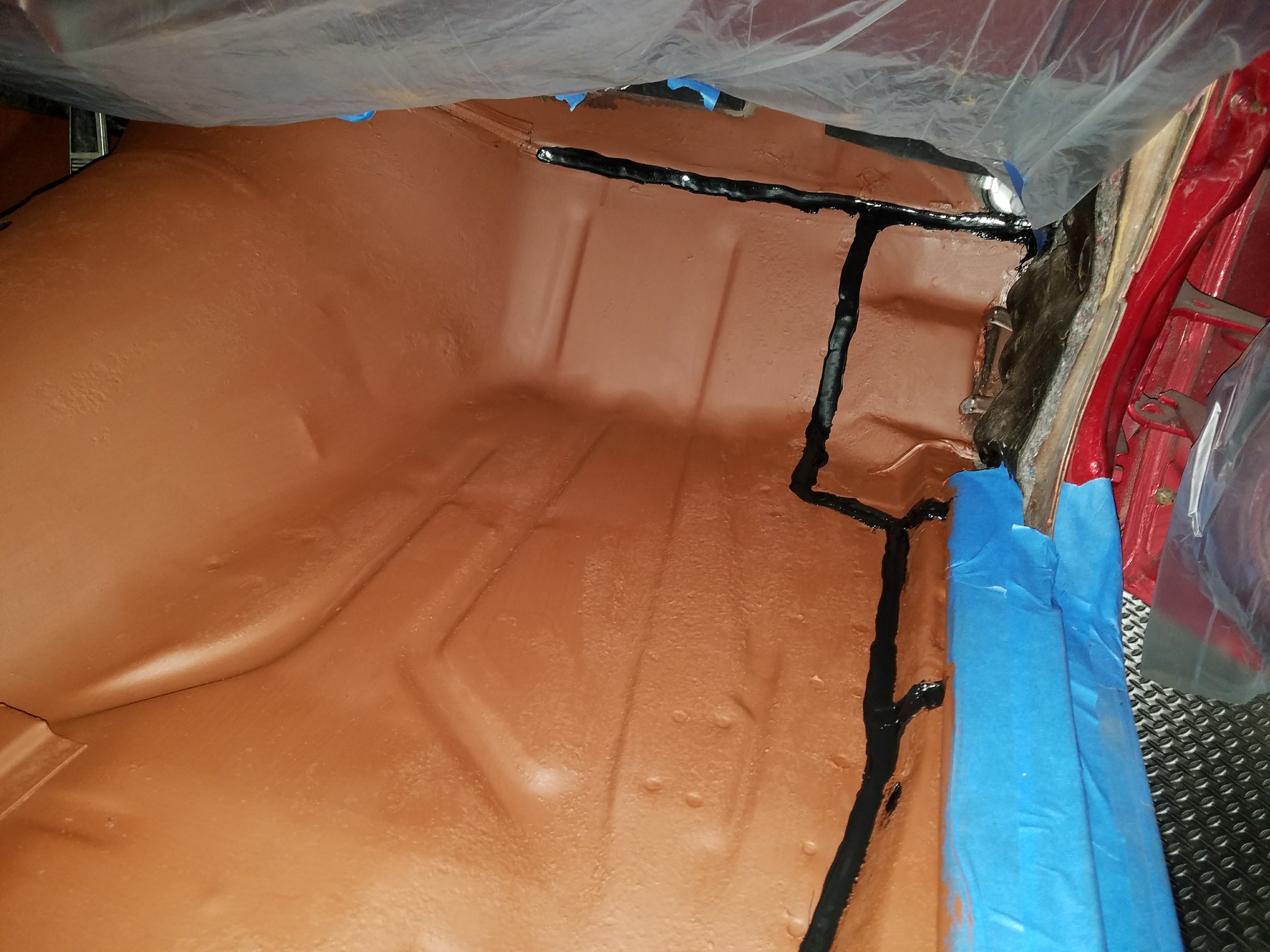

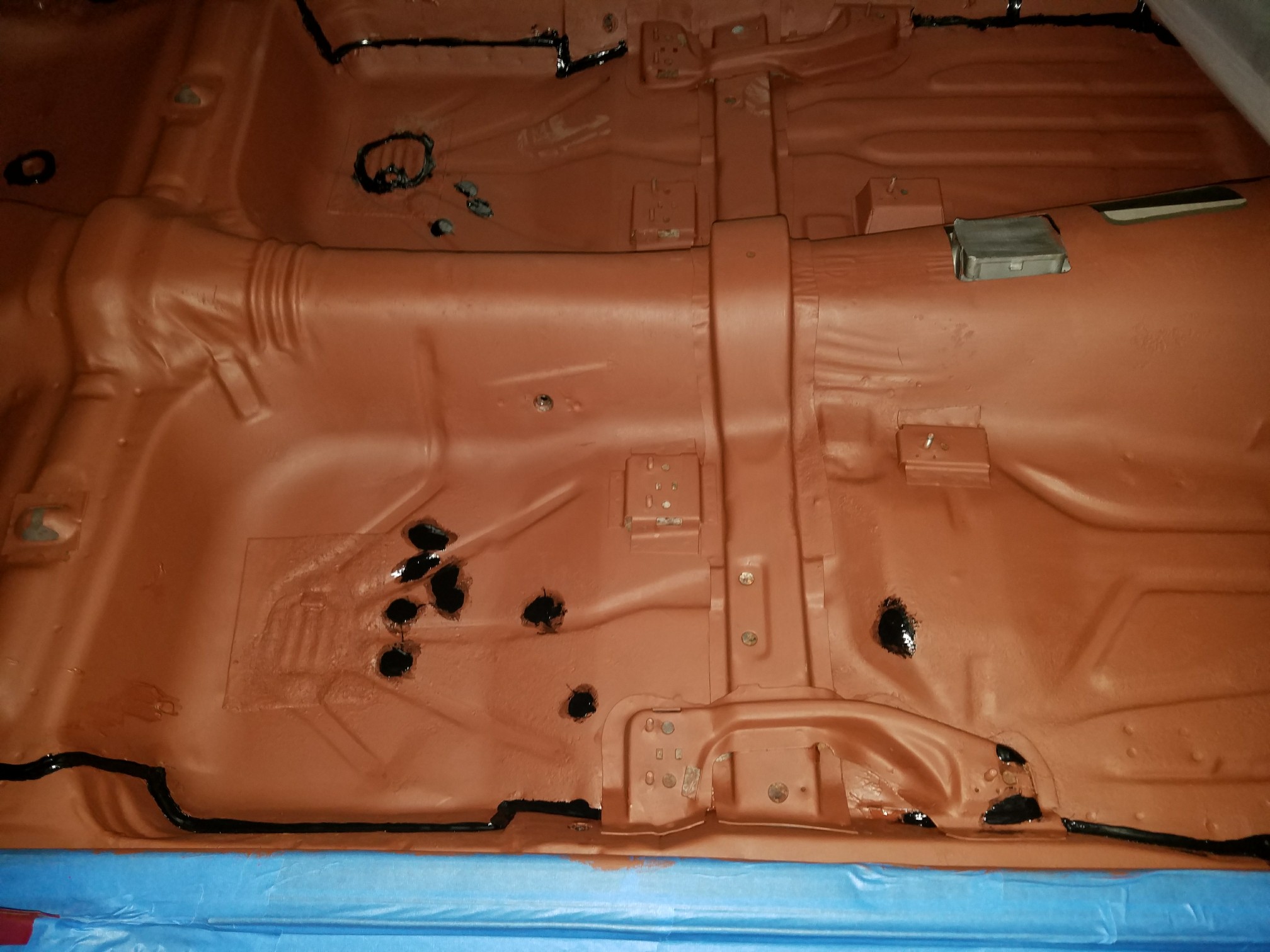

Sean and I got over to the storage tonight and got the rest of the seam sealing done. I didn't plan to take the better part of the interior out of the car at this time but I'm happy with where this has brought the project. This has put a lot of life back into the floors....
Also, I think the musty old car smell is gone.
The reality of how much money I need to spend to put the interior back in is setting in. One day at a time. Next up...two coats of satin black Rustoleum enamel on the floors.
That's it for now gents. Thanks as always for looking in.
View attachment 80630 View attachment 80631 View attachment 80632

Everything the previous owner did was a hack, Eric. Much of the work I've done on the car has been undoing his hack jobs.
The floor looks great. Must be satisfying again to know it’s going to be totally taken care of. I can’t wait until I’m coating metal instead of fixing it! Inspiring progress man!
It does feel good to be at this point though I hoped to put this aspect of the project off for a year or two. Hang in there. You are doing nice work on your car. You'll get there.
