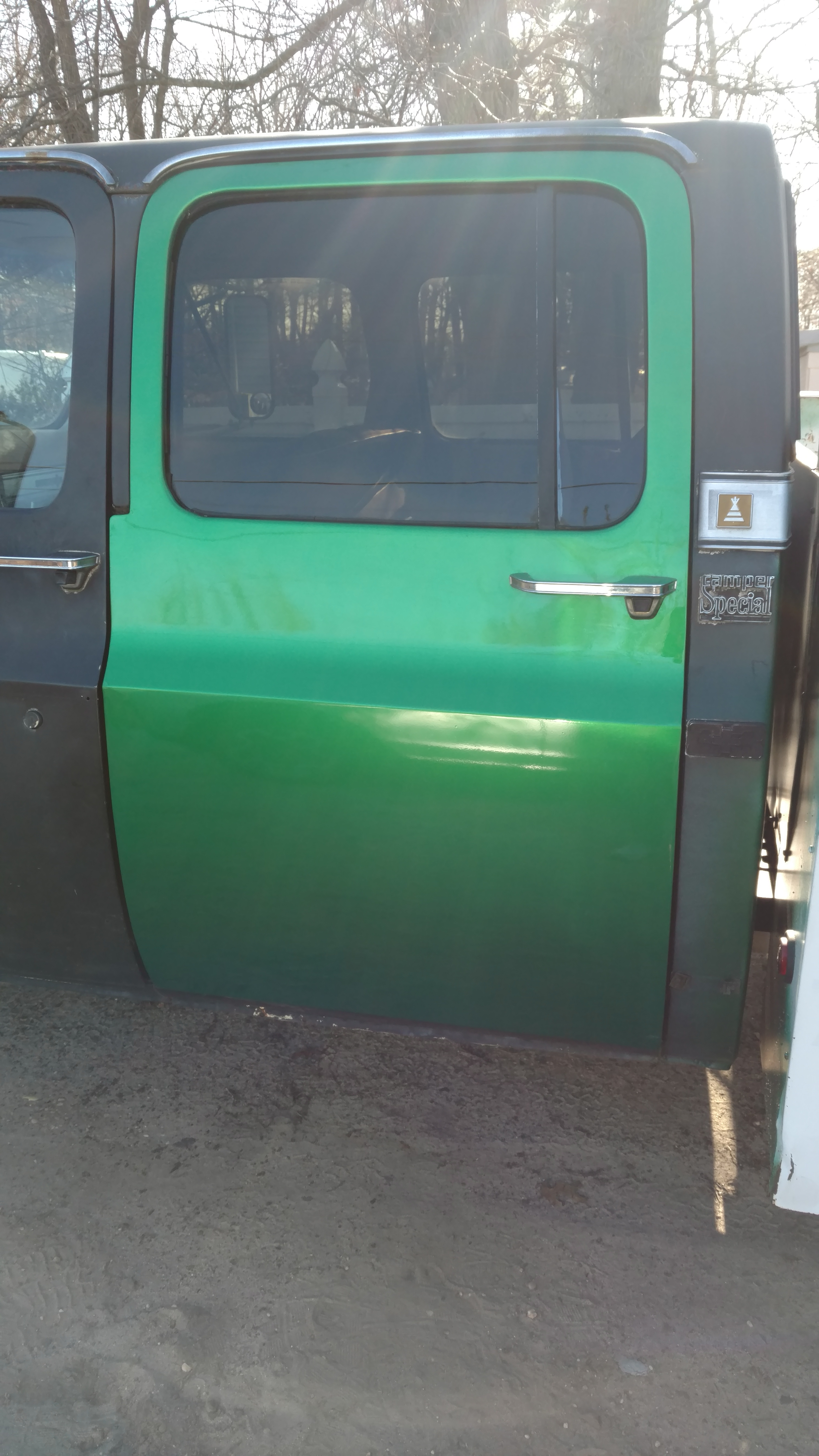

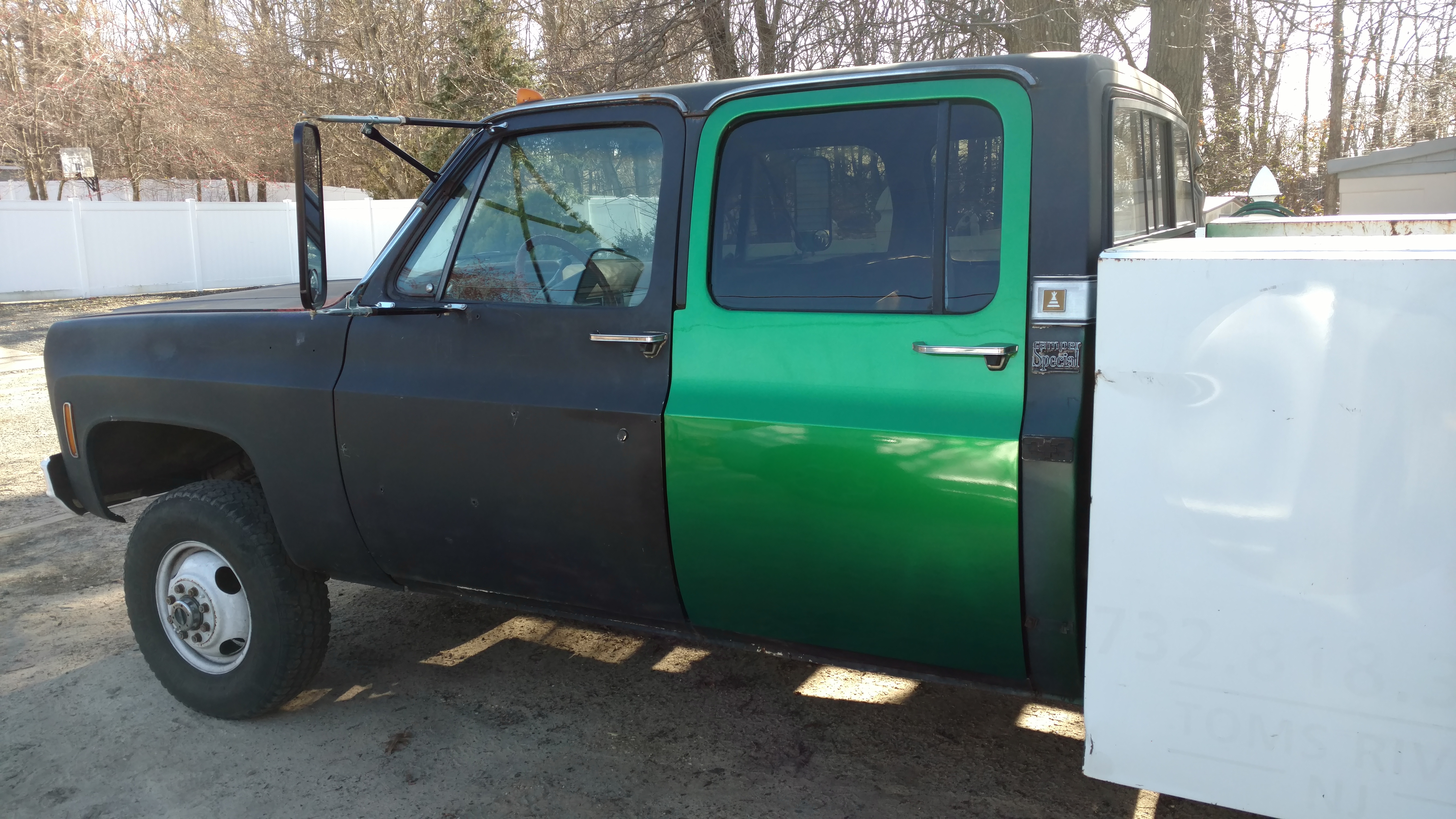

The motor is back together and seams to run ok I'll see how it goes this week. Still no oil pressure gauge I found and fixed more hacked wires under the hood but nothing seamed to change
On a lighter note check this out
It's got fish eyes and dirt but I was really just edging parts when all the parts are done the hole truck will get painted. Plus I needed a change the flat black is really getting old especially since I never liked it
On a lighter note check this out View attachment 87447 View attachment 87448 View attachment 87449 View attachment 87450
Love the color on it
