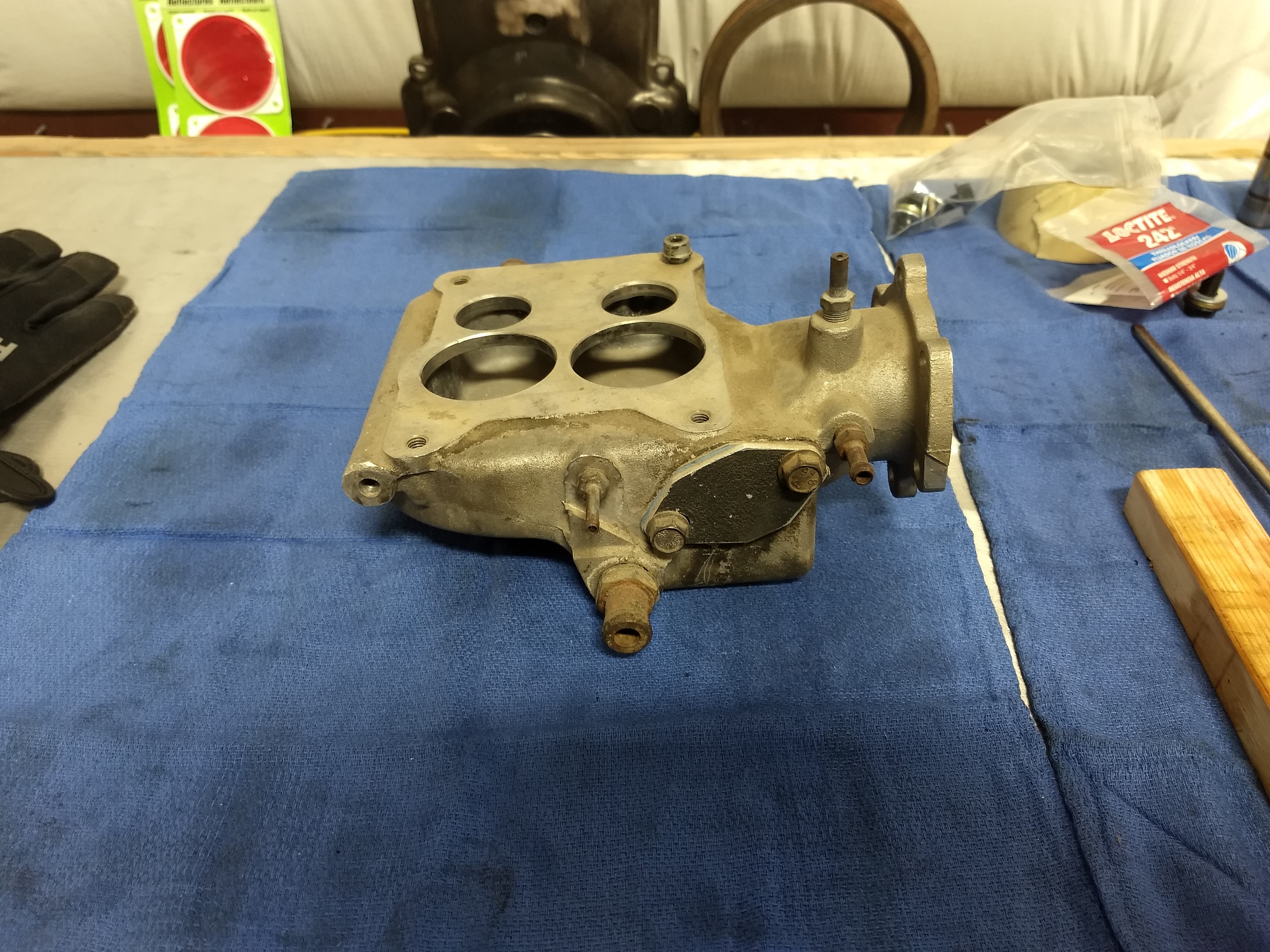

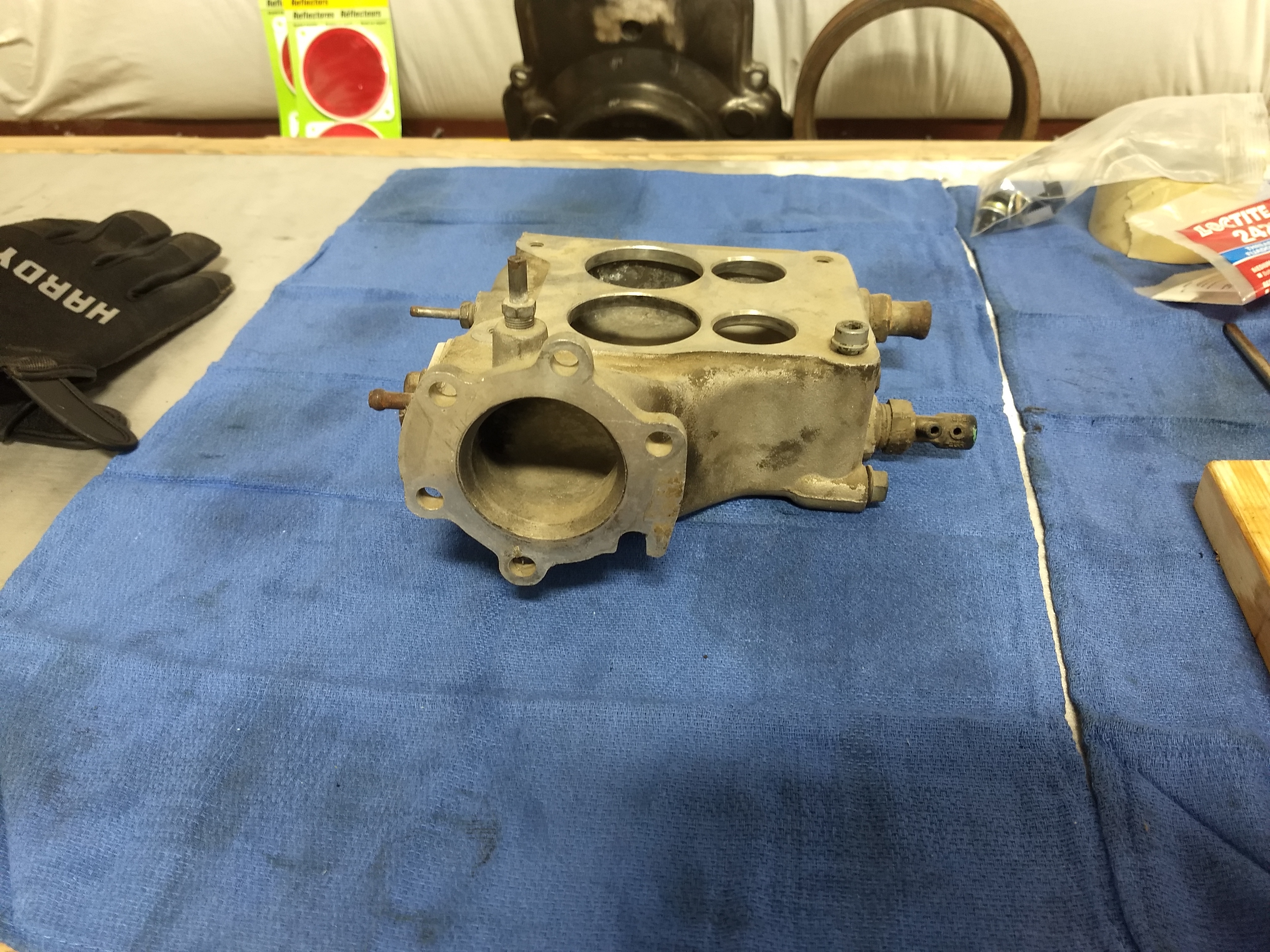

I think you made the better choice. I would like to see a picture of that intake. For what I will have into my engine I could have built a 400 horsepower LS, but I wanted to be different. I have a 3800 series two ready to build if I want also. That is why I am trying to spend money on things I can make work with that.
You mean the actual intake manifold? I never got one as I was going to use the turbo as a blow through not draw through. And I run Chevy engines so they didn't exist. I had thought about making an adapter plate to bolt it to but I dropped that idea pretty quickly.
Gotcha now. Again I think you made the better choice .
