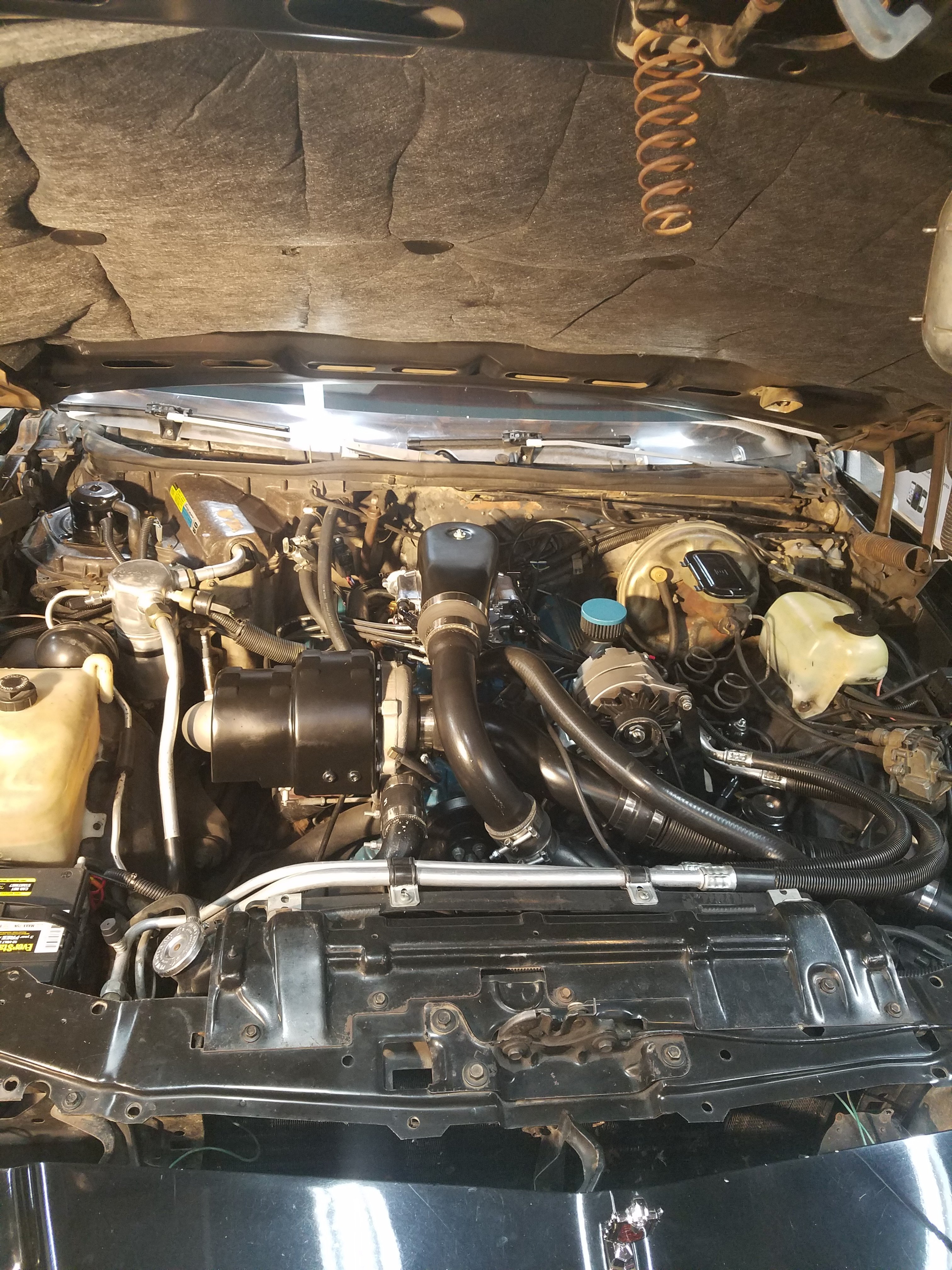

I spent some time today working on the black car. I spent a couple hours sorting and rerouting wiring in the back of my engine. This is what I started with.

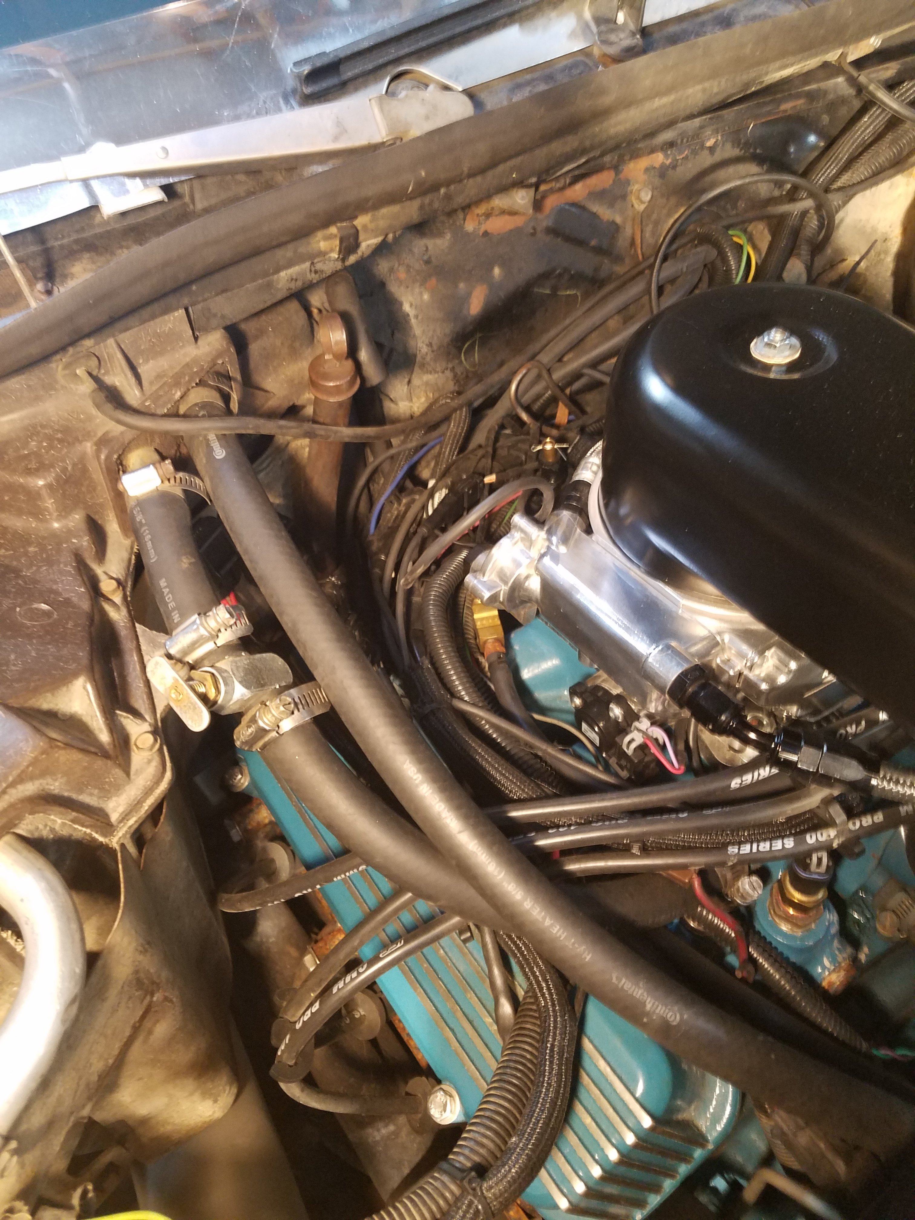

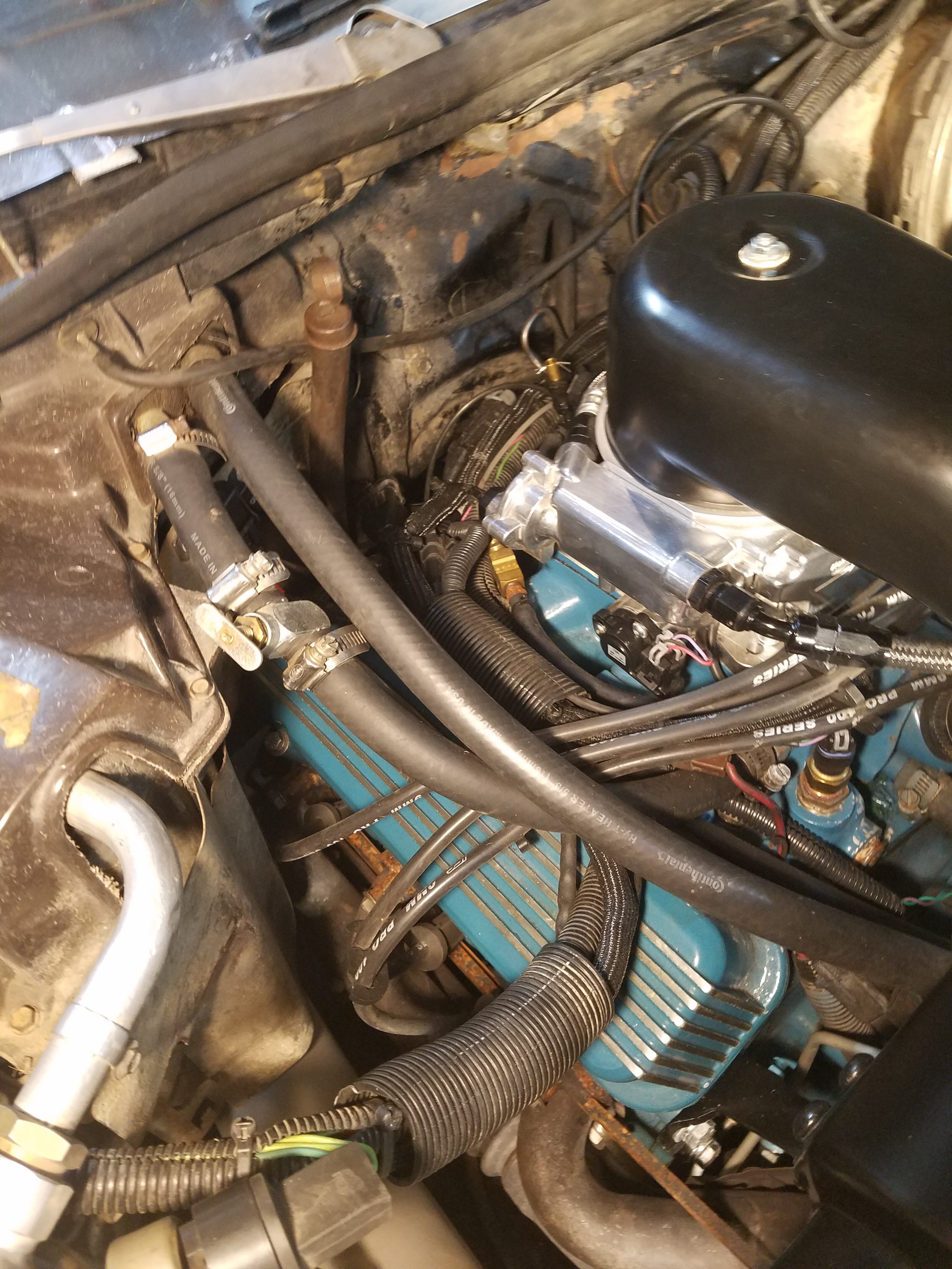

After a couple hours.

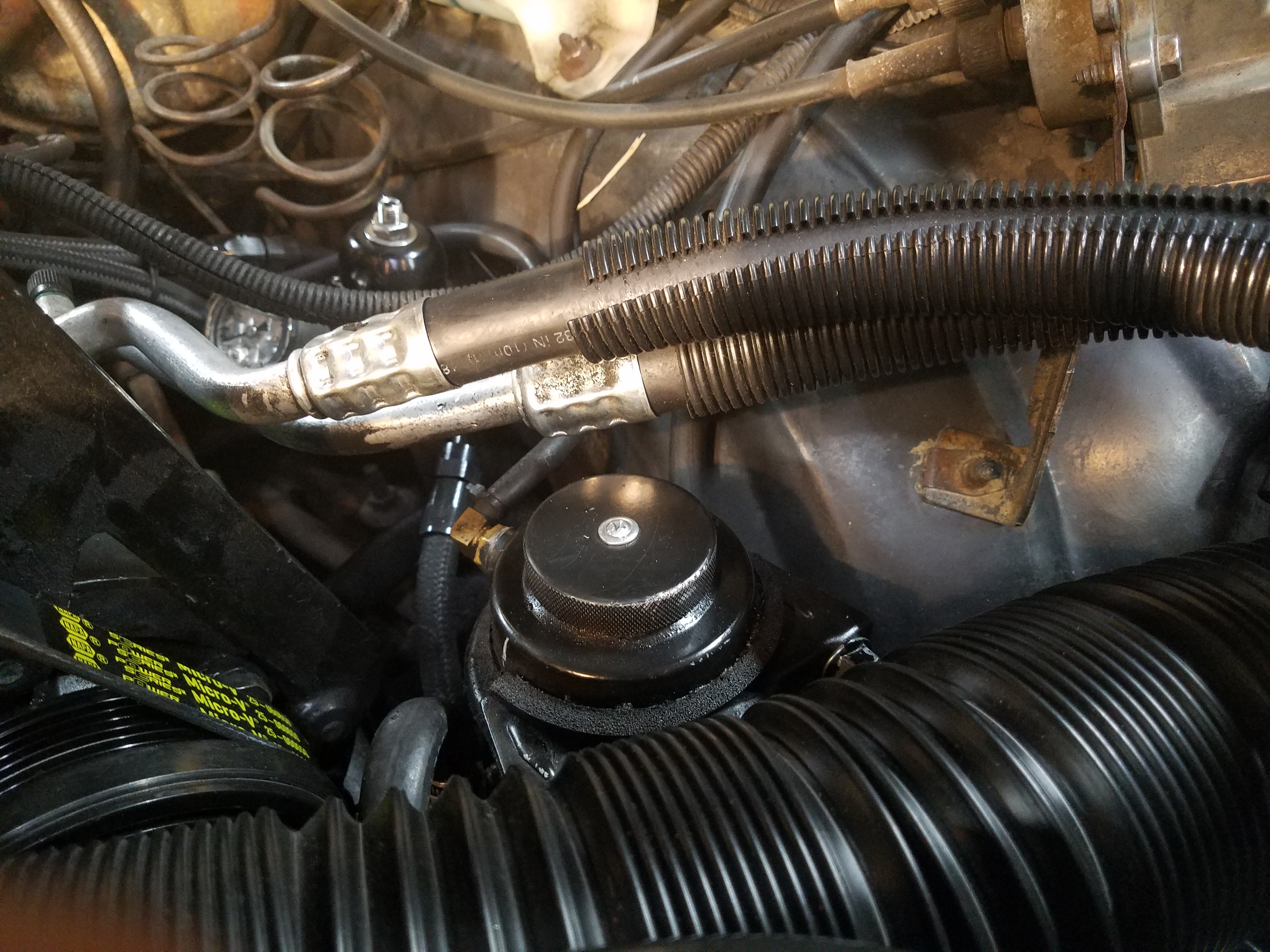

It doesn't look much better. 😡 There was two reasons why I did it. One was to make it look better. Another reason was after the engine gets hot my Holley tuch screen controller starts flashing and jumping screens. Hopefully by rapping and routing it differently will stop the problem? I took the vent hose off my power steering resivior and plugged it. When I go down the highway oil seems to puck out of it. The resivior is a 20 dollar Ebay jobby I made work. I am not sure if the resiviors need to be vented or not? I will find out I guess. If that does not work I can buy a 80-100 dollar one meant for it.

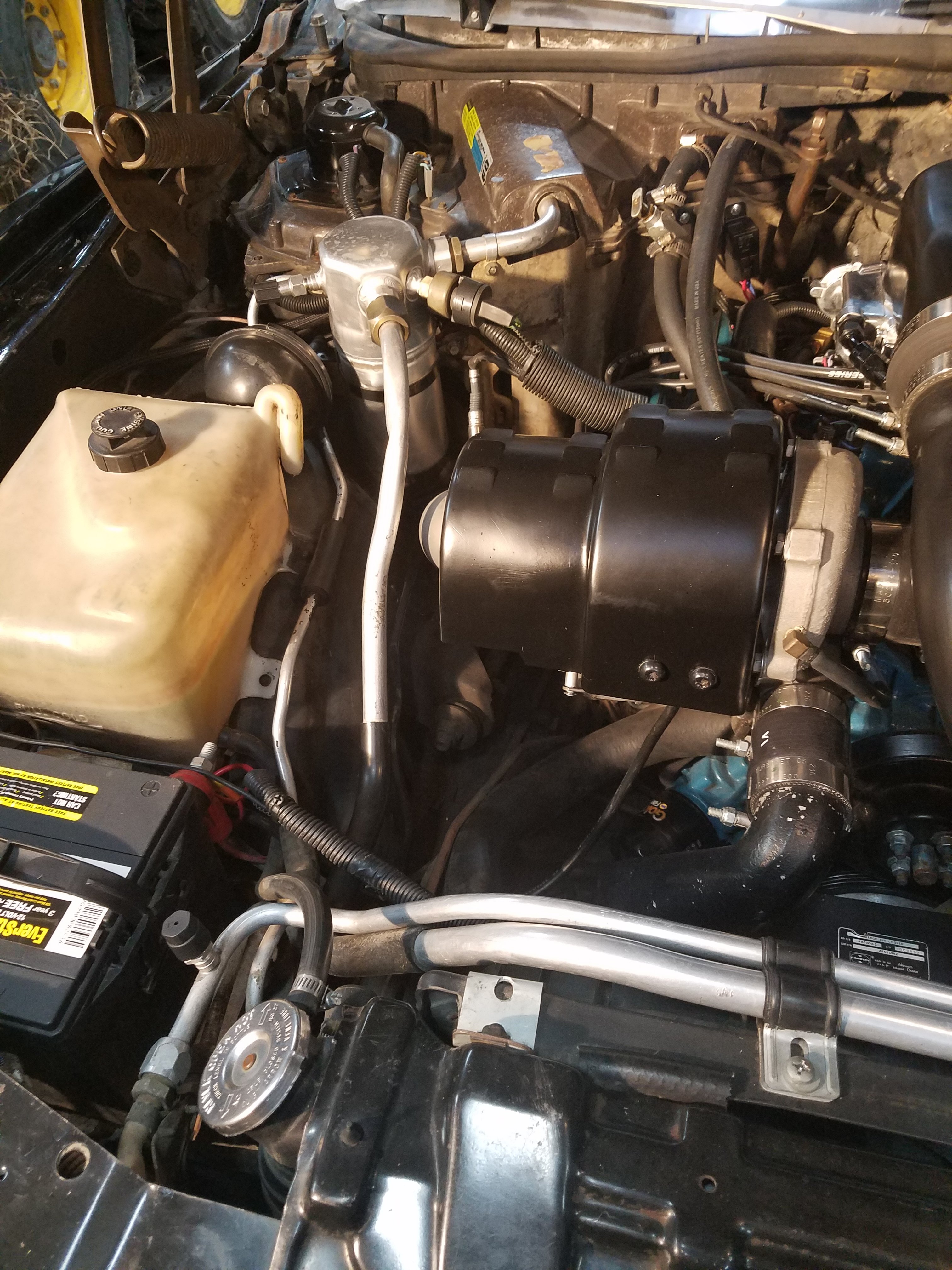

I am going to get some header heat rap and rap my A/C line. I think it is getting too hot next to my down pipe. And it will hide the kink I put in it.
The A/C works perfect at idle or around town, but going down the highway it starts blowing hot. I have tried changing the amount of charge and I tried jumping the low pressure switch. I am not sure what is the problem yet? I need to clean this mess up some too.

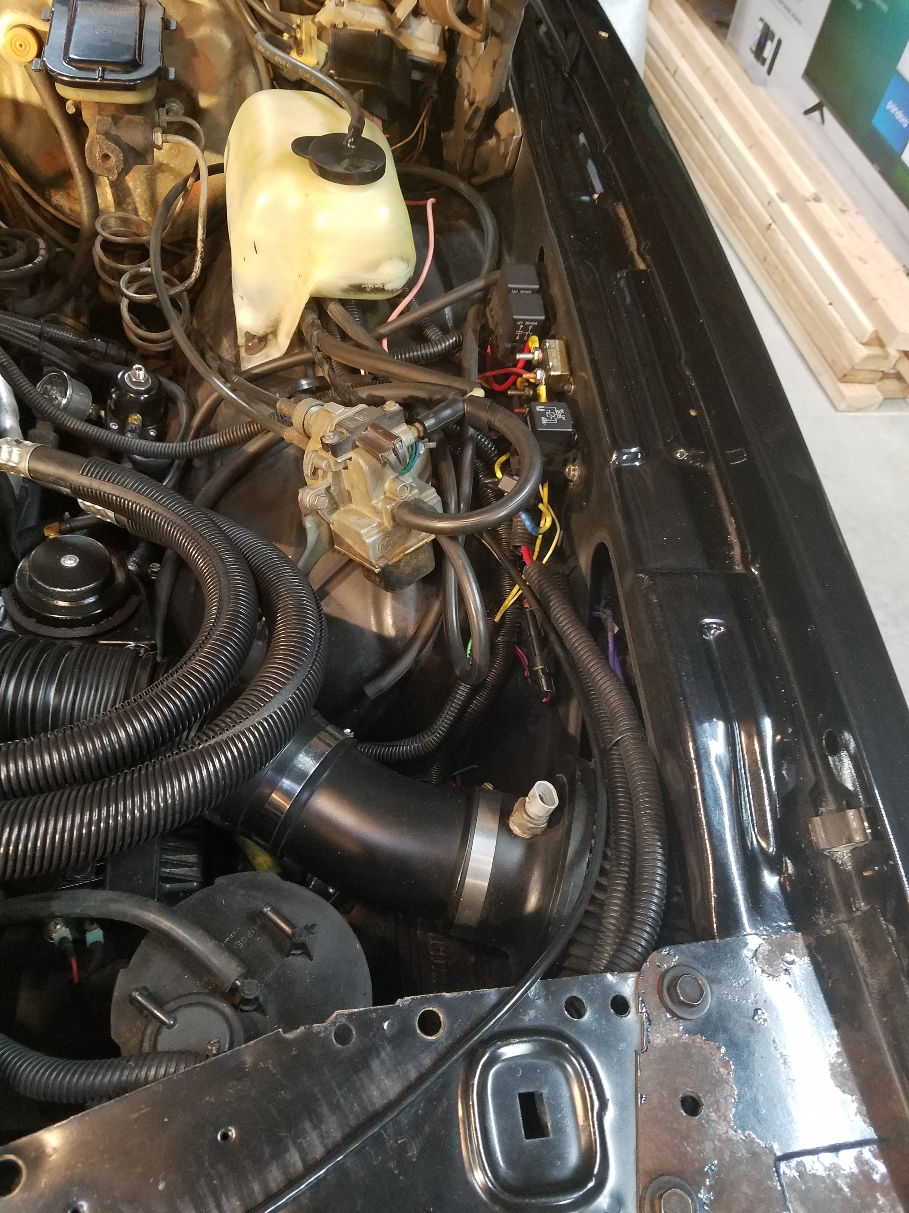

The one thing I don't really like about the Holley Sniper is the wiring. Beings the ECM is built into the throttle body. The harness cables are only a foot long with multiple big bulky connectors. Hard to route wiring and make it look nice. I could make my own harness, but that would be a lot of work for what it is worth. My engine bay is way too busy looking. I don't really like it, but it is all business.
I am such a hack! What do you guys think?

I think it looks pretty damn good.
Is that a turbo car ac line going to the drier?
I had to bend mine also, I couldn't figure it why it didn't fit. I think turbo cars have a specific drier.
I did the same thing you did but mine didn't kink.
