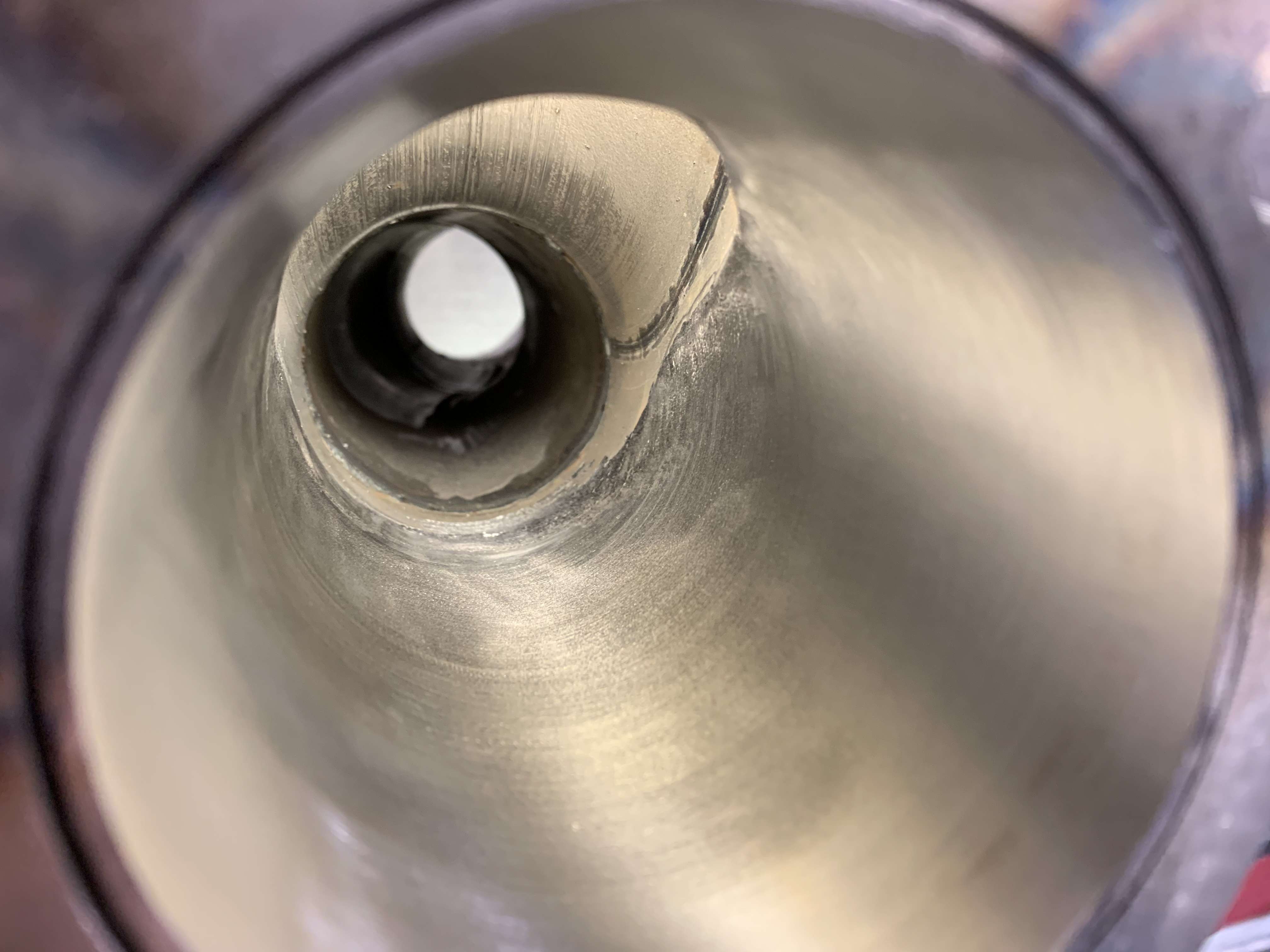

The reducer gaps welded up before:

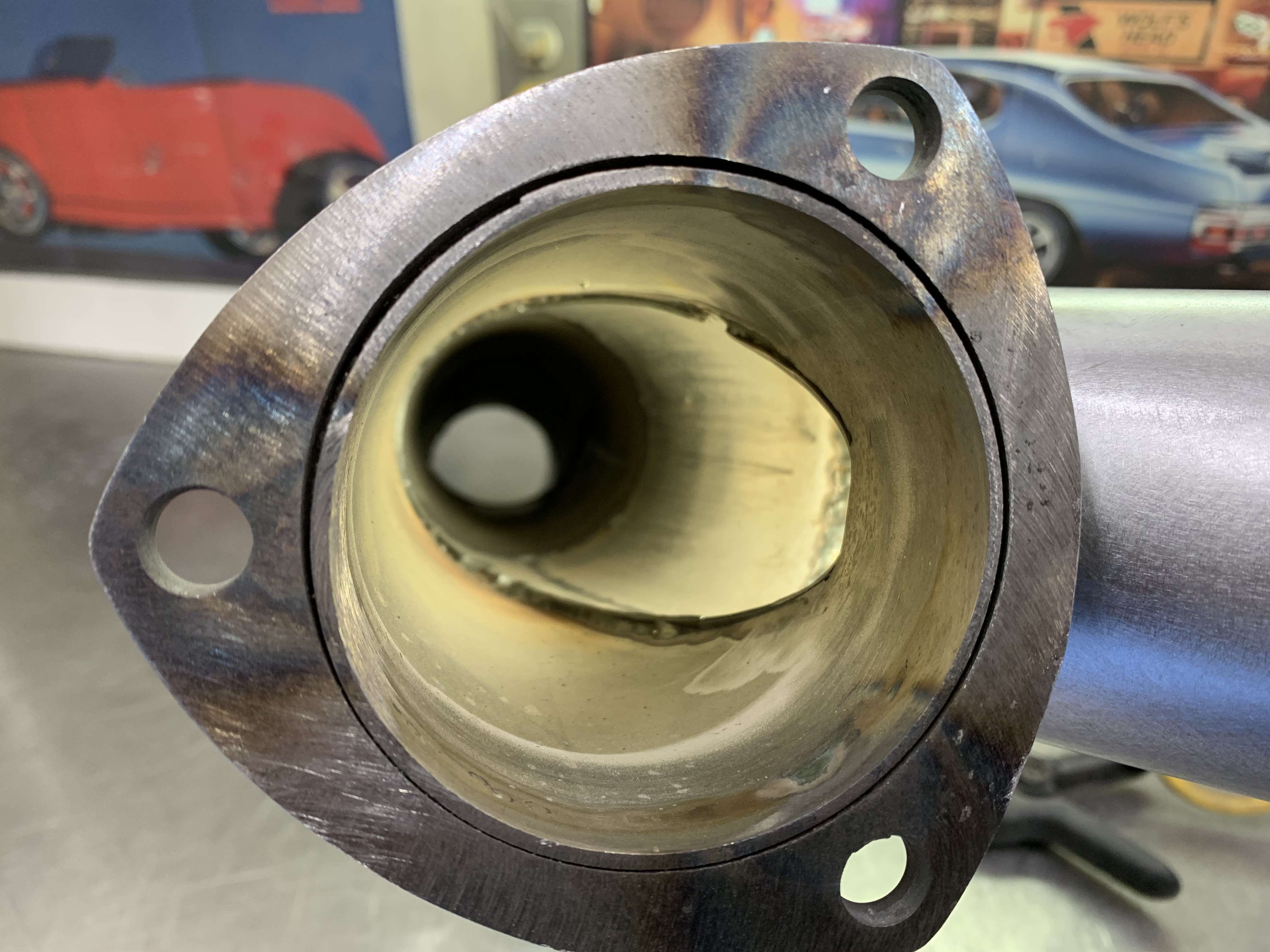

And after:

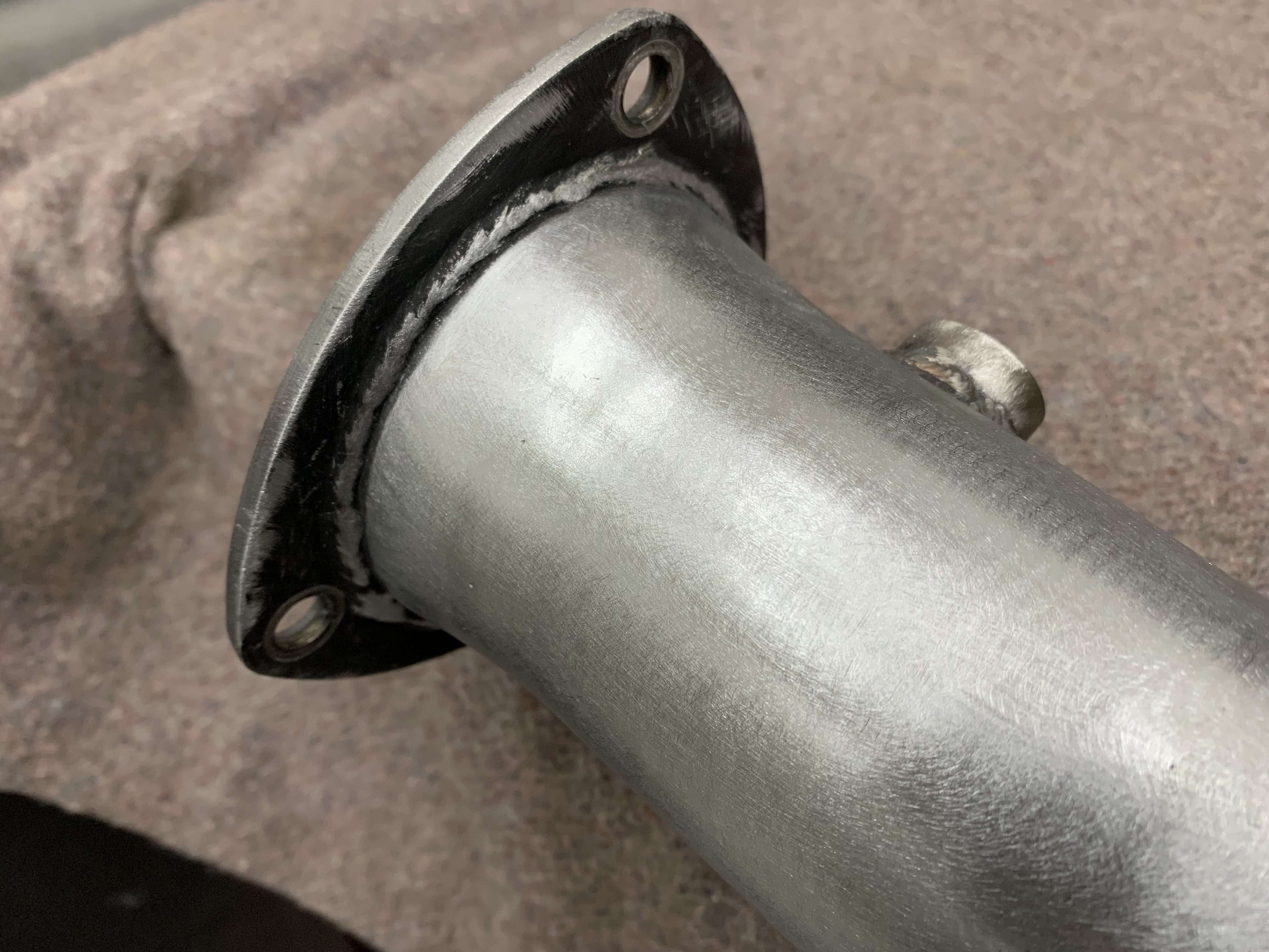

After I ground the welds flush, I started out by continuing sanding and trying to smooth out all the grinder marks on the rest of the pipes. (Do you have any idea how much time and effort it takes to smooth grinder marks out of bare steel? It’s a LOT.)

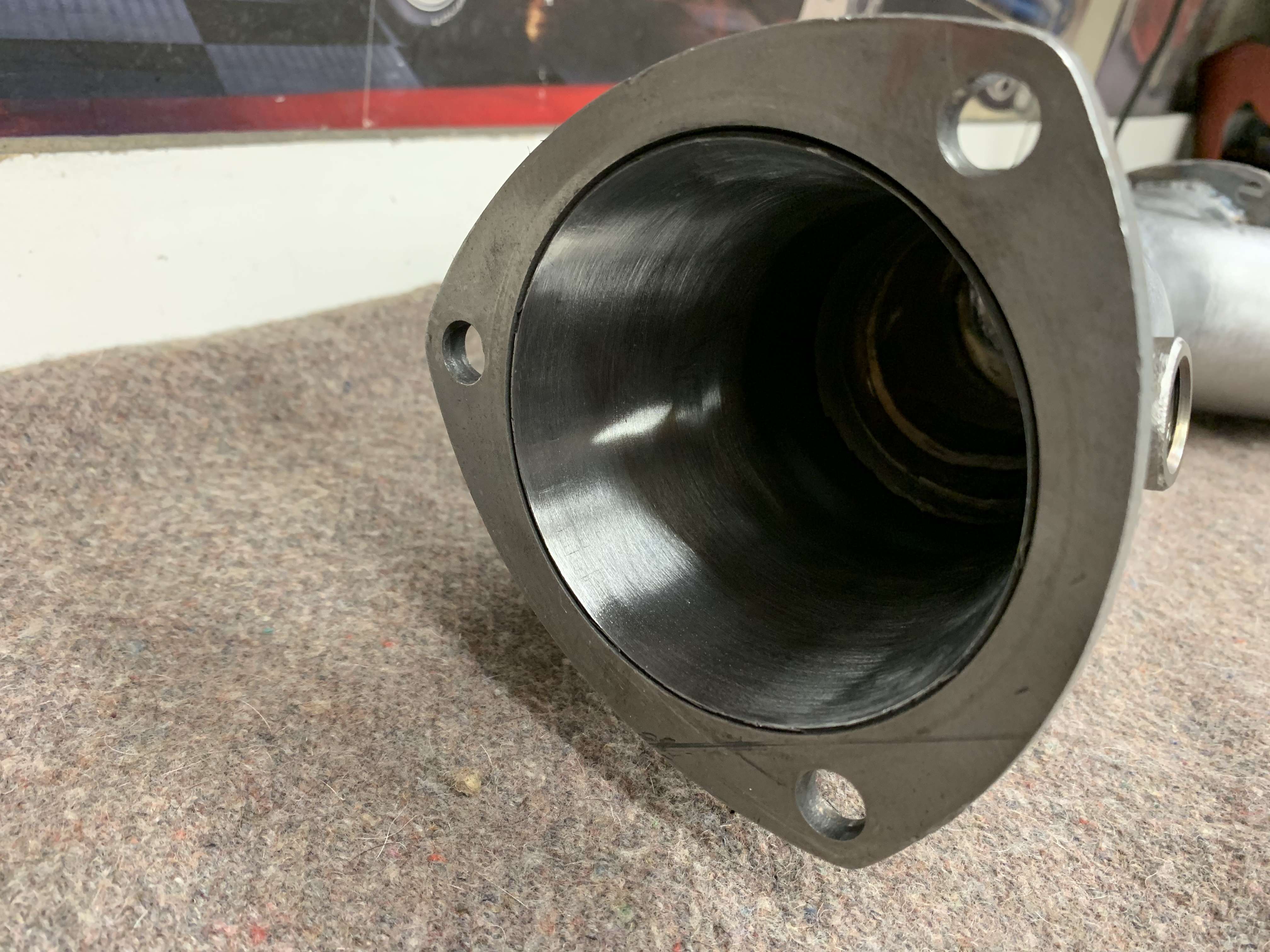

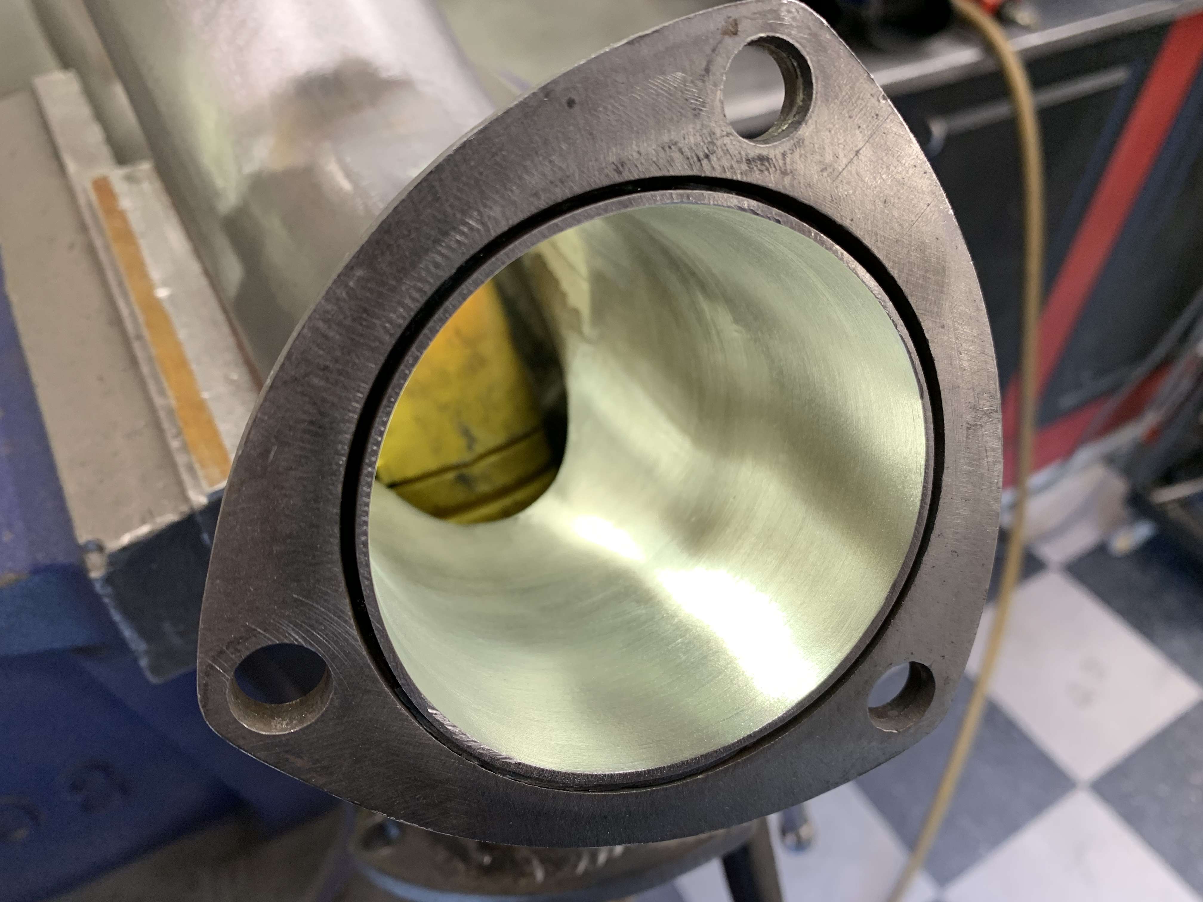

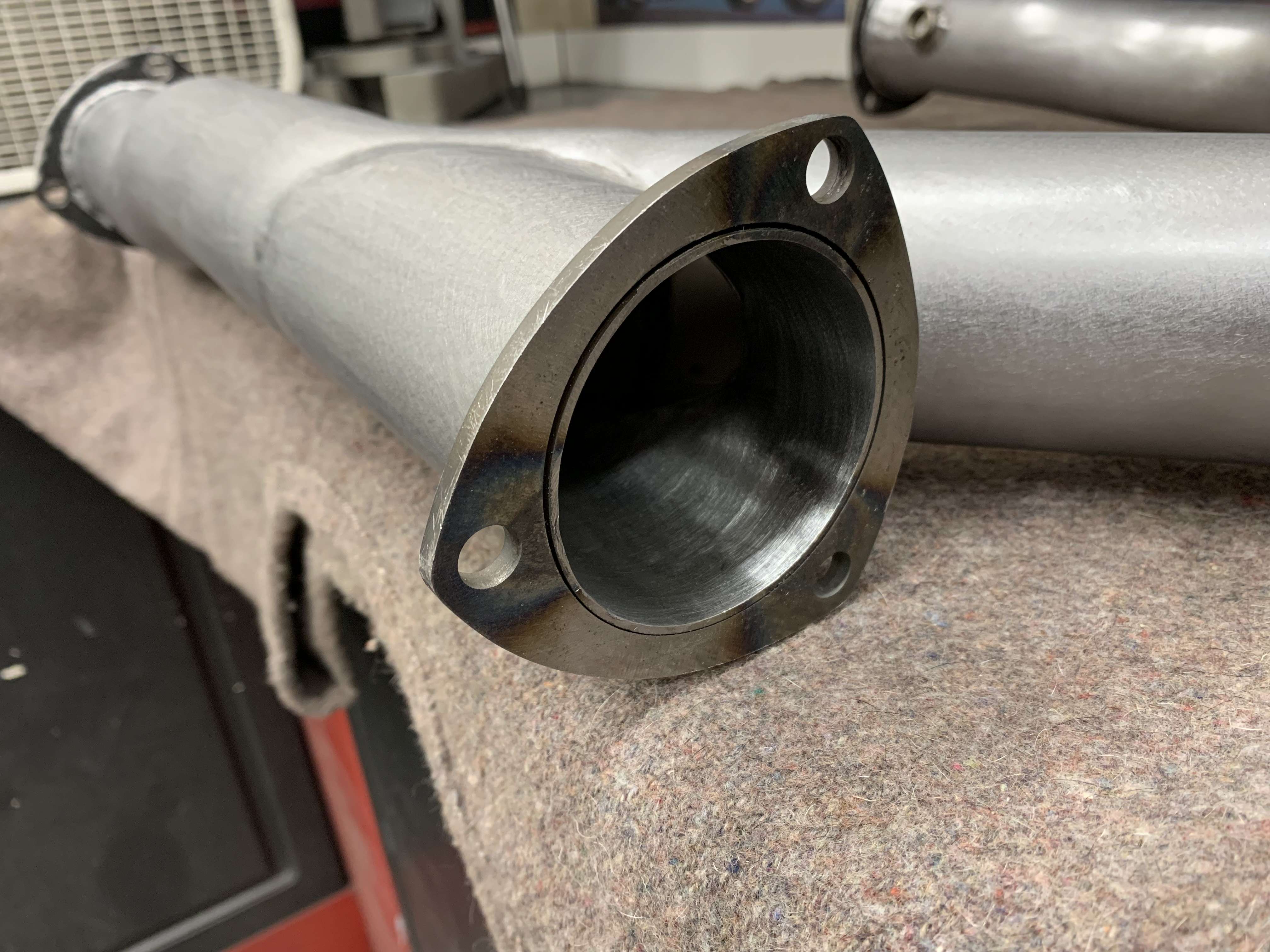

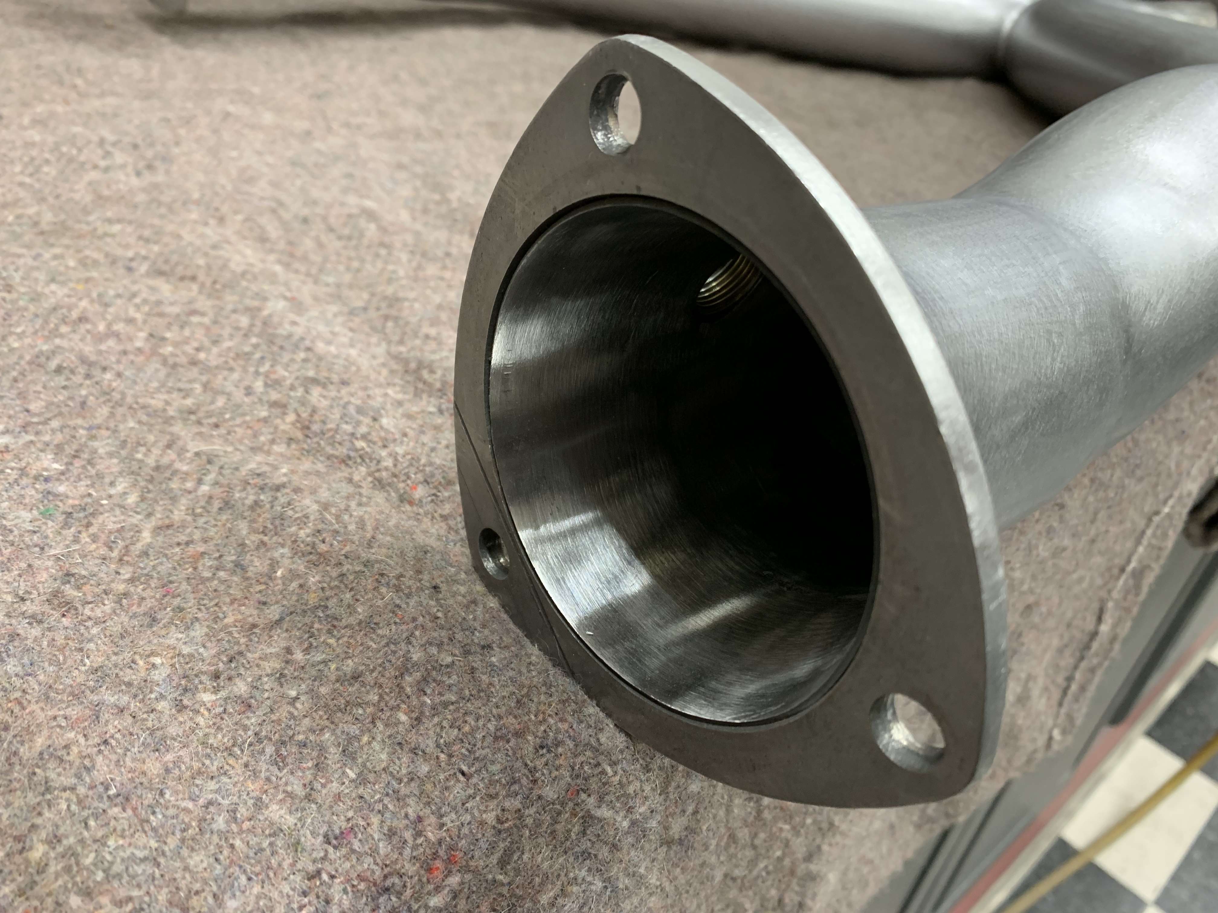

I immediately put them through their paces, and turned areas like these…
…into areas like these, with a little assist afterwards from a 40 grit flap wheel sanding drum.
Essentially poor man’s extrude honing. More nice smooth goodness:

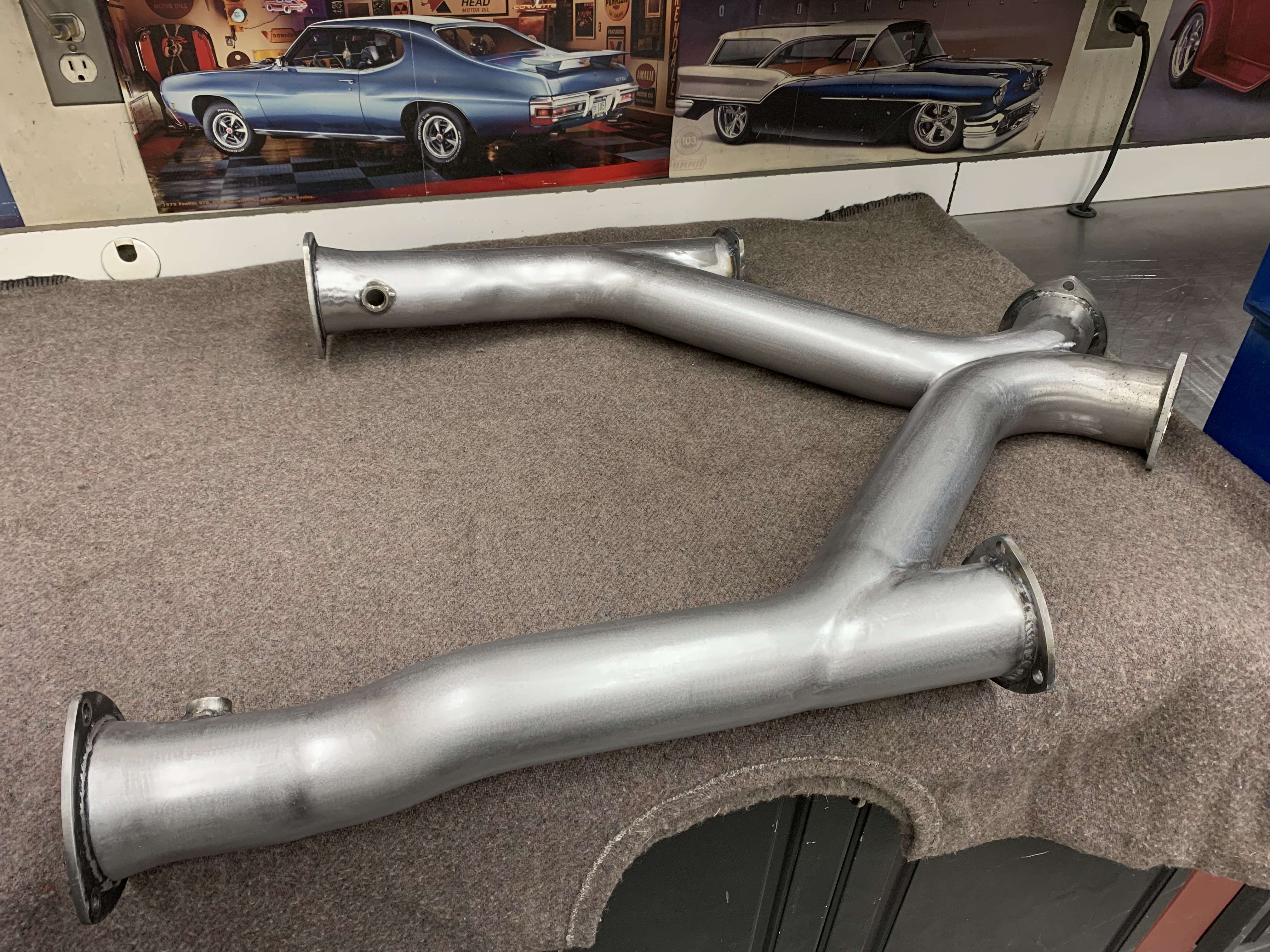

I even smoothed out the ugly welds on the two halves of the Summit X-pipe. Pretty much had to as the rest of it was starting to look really good, and their welds were sticking out like a sore thumb.
So that’s where I’m at right now, this is what it takes to build some next level shjt. It’s lonely at the top, but someone’s gotta blaze the trail. Not too many guys going to this extent on a G body, but I don’t care. It’s what makes me happy, it’s gonna look killer when it’s done (because aesthetics are just as important on this build as performance), and that’s justification enough for me.
Couple last pictures of areas of the main pipes. I still have a little more to do yet, should hopefully be done in the next day or two.
I know it seems like a lot of unnecessary work, but just like bodywork on a car, it’s all in the prep ahead of time. The entire exhaust system will be going out for high lustre silver ceramic coating to match the headers, and all this work now will pay off afterwards in a beautiful finish.
