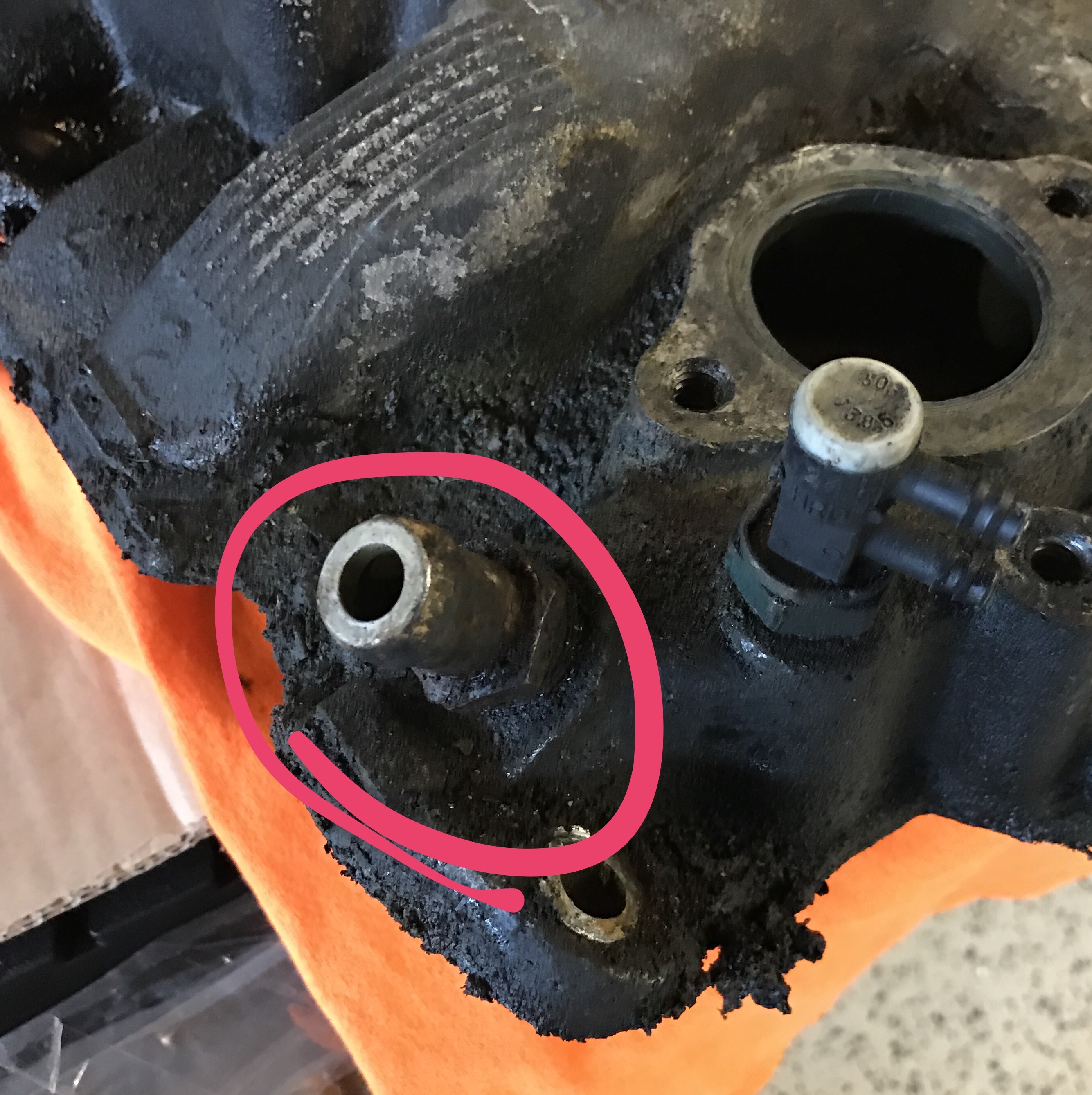

I think Ill try to run to the auto parts store later. Pontiacgp, I'll see if I can find ARP studs for my Qjet. Right now I'm trying to get this guy off:View attachment 63000
Got all the old intake bolts and stuff off and put on the new one. This thing is in there tho. Like, really in there haha. I've tried regular sockets and open ended wrenches. No avail. I've gone up to a breaker bar, and even then I put a long 1inch pipe over the handle for extra leverage, but it won't even budge. I'm considering just buying a new one from an auto parts store if they have it. That's how bad it's stuck haha
you don't need the ARP if they have something less $$$. I just posted that picture as an example. To get that fitting out get a torch and apply heat. I bet now you can understand why it'd be easier taking those fittings out with the intake still installed
Yea haha, it'd be nice to have it in a fixed position while I torque on it

I wouldn't spend too much time on that heater nipple. Wasn't a new one included with your new manifold?
Sadly no haha. Just the manifold itself
