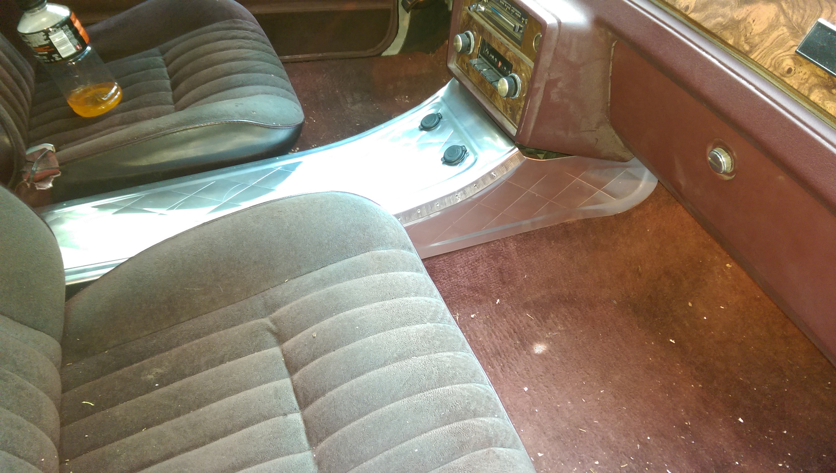

I did drop the console in the wagon for a test fit today. It's not a great fit, but it will serve as a fine cup holder once my hole saw arrives.
I still plan on a few dimple die holes, and I'm also considering painting at least part of it.
I think the natural aluminum finish is a but overpowering in this car.
Please disregard the dirty mess 😊

I think it looks great. Don't underestimate your skills. You may consider leaving the top area (between the rolled impressions) bare aluminum, and maybe either paint, upholster, or carpet the sides like a GP console. Just throwing it out there. All in all, I think you did a great job shaping and forming the console. Kudos to you, my friend.
