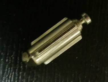

Maybe from the failing fuel pump?I went for a drive this afternoon and on the way back I stopped at a rest area to grab a coffee. The GP was running great up to that point. The carb flooded as soon as I pulled in and the trick trying to get the needle to seat didn't work. I had my other carb in the carb box in my trunk since I had not tried that carb out after I changed the main rods in it, went from 52 to 49. So I did a quick carb change and a few people were kinda mystified and a couple had no idea what a carb was. There was a young guy there with his new Mustang GT They were kinda intrigued that with some basic tools in less than 10 minutes the car fired up. The guy in the Mustang said if his car screws up all he can do is call a tow truck. The carb ran really good so that saved my day. I took the flooded carb apart and found the problem. There was a metal flake that was stuck on the needle preventing it from closing. I just had that carb apart and I don't know where that flake came from or how I missed it...
