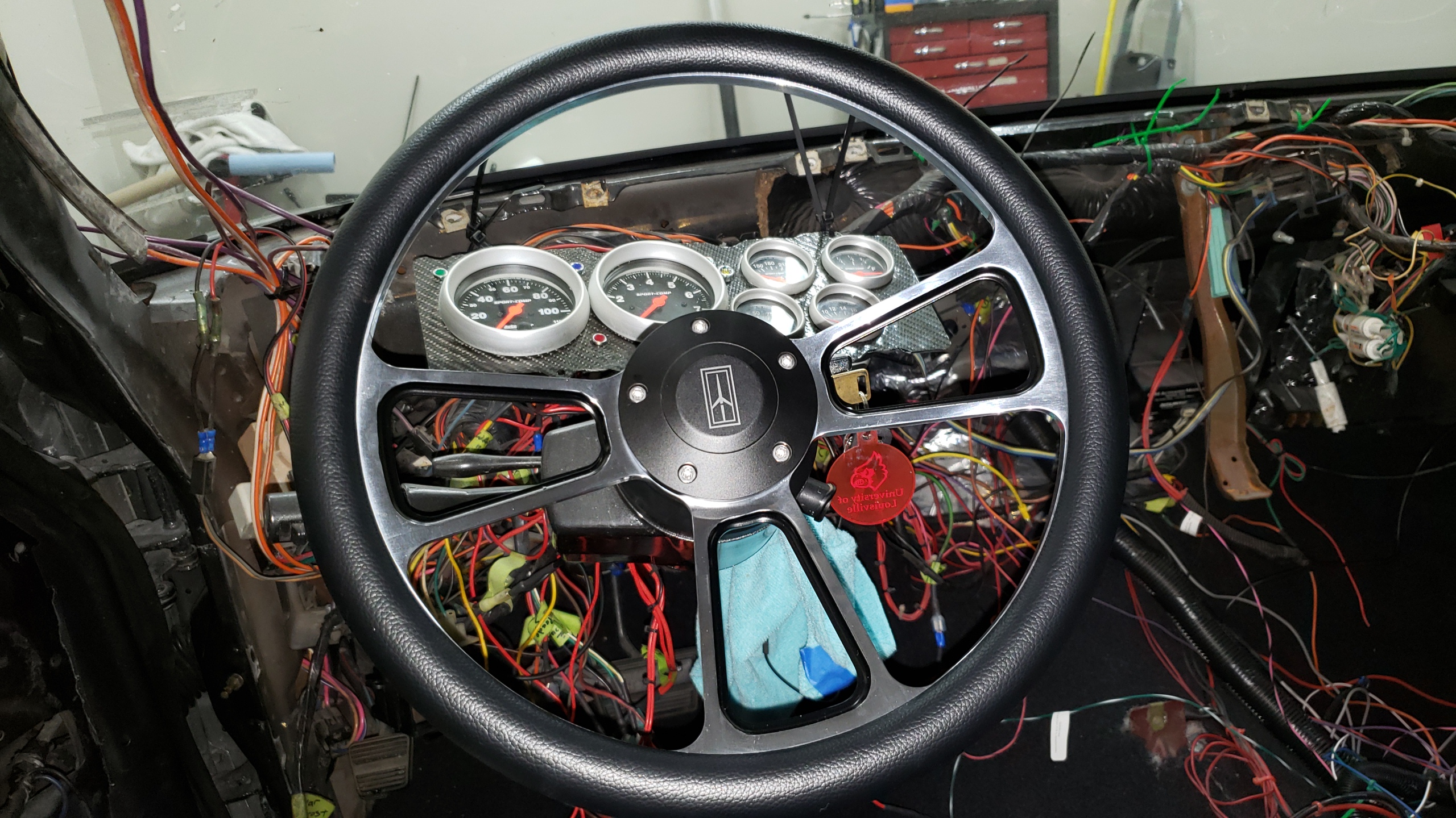

Quickly installed the newly engraved horn button onto the wheel. Looks great, just need to prep and paint the dash so y'all will leave me alone about the wires lol.
