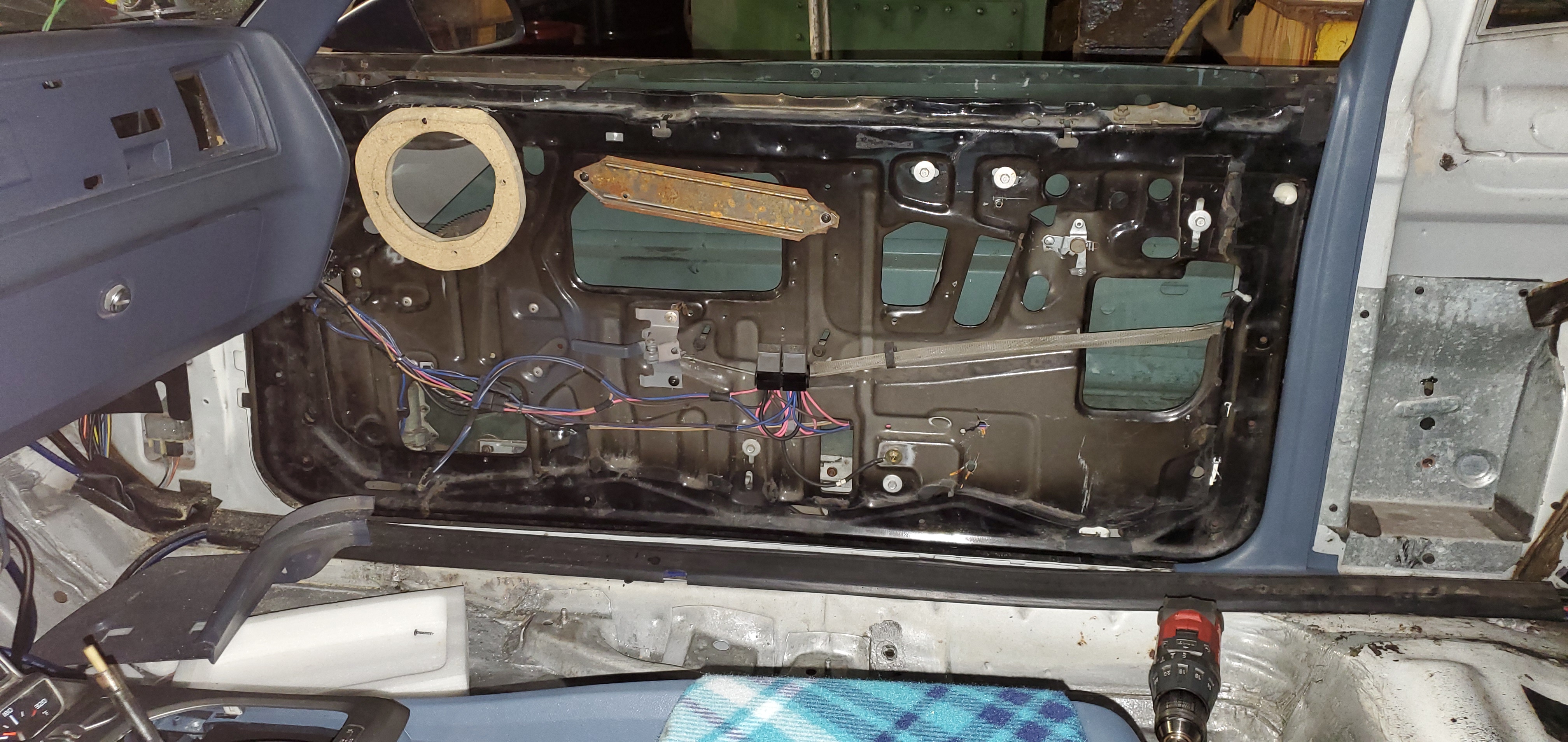

Got some more done tonight, got the passenger glass back in. Then fabbed and covered these to fit into the door panel to replace the dark carpet that wouldn't match my new one anyways

Didn't feel like much progress yesterday since I had to remake the bottom spacer since it was too thin and split, now trying to fight the thickness of this one and getting the door panel to fit alright.

Clean up the split and reinforce with some thin sheet metal around the circumference held on by tiny screws?
Thanks, I already made bigger rings. Was gonna make it easier to mount the speaker and other spacer to be bigger anyways
