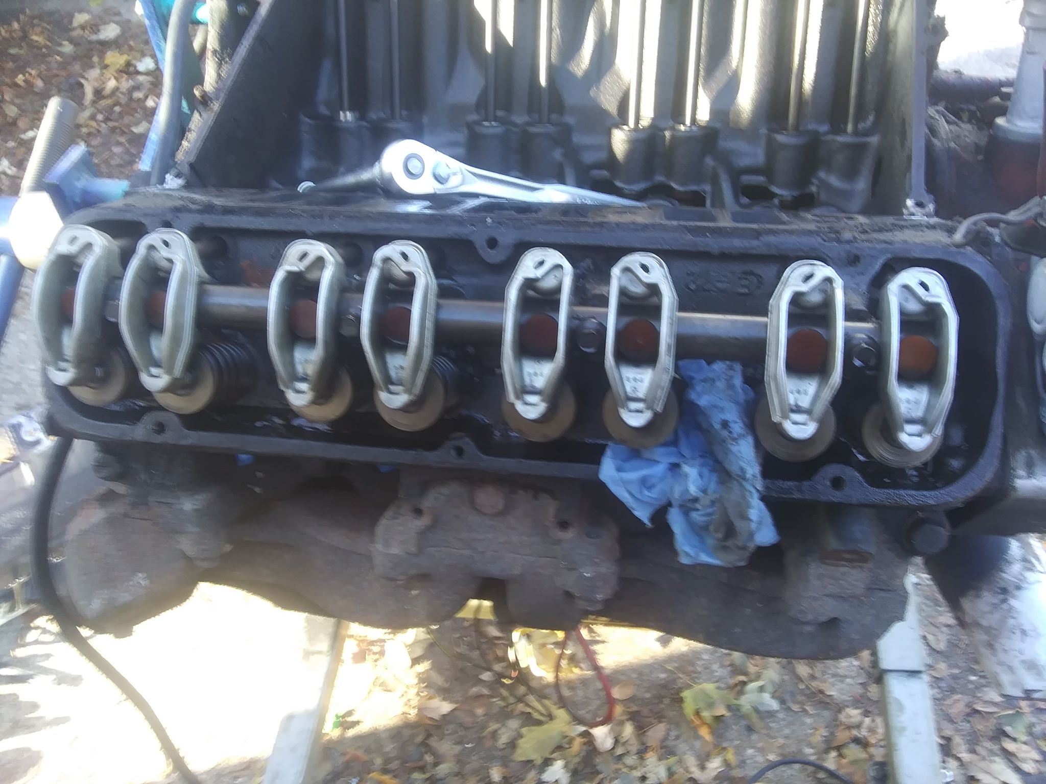

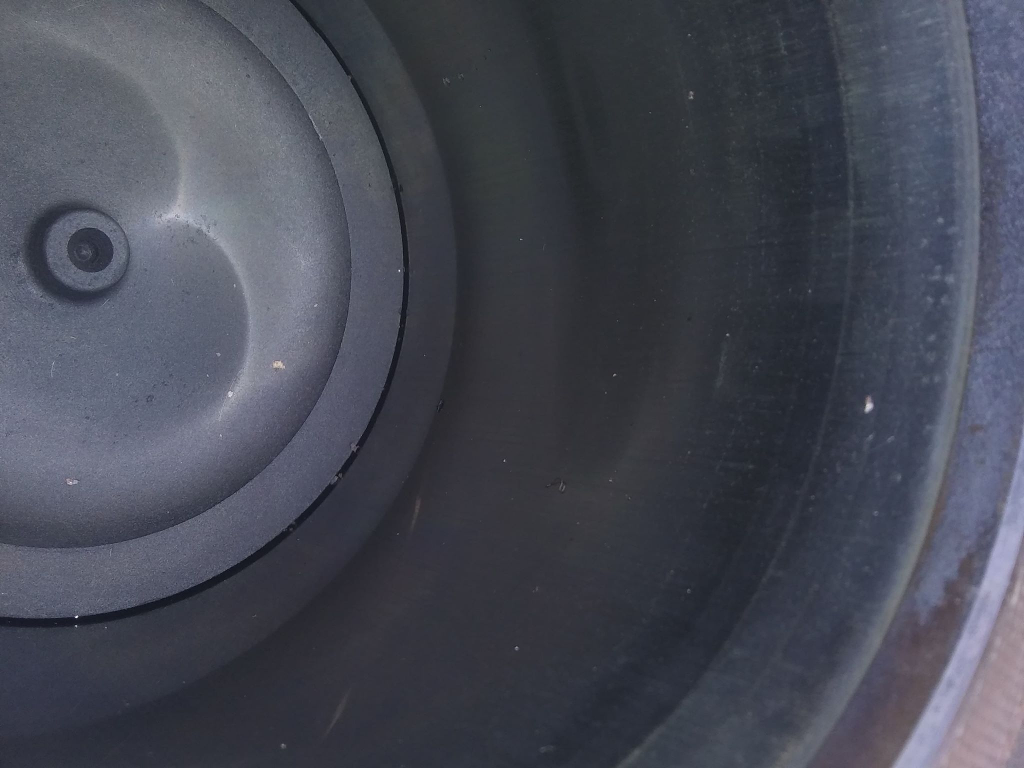

Got around to taking my new 350 down to a short block to look it over.
Good news:
It's good! Really good. I think it does actually have 63,000 miles on it.
View attachment 128810View attachment 128811View attachment 128812
The not good news:
It needs the crank polished. I can feel the gouges with my fingernail. Luckily, that crank I dropped off at midstate apparently came from a '71 350, so it's already weighted to the earlier (lighter) stud/nut rods, so I may be able to use it and just use the crank from this motor in my other other motor. Confused? yes.
So, that's where I'm at right now.
It doens't look like there is any sludge built up but was there any internal coolant leak?....that could explain the crank bearings issue

Not that I can see or tell. It had oil in it from the last time it ran. Dark brown.
