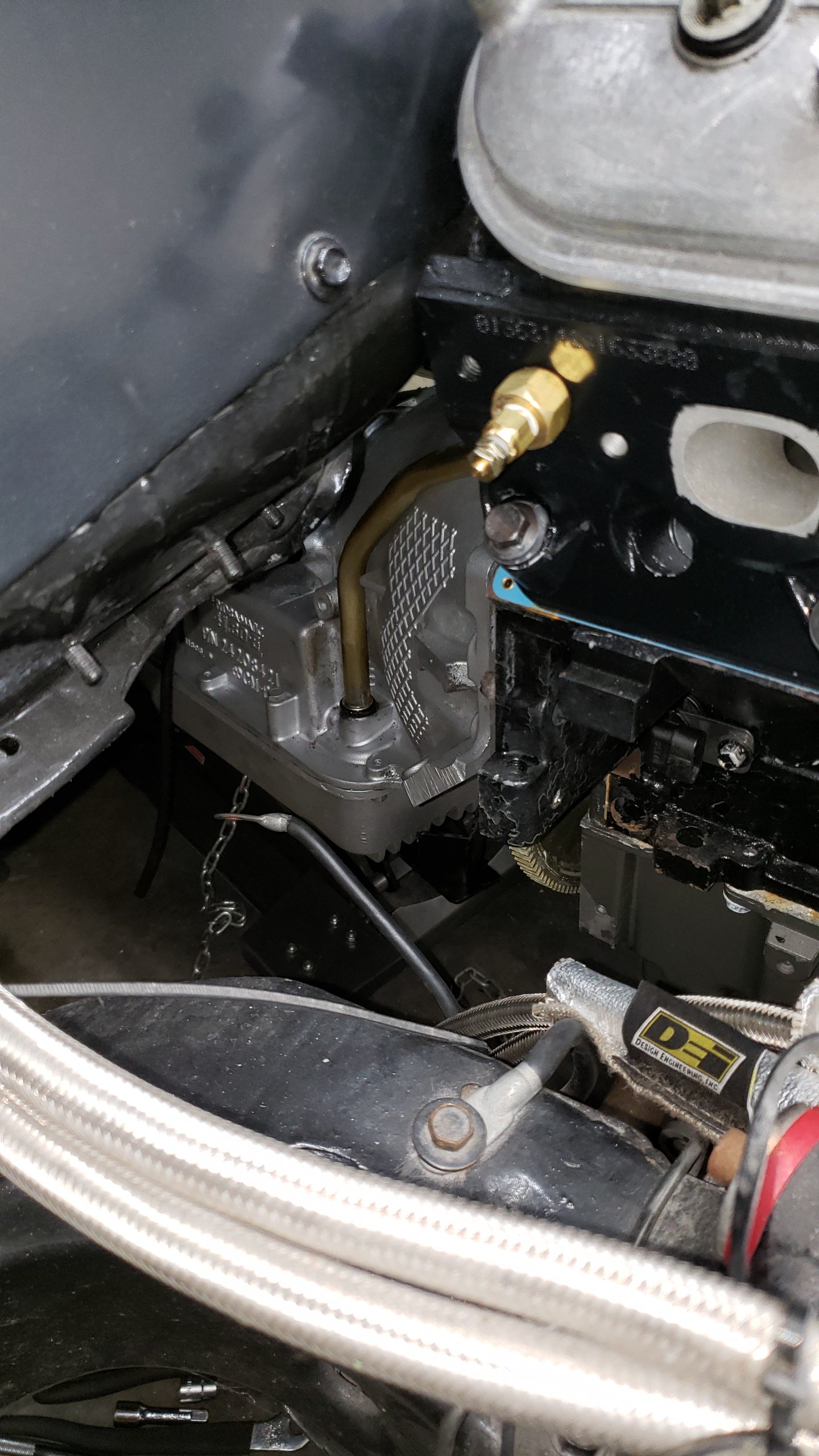

Well, I F'n fought with the trans dipstick and managed to get it installed and bolted up, but IT WILL NOT CLEAR THE FIREWALL/PASS CYLINDER HEAD!!!! I think this is due to the 1" setback plates. Sooooo, now I get to spend more money on a flexible dipstick(any recommendations), and touch up the firewall where this one scratched the sh*t out of the paint! I had to throw in the towel at 2am, so the trans and engine are just hanging out right now. View attachment 111928
I've used several Lokar lipsticks and they work well for the flexible part...but it's hard to tell if they're accurate or not. I need another throttle cable which has to be a Lokar, but it hurts that a damn dipstick is $100!!!!! The markup has to be ridiculous.....on Ebay one can get a TH350, 400 flexible knockoff brand for $30. Punch in 4l80e and they start around $70ish and supposedly aren't interchangeable with TH400 units.Well, Lokar pretty much has the market cornered on the aftermarket "flexible" products for shift cables, engine and trans dipsticks, throttle linkages and old school looking shifters. And JEGS offers this universal one for multiple applications.
https://www.jegs.com/p/Lokar/Lokar-...inless-Transmission-Dipsticks/749848/10002/-1
However, I've never actually used their products. The ONLY experience I have personally with their products was the flexible engine oil dipstick that came on my wagon. And the previous owner must have NEVER checked the oil. Because once I pulled it out of the tube to check the level, nothing.... and I mean N O T H I N G... I did would allow it to go back in. It was hanging up on something. I even filed down the dipstick itself and still no go.
I ended up filing it further, right in the "chitcan" and bought a universal aftermarket solid tube.
At least it's chrome.
As they say, your mileage may vary.

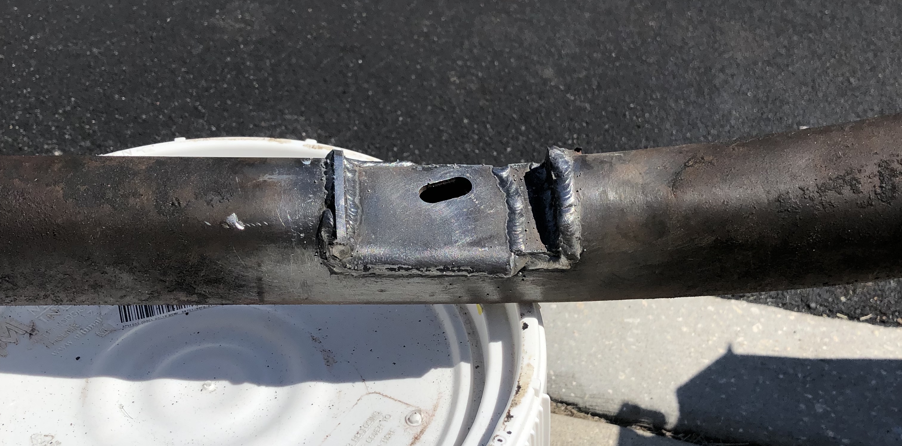

Not the prettiest, but should hold the TH400:
