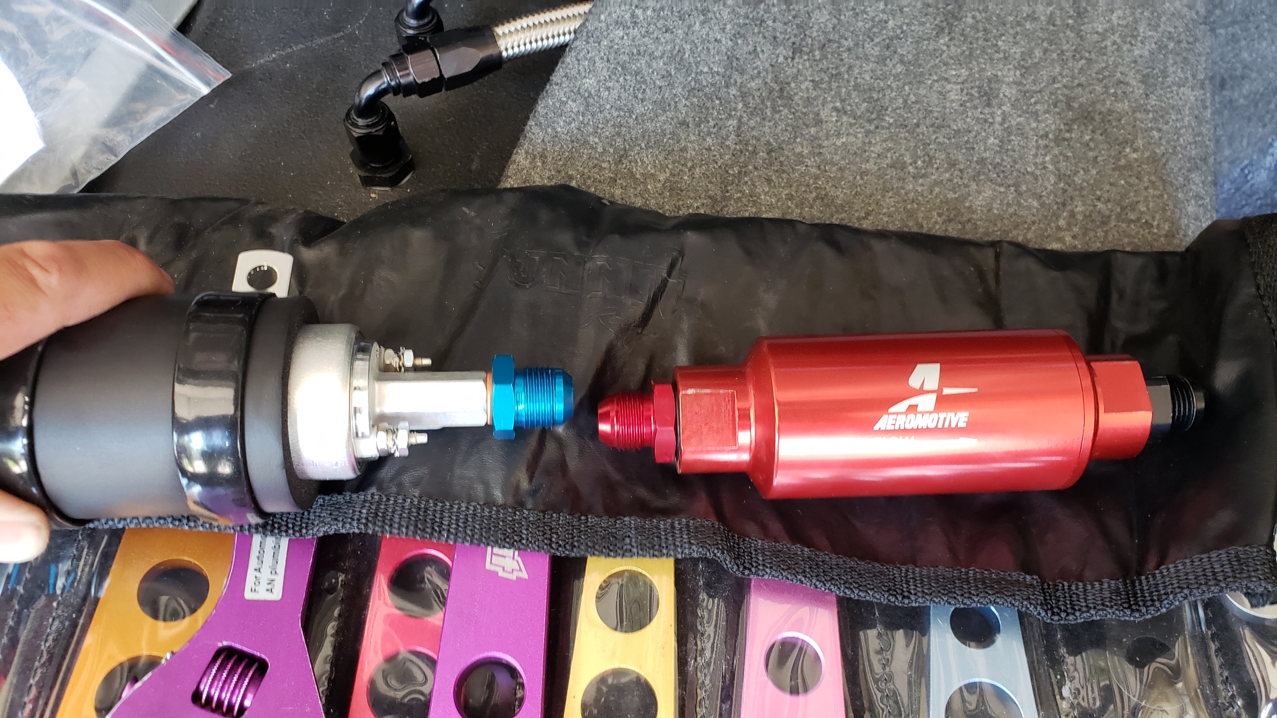

Looks we're both tackling fuel pump conundrums Steve. I removed the A1000 earlier, changed the 10 micron post filter, and now I'm at a standstill. I have the pre filter hooked to the pump. But I need a different adapter to go from the pump to post filter... View attachment 113862
Hmmm, I wish I would've read the Fast info. I read somewhere(don't recall the source) that a stainless prefilter from 20 to 40 micron is recommended.the instruction for the Fast Efi says that the Walboro pump that comes with the kit does not require a prefilter because the pump has a screen.

"(The pump included in the EZ-EFIâ„¢ Fuel Pump kit features a built in strainer in its inlet. So a pre-filter is not required.)"
