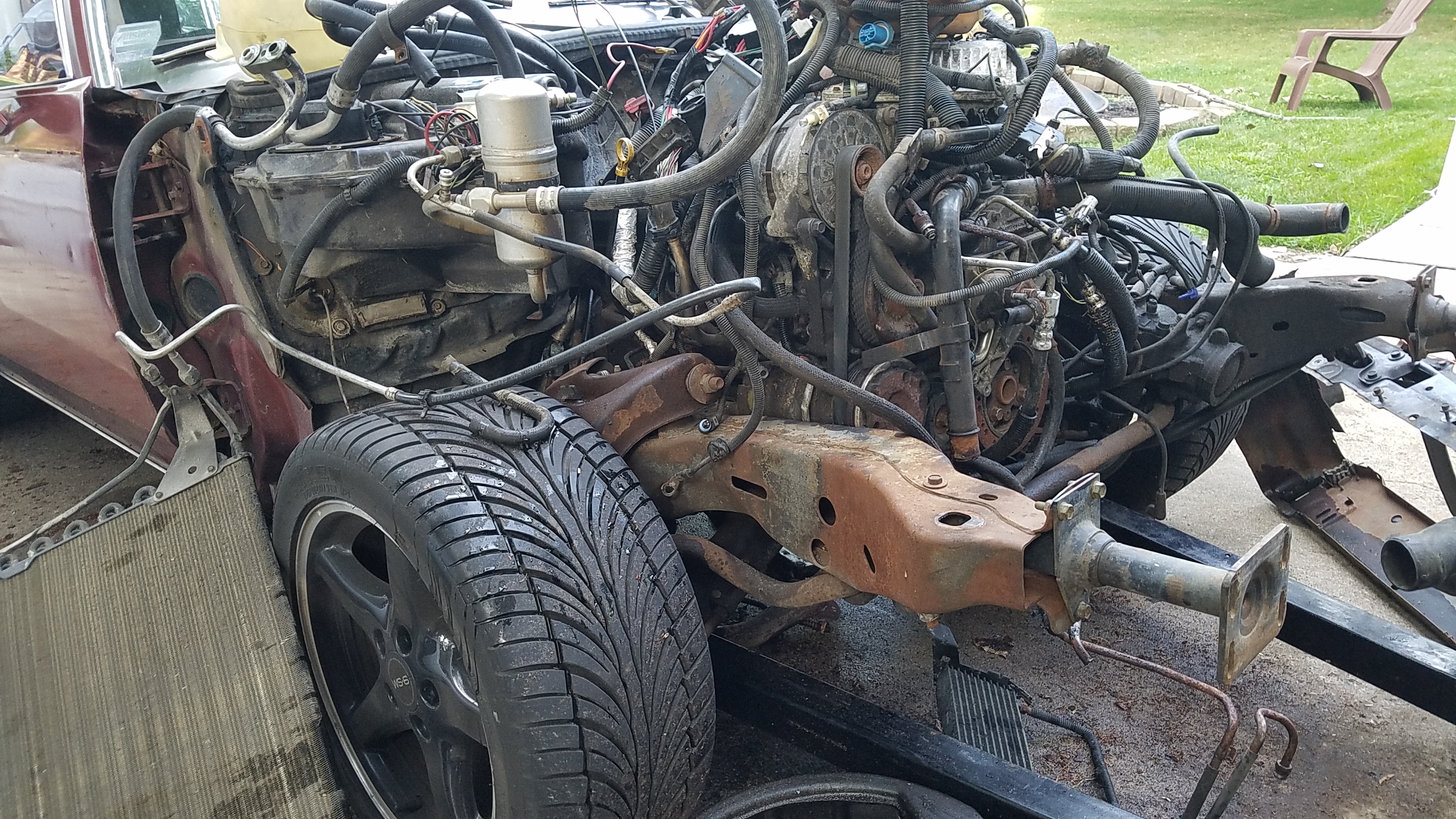

And here we at at dinner time. Front clip removed 305 and trans out. Lt1 & 4l60e dropped in place. Tomorrow I need to yank it back out and clearance the frame for the a/c clutch and swap out one motor mount on the frame. I will also be yanking the a/c box and dash to chase a water leak and run wiring for the pw/pl.

And here we at at dinner time. Front clip removed 305 and trans out. Lt1 & 4l60e dropped in place. Tomorrow I need to yank it back out and clearance the frame for the a/c clutch and swap out one motor mount on the frame. I will also be yanking the a/c box and dash to chase a water leak and run wiring for the pw/pl.View attachment 155964View attachment 155965
I thought this only happened on T.V.
