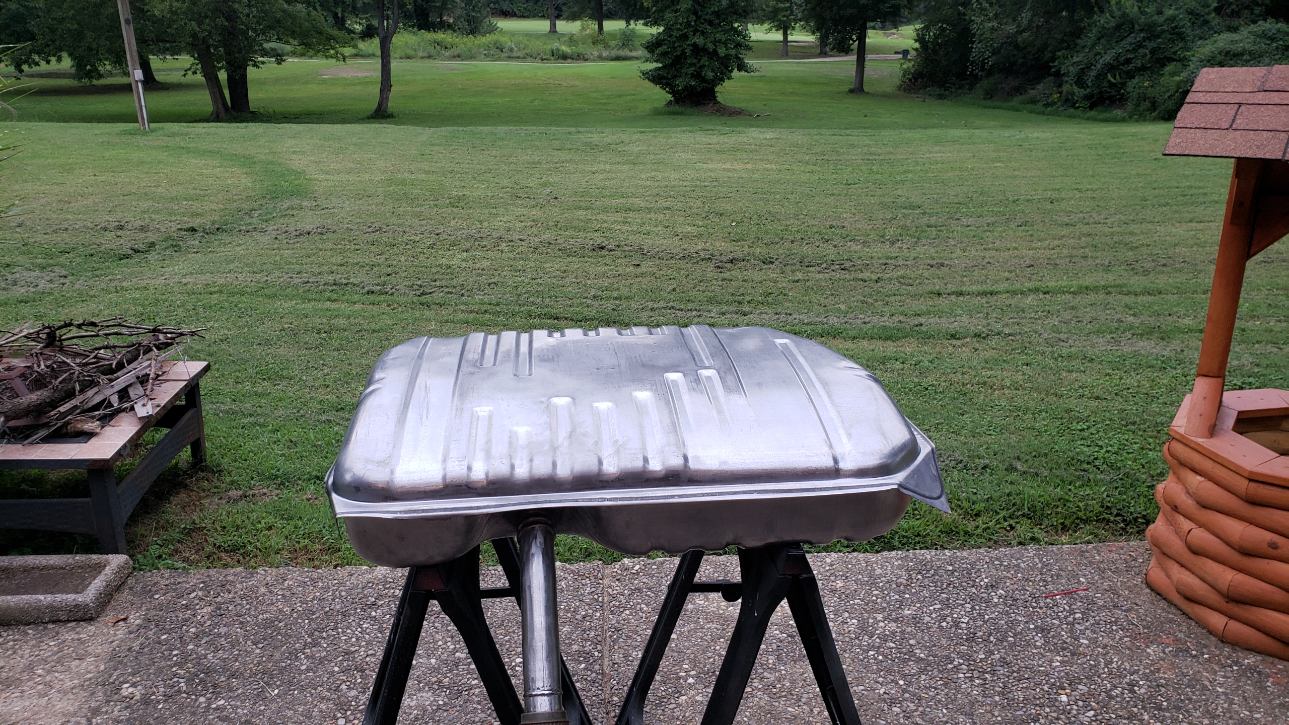

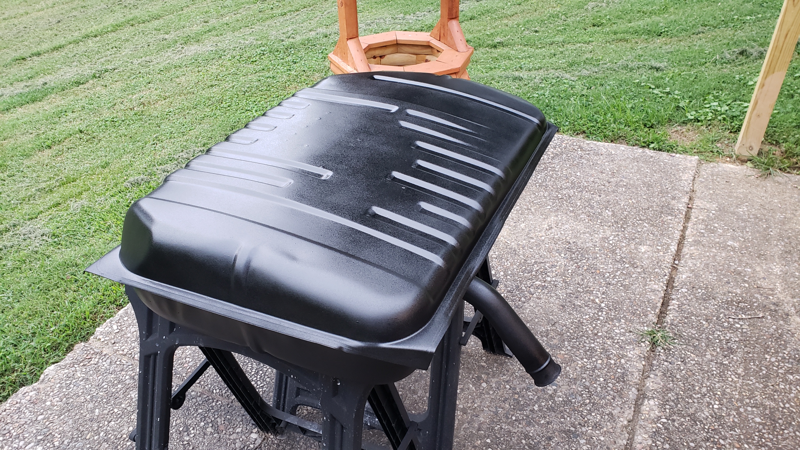

Took the GN tank outside, wiped it down real good, then hit it with some undercoating, basecoat black and semi gloss 1k clear. Should match the rest of the underside once installed, and be protected from rust.

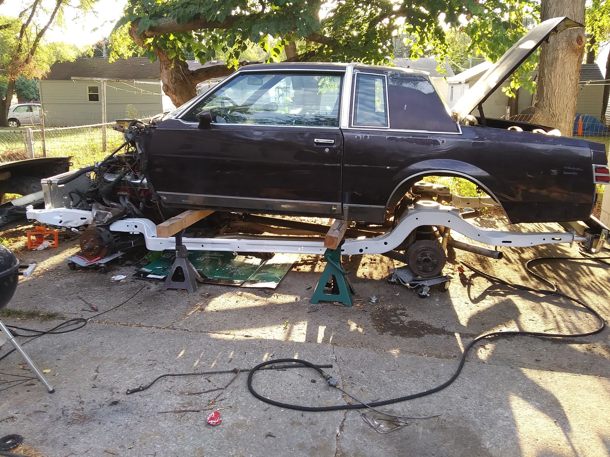

Spent the day grinding welds on the frame. Had to make 2 more very small patches, but the welding is done and I’m about 75% done grinding on the drivers side rail, and about 60% on the passenger side. Should finish it up in my next work session. Then I can paint it and reinstall the gas tank and make it run again. Pictures after the next round.
Primed the front parts of the frame, once again only really the areas I can't get to with the body on the frame. I'll do the firewall soon enough, once I get my damn gasket kit for the ac box.
It does lay out pretty well, even brushing it on. It does leave some streaks and brush marks if you're not careful/are lazy, but it's a frame. It'll be fine. Especially when the satin black goes on.
I did not prime areas like the engine crossmember, behind control arms, etc because those can and will be accessed later on. This engine will come out in the future, as will the front/rear suspension, those areas have been fine for 35 years. they'll be fine a bit longer.
